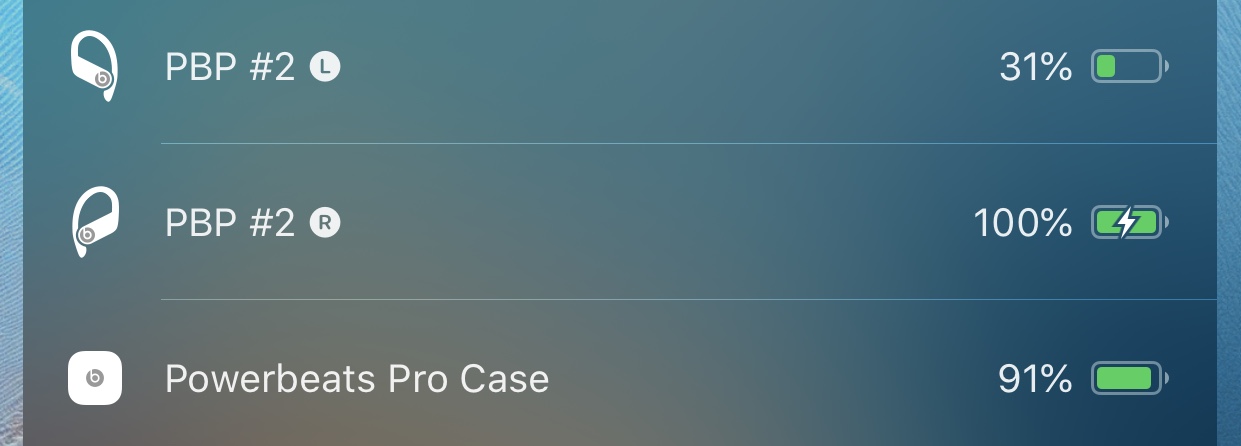

And then I hopped on my bike and this is what I saw when I tried to use them:
