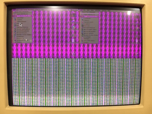

Today i received a new (for me) Radeon 7000 PCI. Before replace the old ATI Rage i installed Radeon drivers for Mac Os 9.2.
I replace cards and i have this issue:
I need another driver?

I'm guessing it's a flashed card, as they seem to sometimes not work so well on classic OS's. You're using the right driver though. Do you have an OS X install you can test the card with? You won't need drivers on OS X.
I tried the card with Mac Os X 10.4 and it works ok.

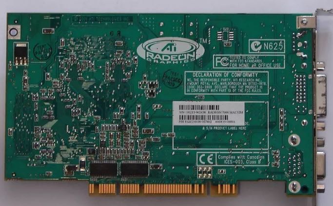

Can you please post a photo of the card? That would really help with solving your issue, because that would tell me if it's a Mac edition, or a flashed Wintel card.
Yes of course! Thank you very much.
I think it's a Mac Edition. Tomorrow i can make another test, because the G3 is into my parent's home.

I used a flashed 7000 for a little while in my B&W. I can't remember if it worked in 9 or not... I mainly had Tiger on it before I decked the whole thing out.
I would stat by simply disabling (unchecking) the driver. If that produces the same result I would delete the driver outright.
I have already booted with extensions disabled and the problem remains
I disabled the ATI extensions and, after Mac 'Starting up' screen, the monitor turns off. I also tried with a clean installation of 9.2.1 and i have the same result.
I installed the Ati driver (November 2001) on the partition of the clean Mac Os 9.2.
Then I restarted and after the startup screen the monitor (VGA CRT) turned off.
I tried out of curiosity to connect a DVI monitor and the screen appears. The resolution is set to full-hd (1920x1080).
So I set it to 640x480 and without extended desktop and VGA monitor turns on ok.
Unfortunately, when i restart, everything returns as before.
