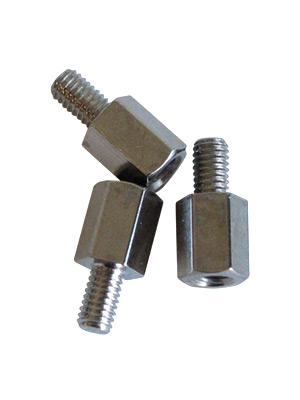

Measure up the holes, ie., (i've done this for a custom case) sit the MB where it's supposed to go or intended to go. Mark the holes then move the MB out of the way. If no existing holes come close you might have to drill some small holes and insert MB screws. Similar to these:
then your MB will screw into those. Only thing to keep an eye on is correct height, and if it lines up to the card slots.

Great suggestion, where could i get some of these puppies?
If you lived near me I can give you like 1,234,343 of them LOL.
You can usually find them in probably any MicroCenter in the pc parts section, not sure if radio shack has them (doubt it) maybe a local joe computer shop might spare a few (you'll only need like 4-8 of em) or maybe sell you a few.
Otherwise you can buy em online at pc parts stores.
I've even seen them come WITH new motherboards but most cases they come with store bought computer cases.

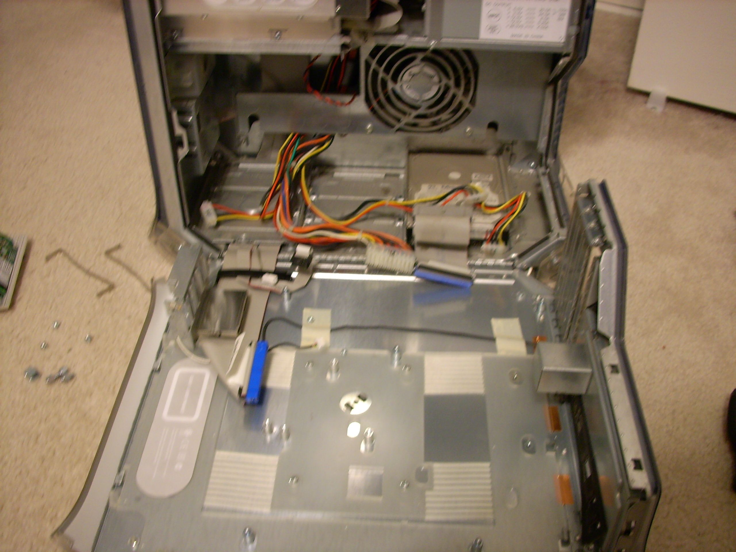

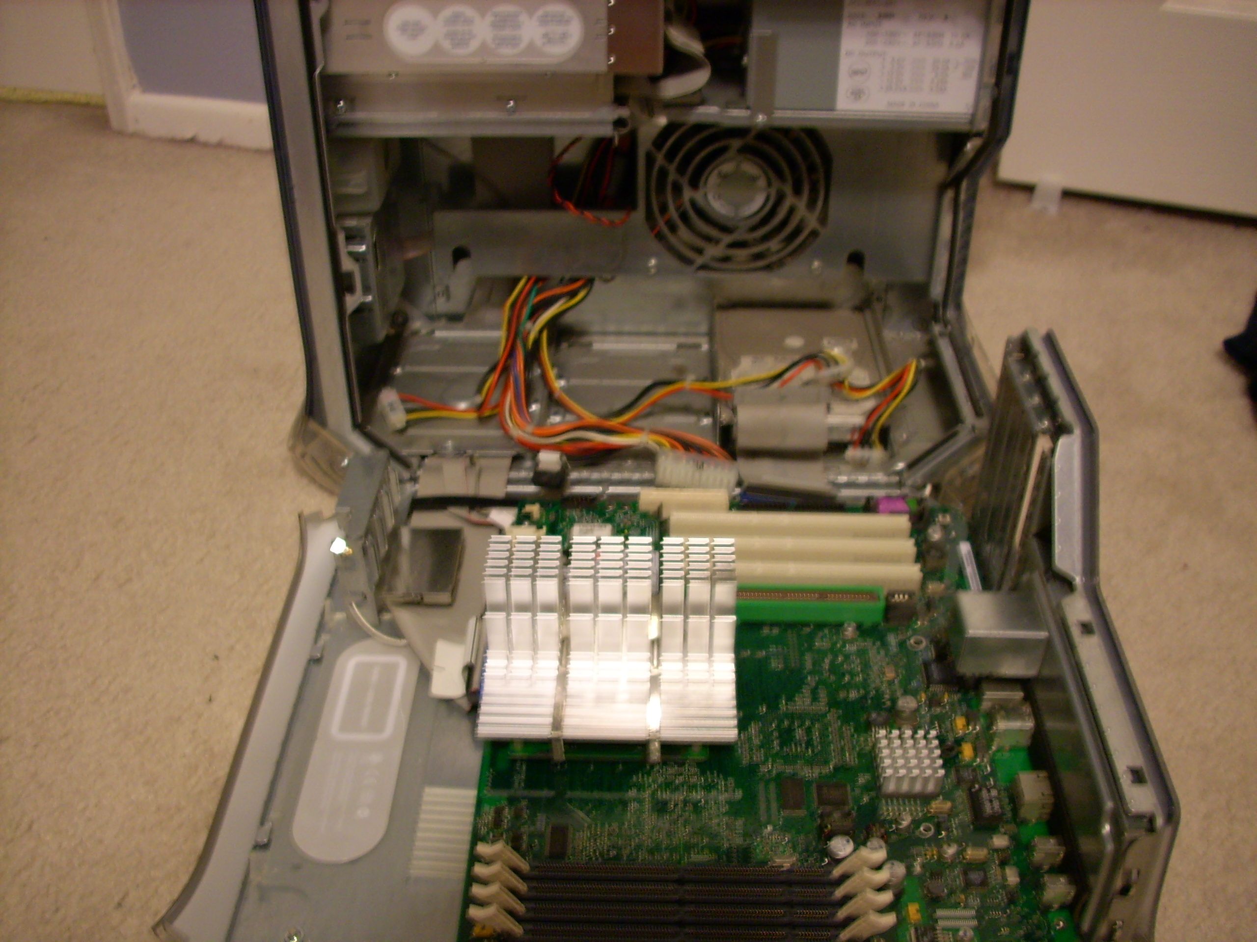

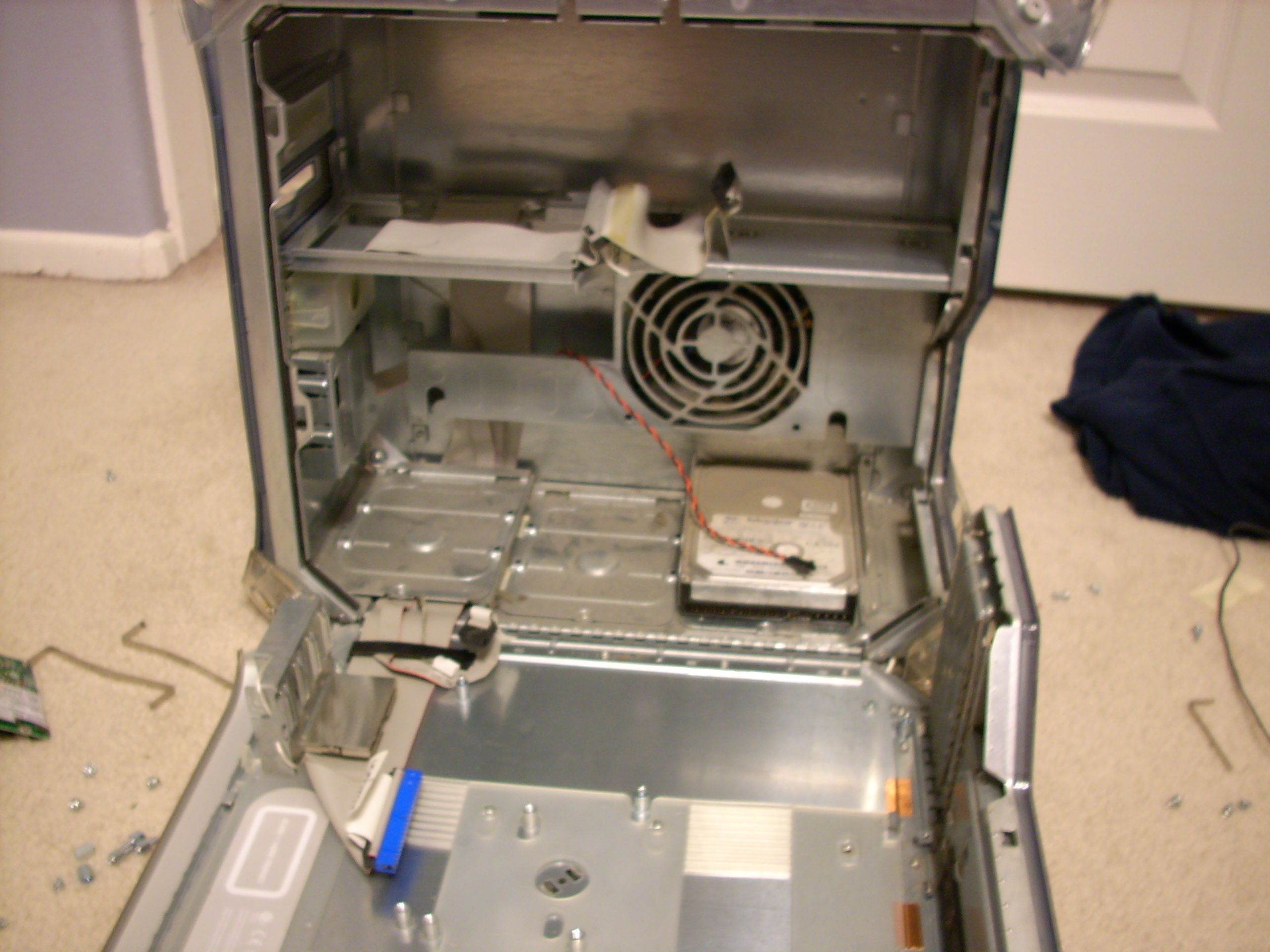

I figured I should post an update on what I've done so far:
