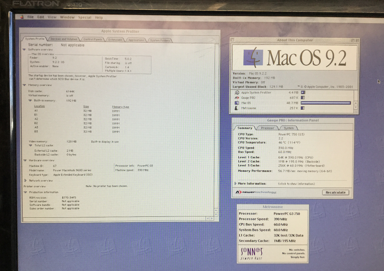

ahh 🙂 thats where i got the manual/dip switch for my slocket from
the software on that image appears to be for G3 stuff only tho
and if I wish to really tweak all the settings and change the L2CR on the fly then I have PowerLogixs CPU Director 🙂 (its companion extension shows as loading fine however Mac OS 9.2.2 still freezes at desktop load, but you dont need that extension to use CPU Director so i can run the sonnet extension to boot the system then use CPU director if i wanna get real technical/fine tune things)
Just double checking this as it has been a while; with the Machspeed carrier, the cache is enabled via the dip switches. My understanding is that the extension is a maths library of sorts and the control panel just checks to see if the cache has been switched on/present. Prolly doesn't matter either way whether you install anything or not on a Kansas board.
on my slocket the first 8 Dip switches are to do with setting the bus speed and then the last 4 are for setting the CPU Multiplier, theres nothing on my slocket AFAIK for handling L2 cache
I know for sure the sonnet extension is enabling L2, as without it when ya fire up Metronome or Gauge pro theres no backside L2 to be found (on both G3 and G4 CPUs)
and of course for OS X if I want to enable L2 cache sonnet has a kext for that too 🙂 (for those wondering the OS X cache enabler in xpostfacto does not function properly in 10.3+)

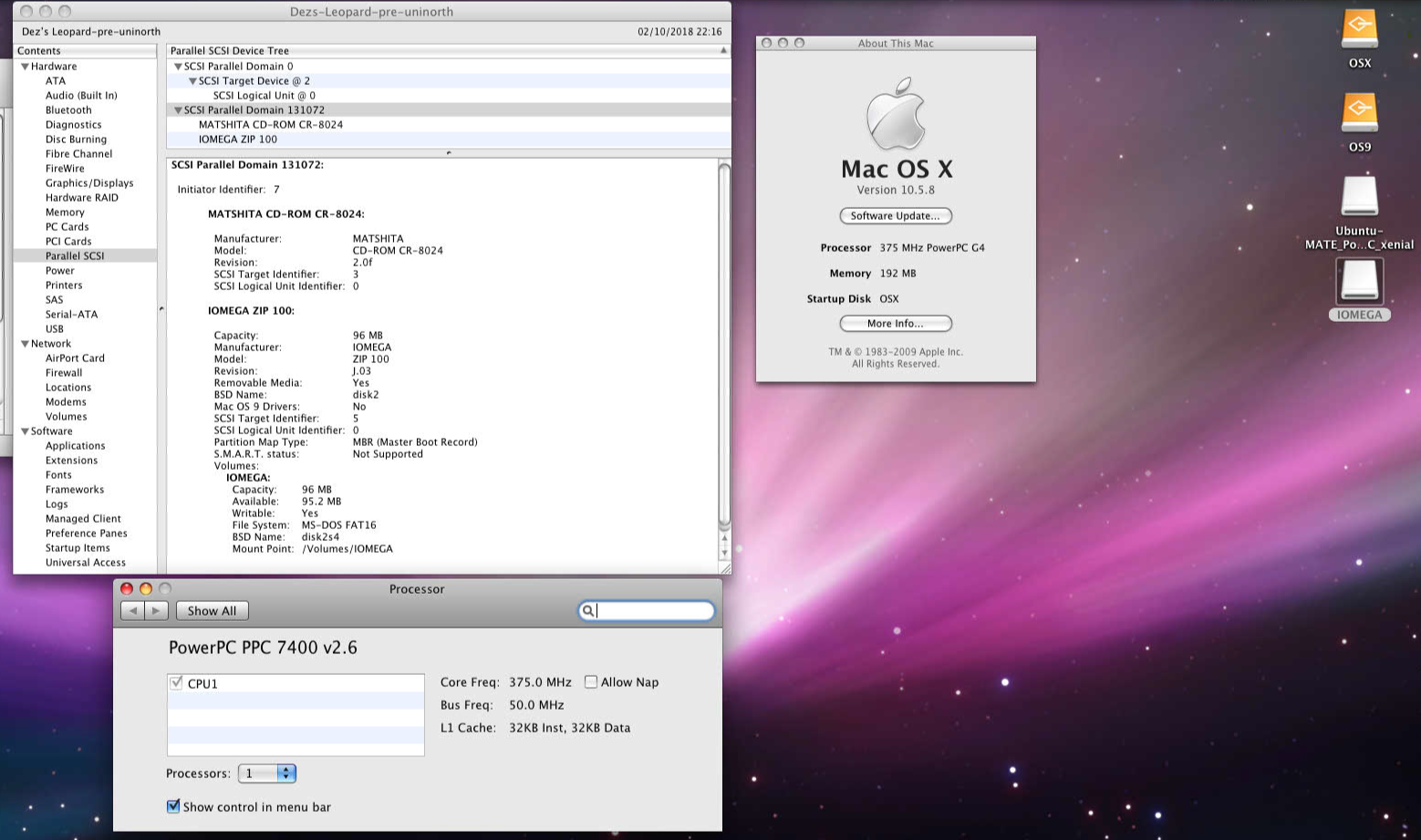

been playing with the 9600 some more
and much to my pleasant surprise the system seems to be stable even with the bus speed set to 60Mhz, (normally PowerSurge based macs max out at about 55Mhz bus speed) and I got nice little boost in memory performance, with the G3 at 50Mhz bus speed it was in the low mid 40s 🙂 . (it will be interesting to see if my sonnet G4 ZIF maintains a 9x multiplier at 60Mhz bus. as that would have it running at 540Mhz) I wonder if I could hit 66Mhz on the bus, but I need to figure out the dip switch settings for that, as the PDF only goes up to 60Mhz
and much to my pleasant surprise the system seems to be stable even with the bus speed set to 60Mhz, (normally PowerSurge based macs max out at about 55Mhz bus speed) and I got nice little boost in memory performance with the G3 at 50Mhz bus, it was in the low mid 40s 🙂 . (it will be interesting to see if my sonnet G4 ZIF maintains a 9x multiplier at 60Mhz bus. as that would have it running at 540Mhz) I wonder if I could hit 66Mhz on the bus, but I need to figure out the dip switch settings for that, as the PDF only goes up to 60Mhz

small update on the 9600
looks like the 60Mhz bus setup is only stable with a G3 CPU if I stick in my G4 Yikes! CPU it all falls over LOL
so I think ill stick to a 50Mhz bus speed for the most part.

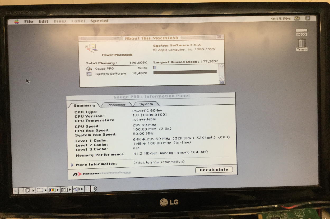

small update time again 🙂
after figuring out how to read write to HFS Normal volumes in macOS Mojave via some slight sheep shaver hacking
I got System 7.5.3 going on my Kansas PowerMac 9600 a system which is said to require 7.6.1 🙂 now if only I had a 1Ghz Sonnet G4 to put in this system so I could really see System 7.5.3 go off its tits 😀
this is still hanging off of the CF card attached to the PCI ATA133 card too,
but on that note I recently won "some" SCSI HDDs on ebay and a 50 to 68 pin adapter, so I hope to be able to install a SCSI HDD into this system and play with getting OS X Server 1.2v3 and BeOS going on it 🙂
its also fun to think, that, the machine above is running the same OS as this machine bellow 🙂 8Mhz 68000 vs 300Mhz 604ev....
