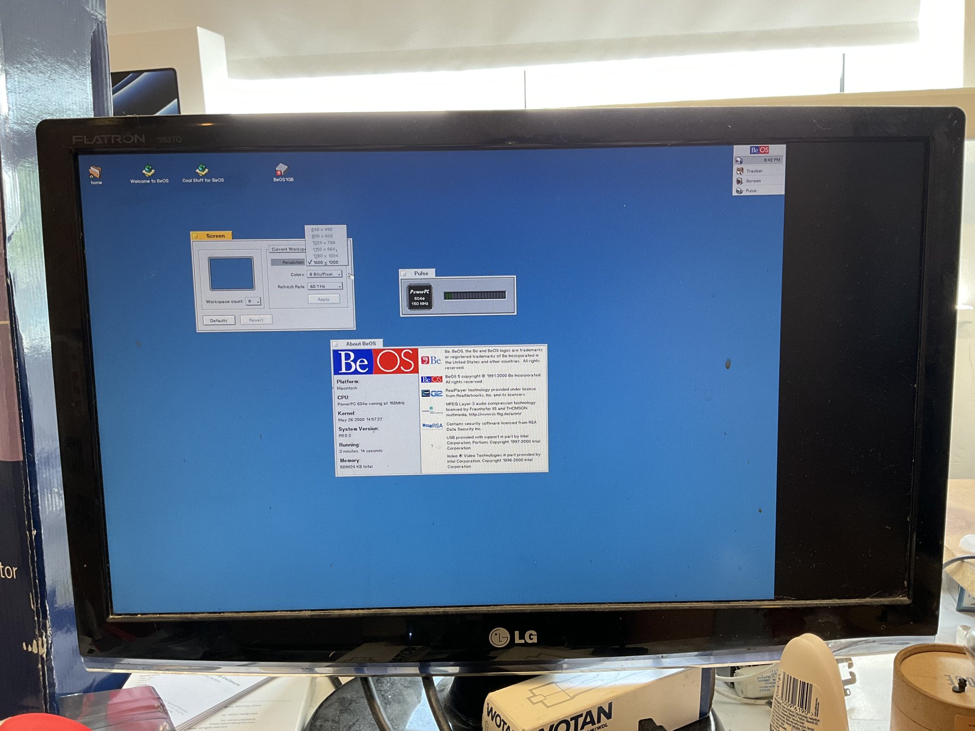

speaking of BeOS tho, I did a bit of experimentation with it regarding Video cards, System 7 at 1920x1080 never gets old 🙂
BeOS will actually boot with a Radeon 9200, just riding the pre-existing Frame-buffer, buts still neat to see it does actually have a generic mode like that, however as one can see in the picture it seems to artificially limit itself to 1600x1200, I cant change any of the modes and theres lots of tearing as you would expect so it does seem to be in a generic mode but its still curious how it refuses to use all of the Frame buffer
Reactions: Amethyst1
