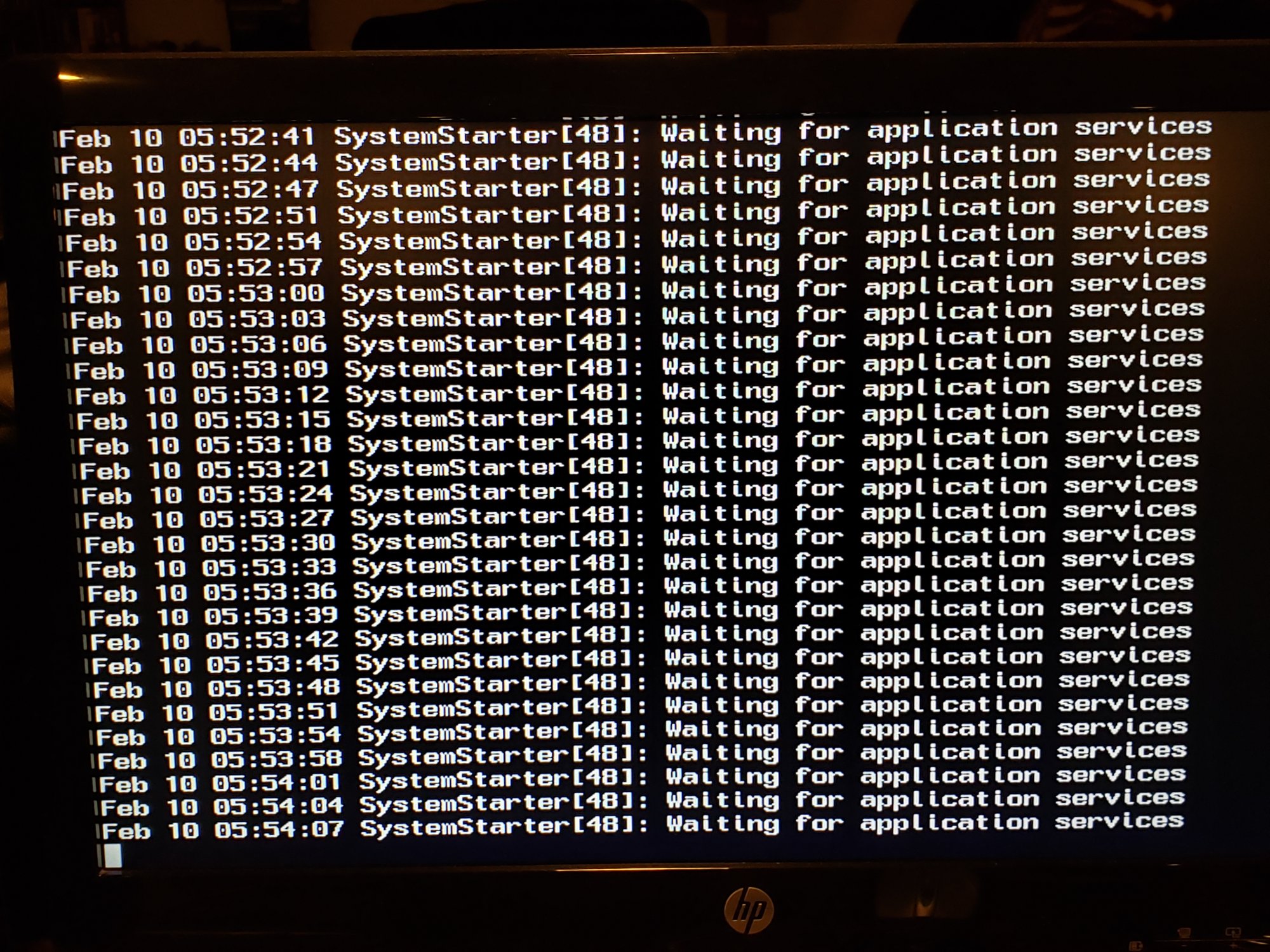

So here's a snapshot of what I see after I installed the Sonnet cache enabler. When you install it, it requires a reboot. So I rebooted and the first thing I saw on top of screen was something about Sonnet, then screen paginated rapidly to this point you see here and then it stopped.

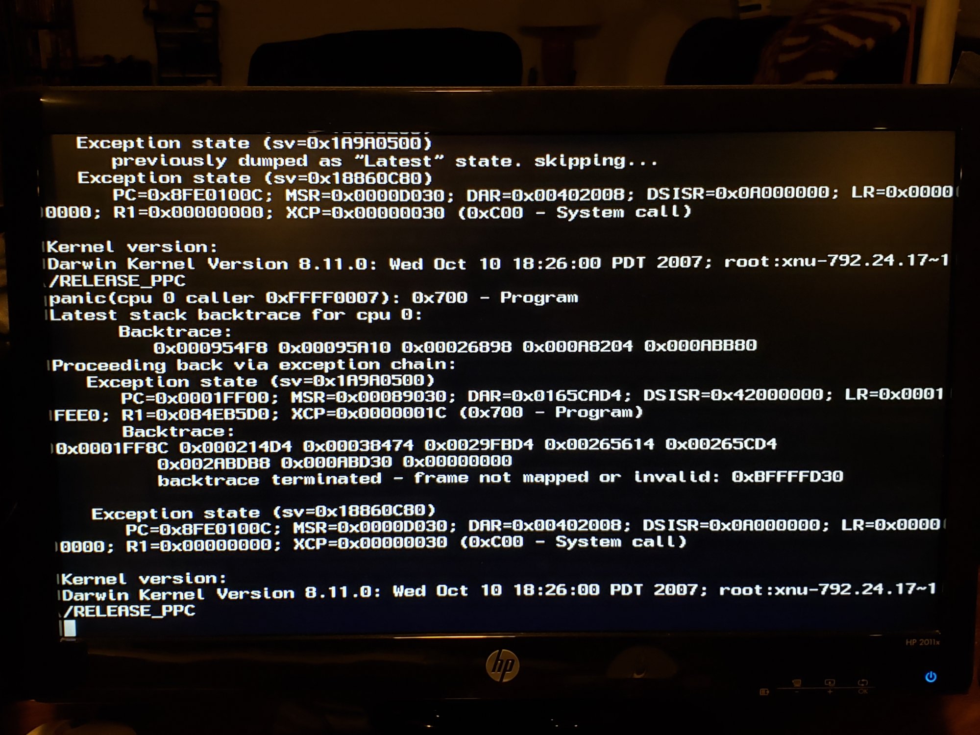

Then after I removed the Sonnet kext (per their direction if the above happened), I had to do a hard shutdown, rebooted to OS 9.1, started xpostfacto and then got to this point:
I then had to hard shutdown and boot back into OS 9.1 and finally booted back into 10.4.11 successfully.
Aside from trying the powerlogix app, which apparently can't be found anywhere, I guess I need to go the CHUD route? I know absolutely nothing about CHUD.
