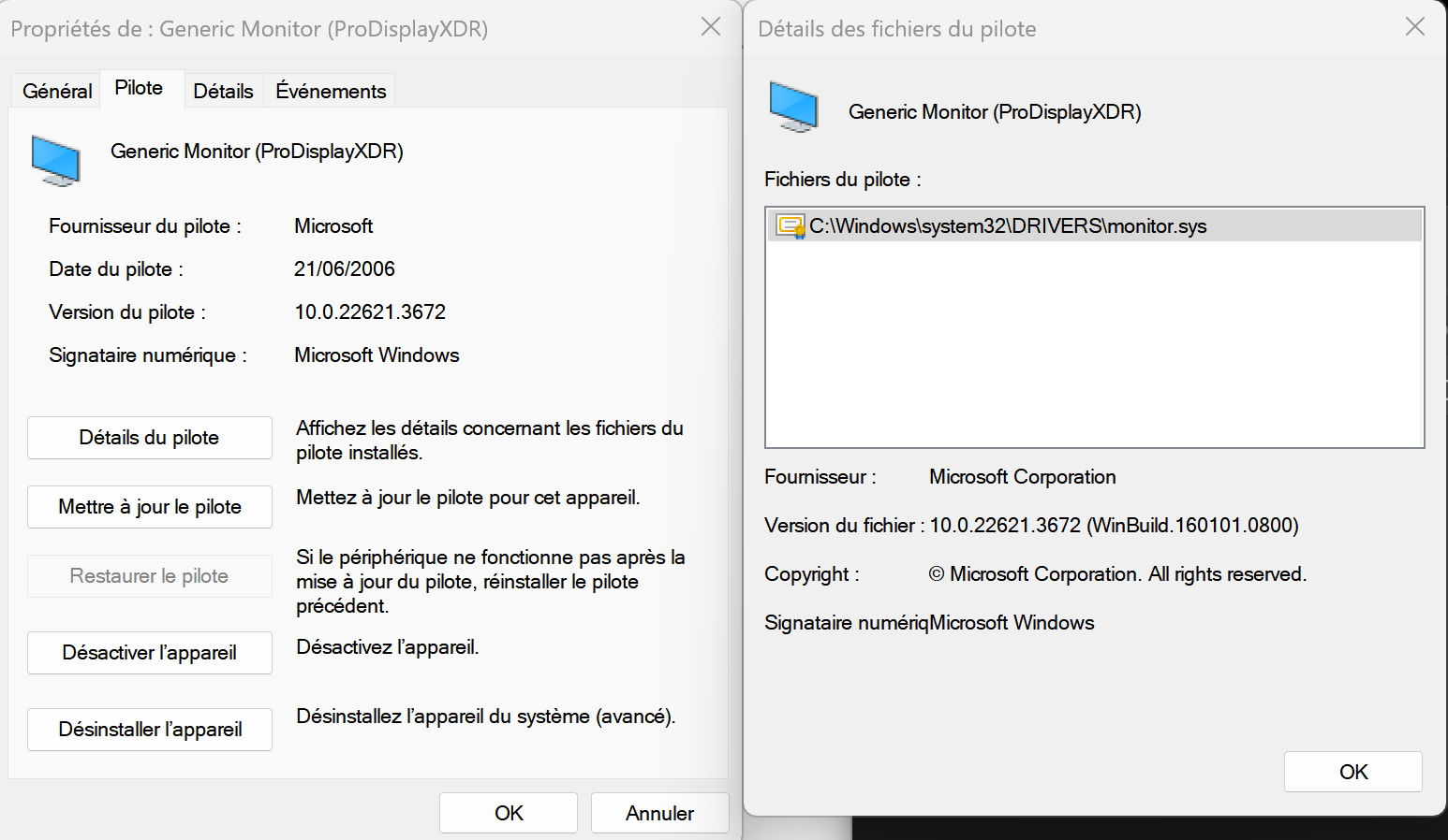

My problem is that the driver associated with my display is the old Microsoft "Generic Monitor" driver.

As for the display driver, if I've understood you correctly, it's normal for it to still be the generic Microsoft driver?
Yep.
