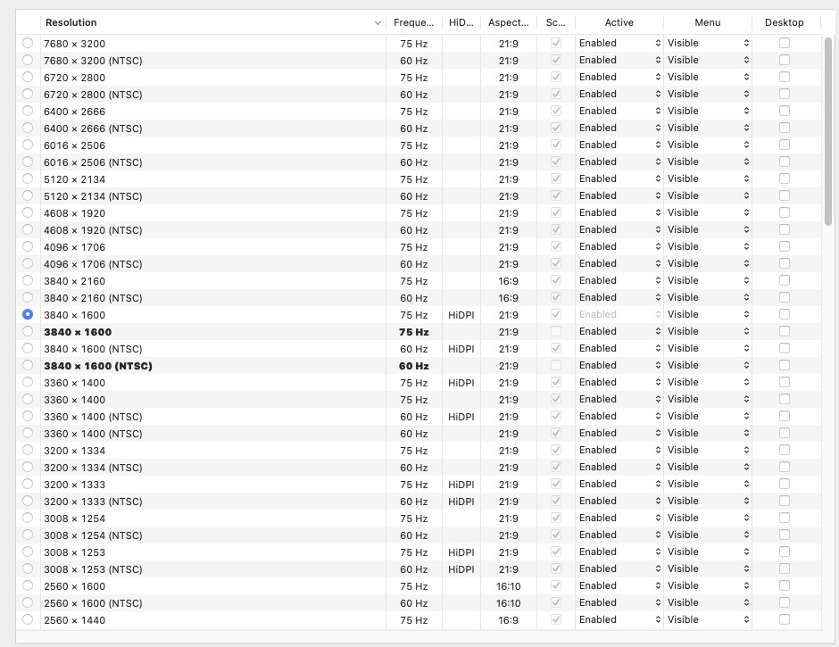

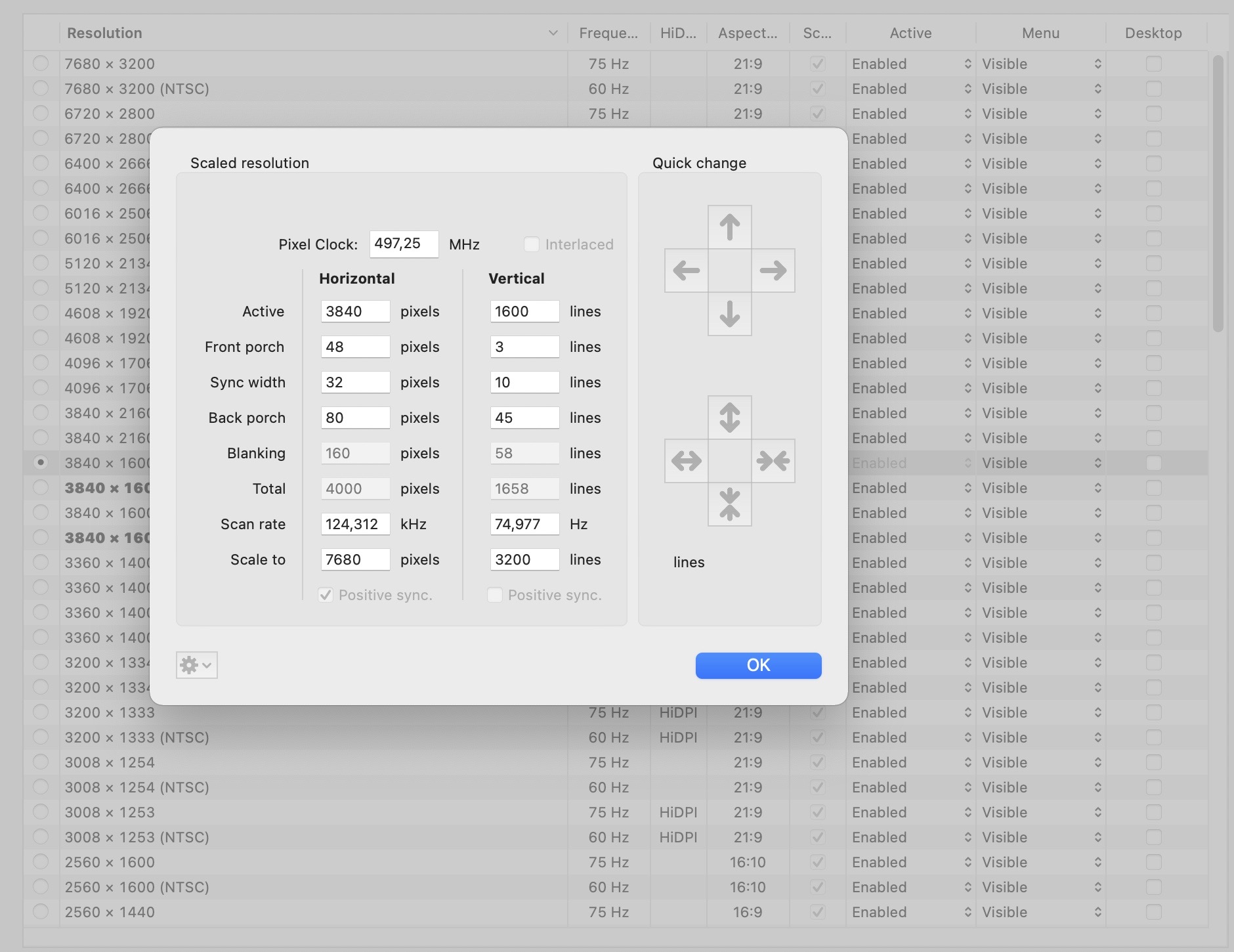

Can you install SwitchResX on there and double-click on the selected mode on the “Available Resolutions” tab so we can compare this to the mode used on the MBP?
Sure, here we go.

So you're saying that 7680x3200 scaled down to 3840x1600 (HiDPI) looks better on the Mac Pro 2013 than it does on the MacBook Pro 14?
Did you try the exact same timing on the MacBook Pro 14: 497 MHz pixel clock 75Hz refresh?
The LG 38WN95C-W is not a HiDPI display.
Basically, it's just a wider Apple 30" Cinema Display (from 2005) which I'm using now with my Mac Pro 2008.
Just use the non-HiDPI mode 3840x1600.

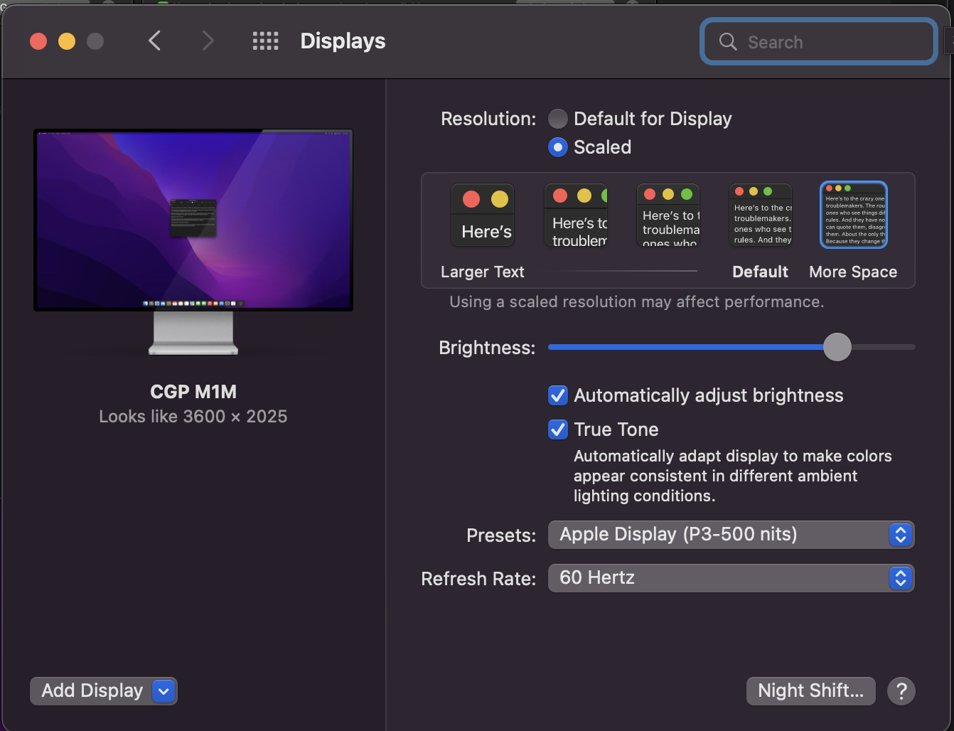

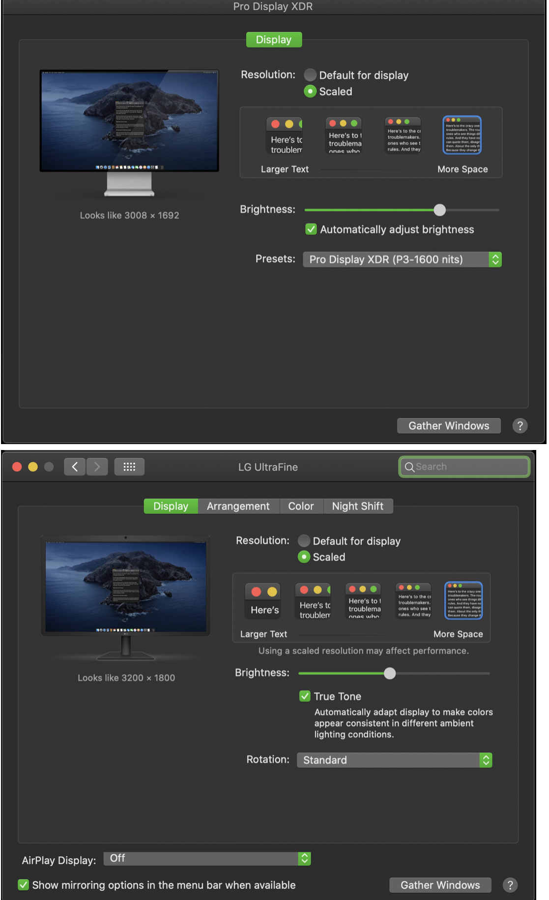

No I think it used to just top out at 3008. This is how the interface used to be…even lower than the 5K LG Ultra Fine.

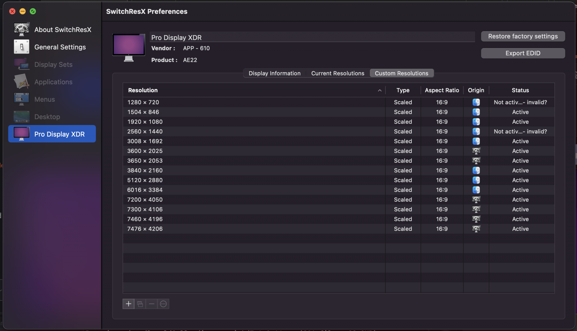

Hmm then maybe my custom entires into SwitchResX are triggering the More Space option to appear? Here are my entries:
