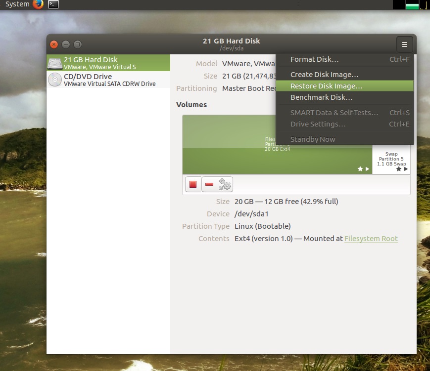

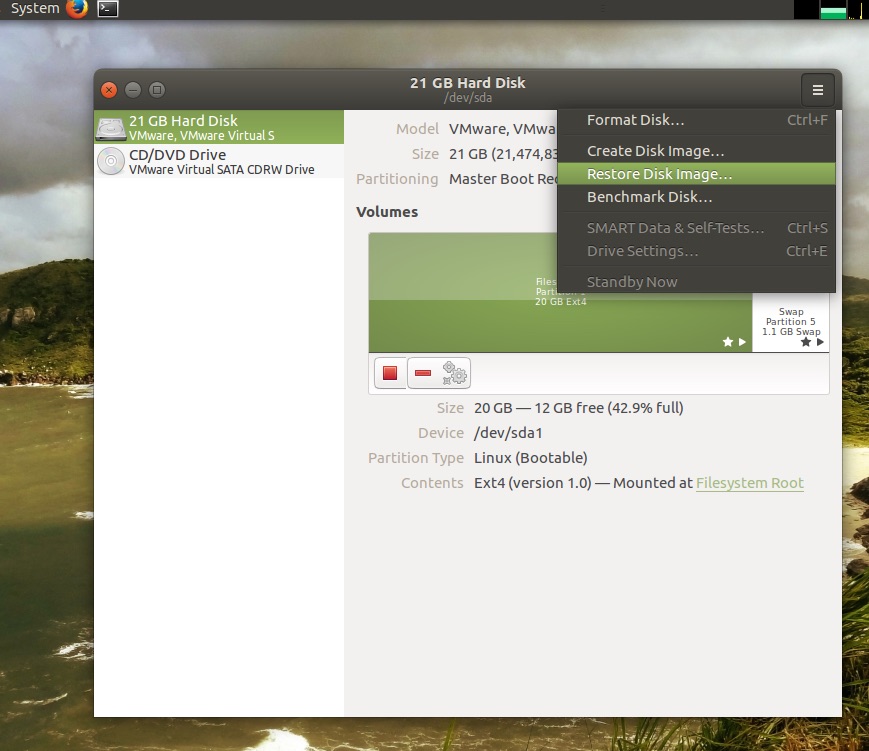

Use Linux to copy the iso to the USB thumb drive. I'm not sure what is in Mint, but Ubuntu has a Disks accessory, which I've always used to restore the PPC Linux ISO files to USB for booting on a Mac.
