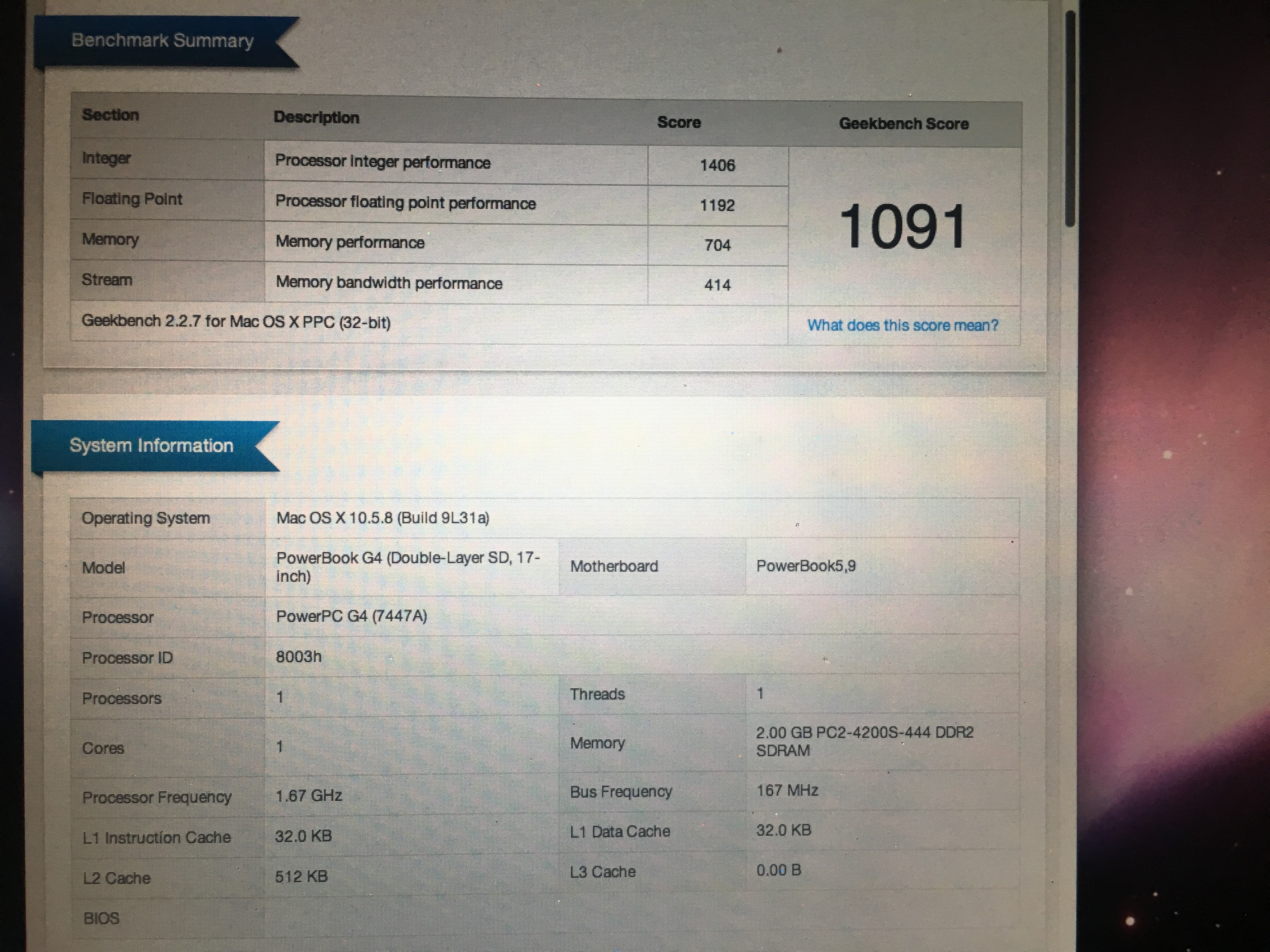

To all of you who is interested in numbers from benchmarks, Im including score from geekbench.

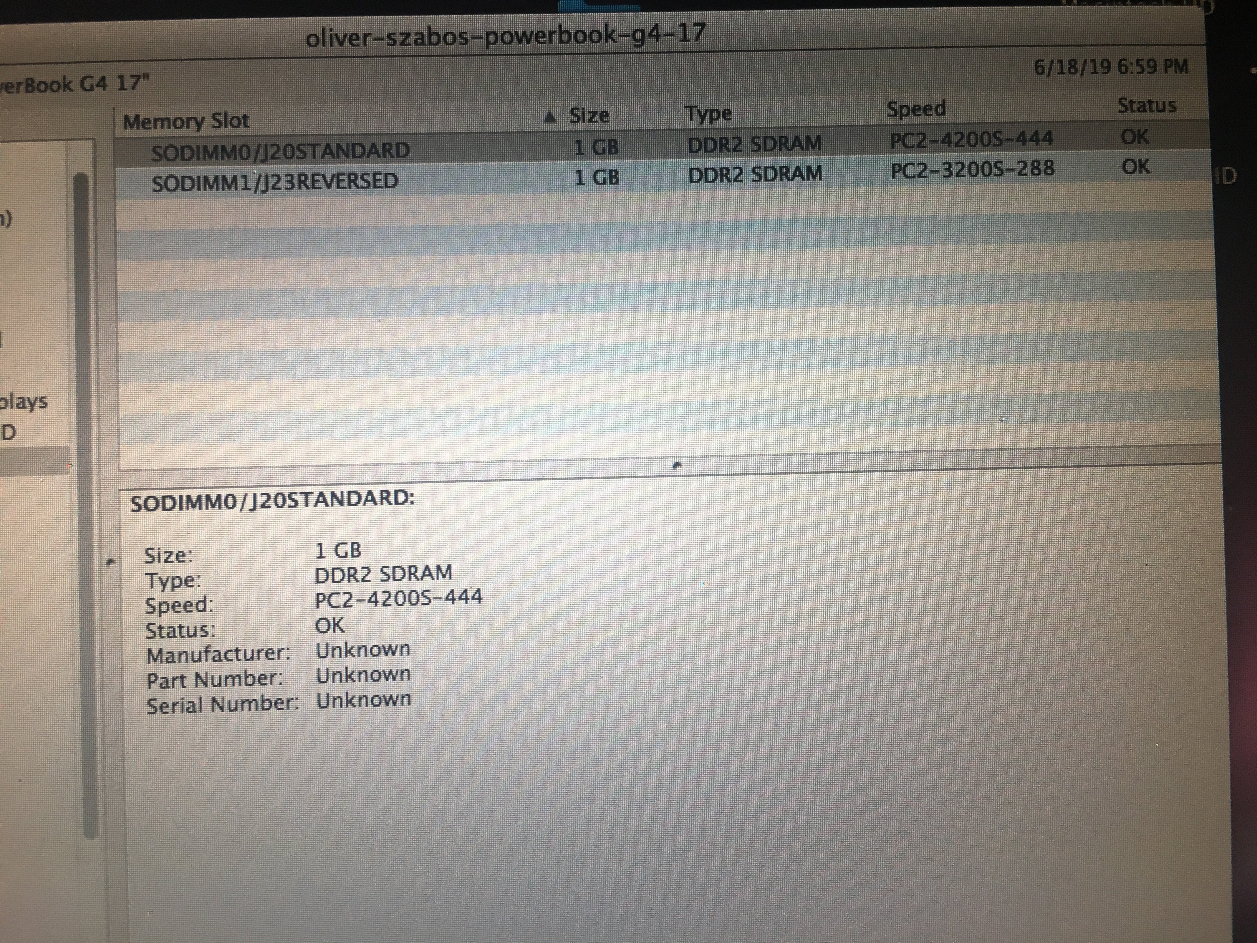

And here is my RAM setup.
It needs to be both 4200 to get the best score as it was already said. But already its not a bad score I think. I really need something to show the cpu clock or I will get insane. Also in the schematics and in the Open Firmare I noticed how it is saying about cpu0 and cpu1. Thats odd on a single core single cpu notebook.
It’s a disappointment that Geekbench is incorrectly displaying the clock speed for your device, as you did not run GB2 with a 1667MHz system. As far as I’m aware, this score remains the highest posted stock 17" DLSD PowerBook 5,9 on GB2.
Reactions: lepidotós
So then I am 46 points ahead of the highest stock dlsd. Now just to wait for the ssd and new ram and it will be higher(i hope at least).
Which is fine, but at some point you’ll need to tweak the OF configuration to correctly reflect the clock speed of your system.
Also, an SSD won’t affect Geekbench’s scoring matrix. It will, however, favourably affect your Xbench scores.
(Incidentally, I’m the owner of said highest-posted stock DLSD 17". I'm fortunate the system was in excellent condition when I found it for, like, $65, and also, that it was produced at the very end of the production run might play a factor in the quality control of the internal parts being fairly good, given that any obstacles to assembly would have been worked out by then.)

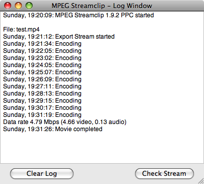

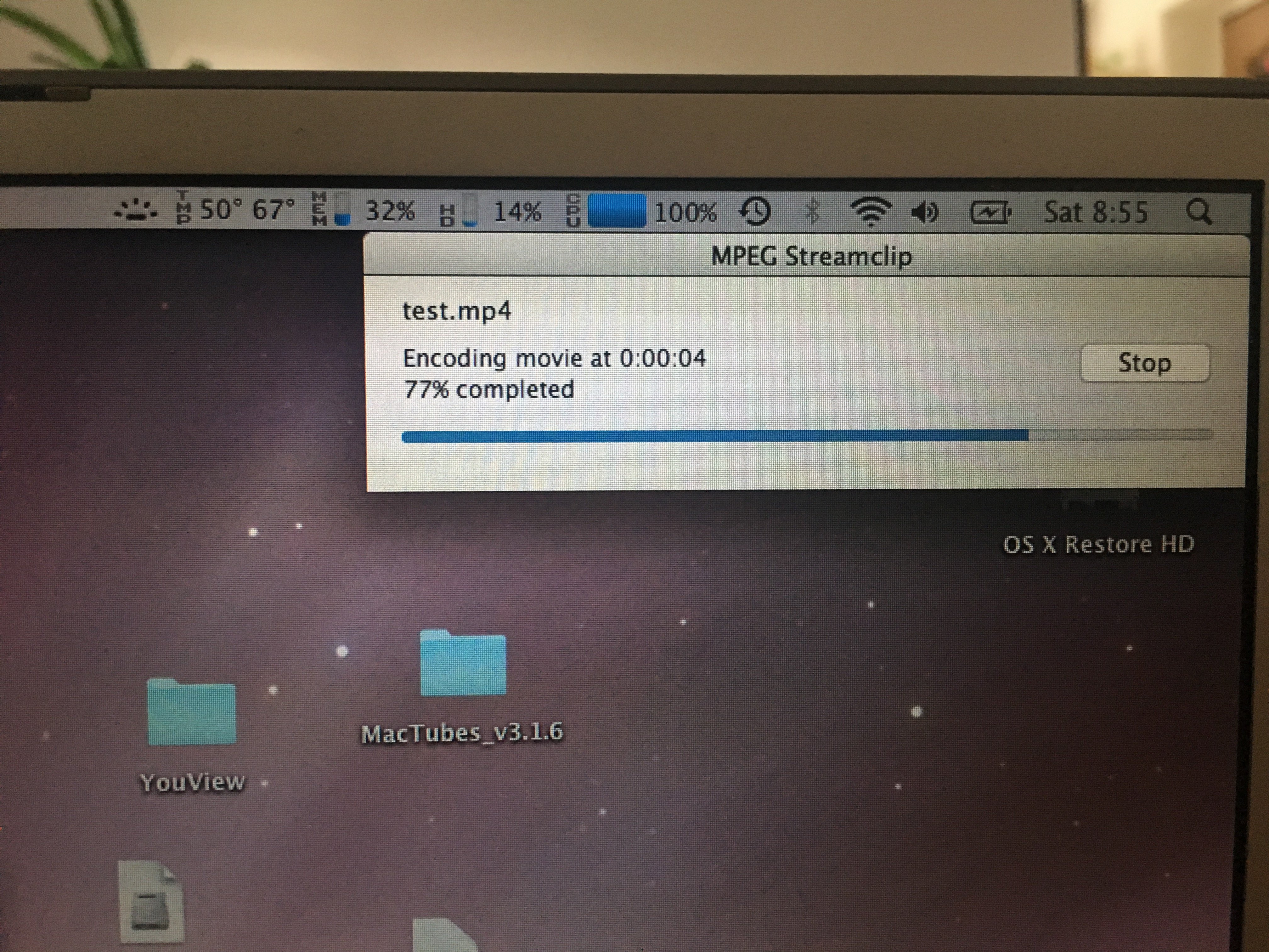

Okay here are the results and thermals during the test.
Reactions: Dronecatcher
That's 17:20 - my old 15" DLSD did 10:07 and my old 1.25Ghz Powerbook did 12:05 - you didn't have anything else running did you? Those temperature gauges will steal some CPU cycles?
Going to do the test on the DLSD I have now.
[doublepost=1561190484][/doublepost]On my current 15" DLSD score is 15:09 - full 5 min longer than previously. If you check the original thread, I think the key is the Quicktime version, 7.7 seems to be far slower than 7.5.5.
I had running the keyboard backlight adjust program which as I now checked takes up to 2-3% of the CPU and the gauges are consuming from the CPU too but I didnt checked that because im not at home right now, so maybe I am stealing somewhere about 5-6% of the CPU and also as you mentioned I have the Quicktime 7.7 and not the 7.5.5 so when I get home I will disable the gauges and the keyboard backlight program, uninstall the qt 7.7 and install 7.5.5 and rerun the tests.

Man that sucks... Anyway I downgraded the QT using Pacifist to 7.5.5 from 7.7 and also disabled the gauges and backlight control program. Here are the new results from Xbench, GeekBench and your style benchmark:

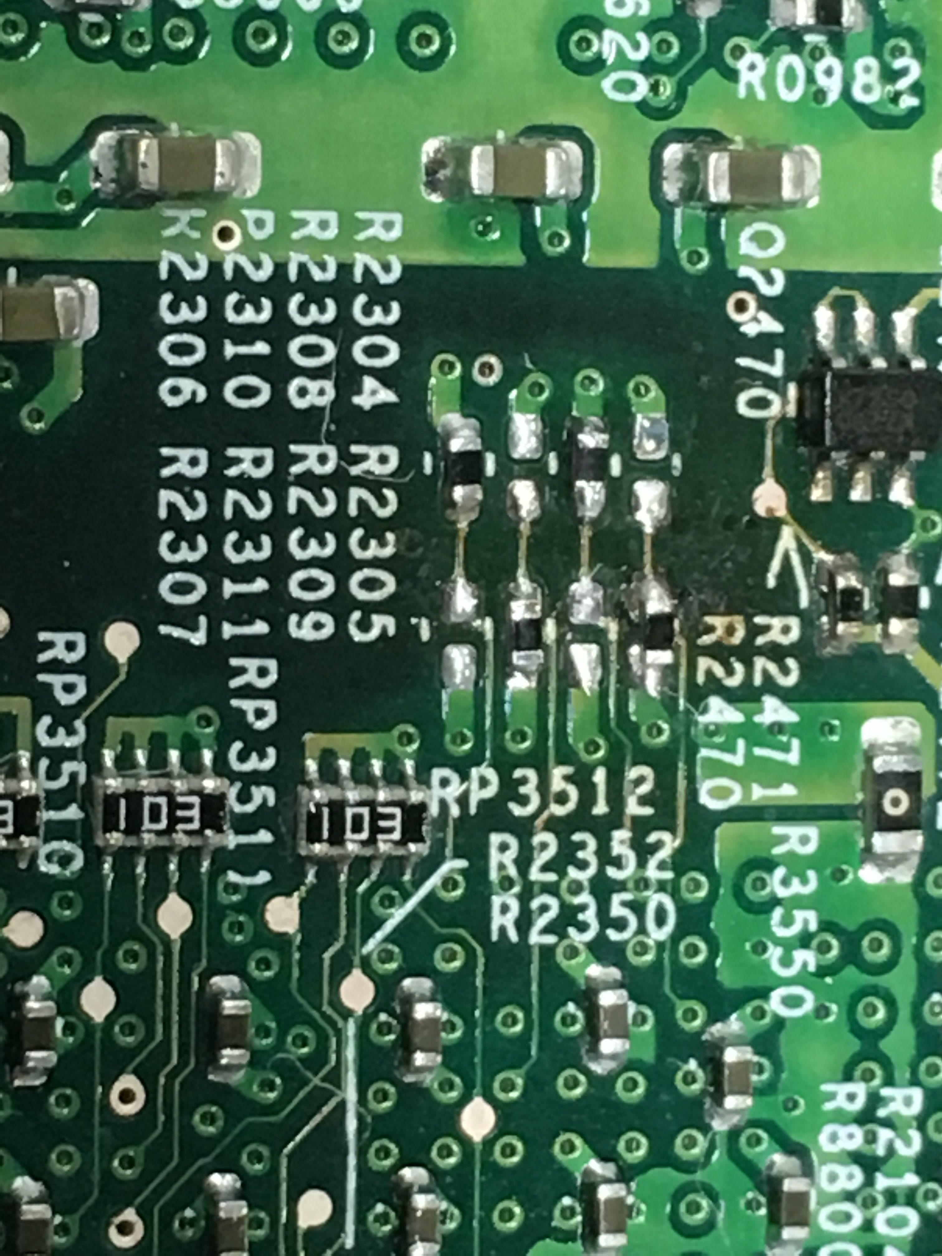

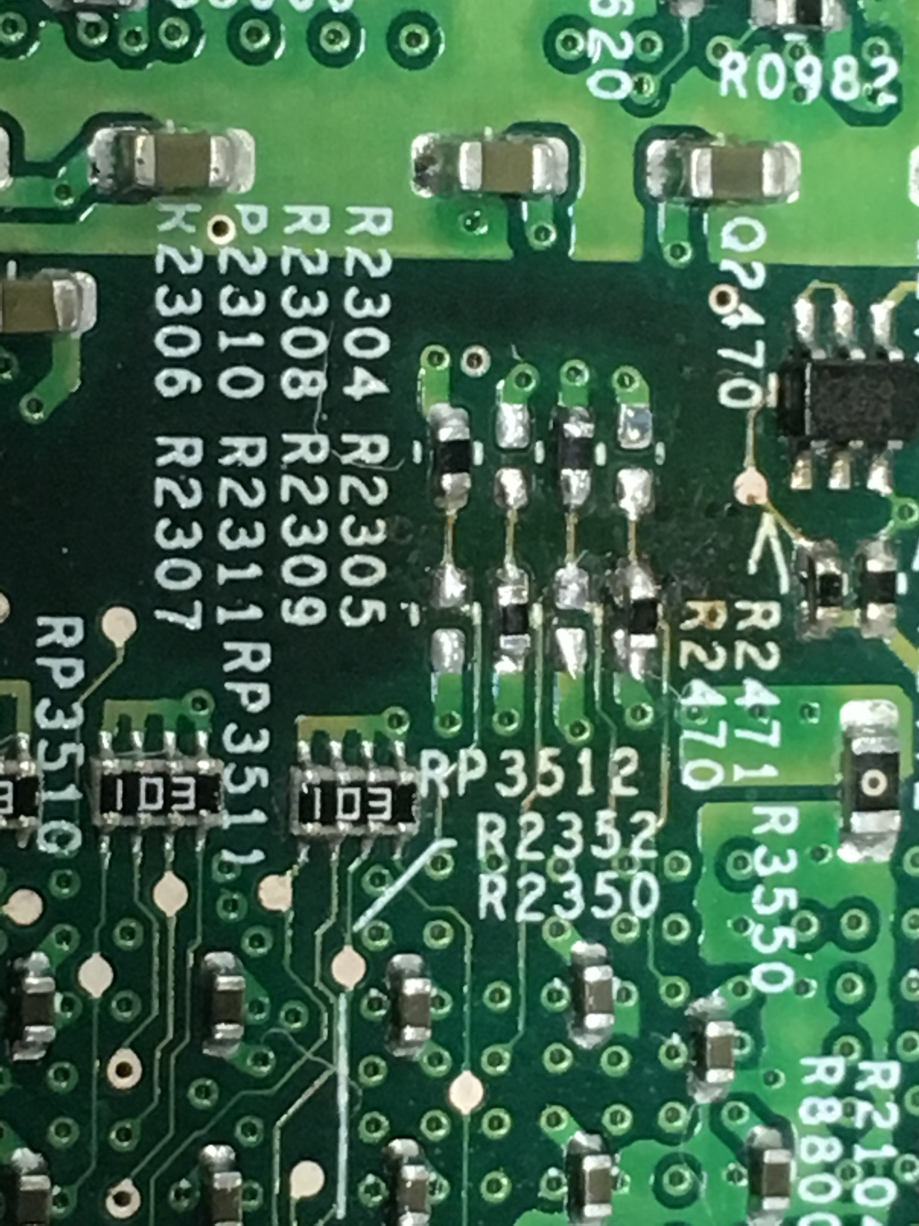

Today I opened my DLSD and I set it to 189MHz bus so the cpu clock is 1,89GHz and not 194MHz bus and 1,94GHz cpu. So the results I posted are with the bus on 189MHz and CPU on 1,89GHz. Here are the BOM resistors:
So sorry for wrong info but that speed bump is good for the clock I am running, but I am worried for the thermals if I go higher.
Thanks for the correction, and especially the close-up photo for anyone who might want to try this!
That being said, how about an update? Has your PowerBook been stable? Have you used it much? Is there any specific indication that the speed boost presents a thermal problem?
I am using it on daily basis, mainly for web browsing and sometimes for games(Minecraft and Ghost recon), its stable, no lags, no system or app crashing, whole powerbook is slightly quicker. And the last thing you asked are thermals... Well the stock cooling is handling it pretty well. No shutdowns from overheating, the fans are kicking in more often but nothing horrible.
