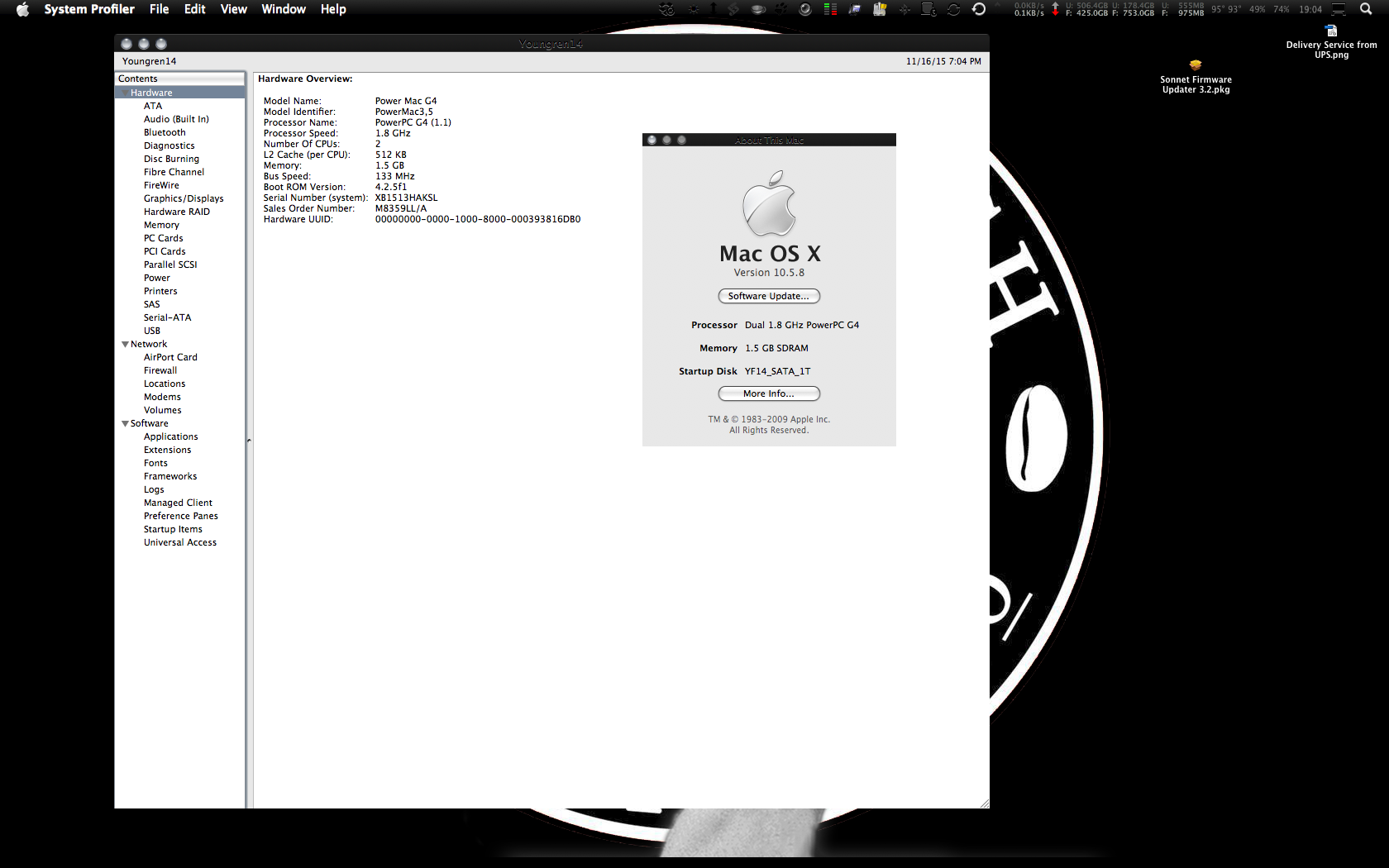

Thanks guys! I guess I just assumed that since these were third party upgrades the software/firmware would be proprietary and therefore would not work for the competitor's hardware.
Bunn, you're probably right given that Giga is overclocking a slower CPU.
OK. So, I followed instructions and got as far as running the Sonnet Firmware Update app. It gave me an error for an unrecognized ROM.
Absolutely no idea what this means and I'm not about to try and figure this out if it turns out the CPU will work.
I know it was mentioned that these are different processors. But, the Mac had a Sonnet in before. So, I shut down and installed the Dual.
Booted right up. System sees it as a Dual 1.8Ghz (screenshot) and is working just fine.
Unless someone can see any idea as to why my system should NOT be performing I'm just going to let the ROM thing go. It's working.
And it's FAST!!!
very nice to see its working out 🙂 the sonnet firmware patcher prolly got confuse by the fact you already had the giga designs patch installed. that must be a very fast G4 now 🙂 Just needs a Graphics card upgrade...(im thinking if the FireGL X3s wont work maybe you could find something like a Geforce 6800 or 7800 since those are known to work in QSs...)
