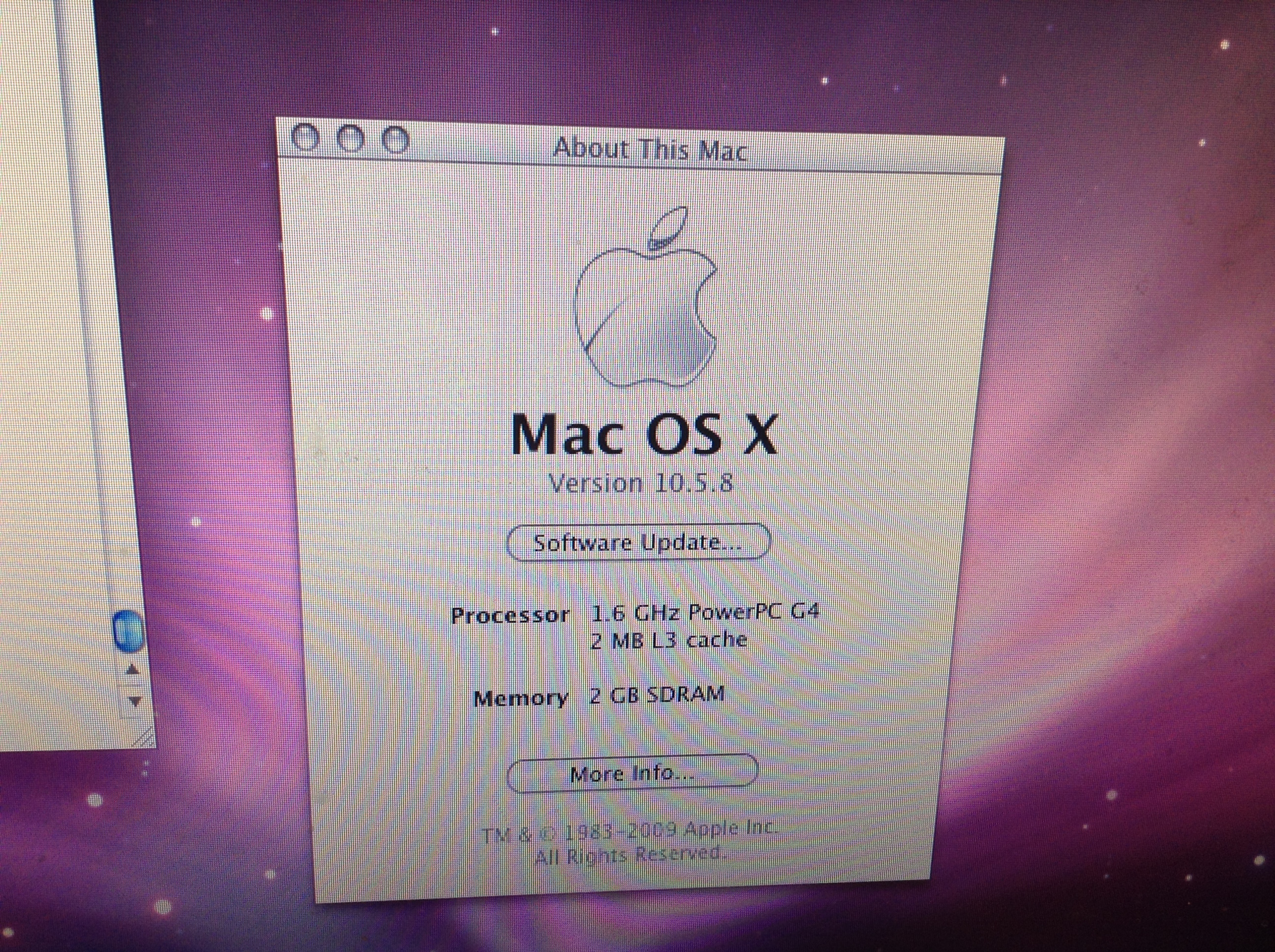

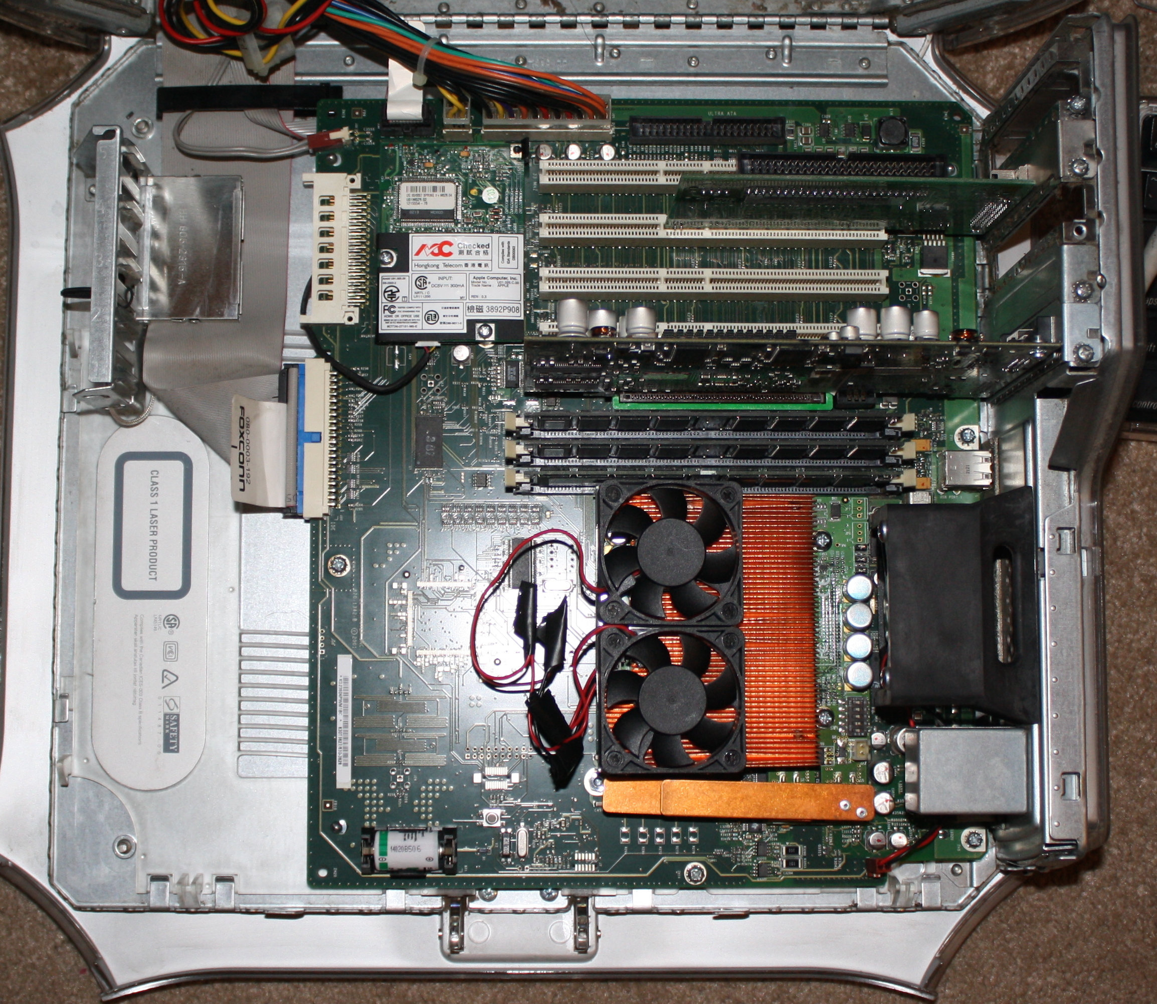

I'm in the middle of working on a what should be a fun(and probably frustrating) project with one of my Quicksilvers.
Those of you who have been around this forum for a while might recognize something in the below photo, although never in one of my pictures before.
The hard drive is currently in another Quicksilver-it has a fresh Leopard install, and I'm running software update and going to install a few other programs before I run the installer to install the kexts to make this work.

Oh Very Nice 🙂 you should pop the heat sink off redo the thermal paste and check what speed the CPUs are actually rated for as I know gigadesgines likes to install lower speed CPUs then factory OC them (I have a 7455B CPU upgrade from them like that it was sold as 1.4Ghz but it has a 1.25Ghz Chip the fastest iv been able to push it was 1.6Ghz at voltages id prolly get shot for 😛 (1.85-1.95) but it was not stable like that how ever it does run nicely at 1.5Ghz 1.65V heh

Once I finish bringing Leopard up to date, I'll boot it up and see what happens 🙂

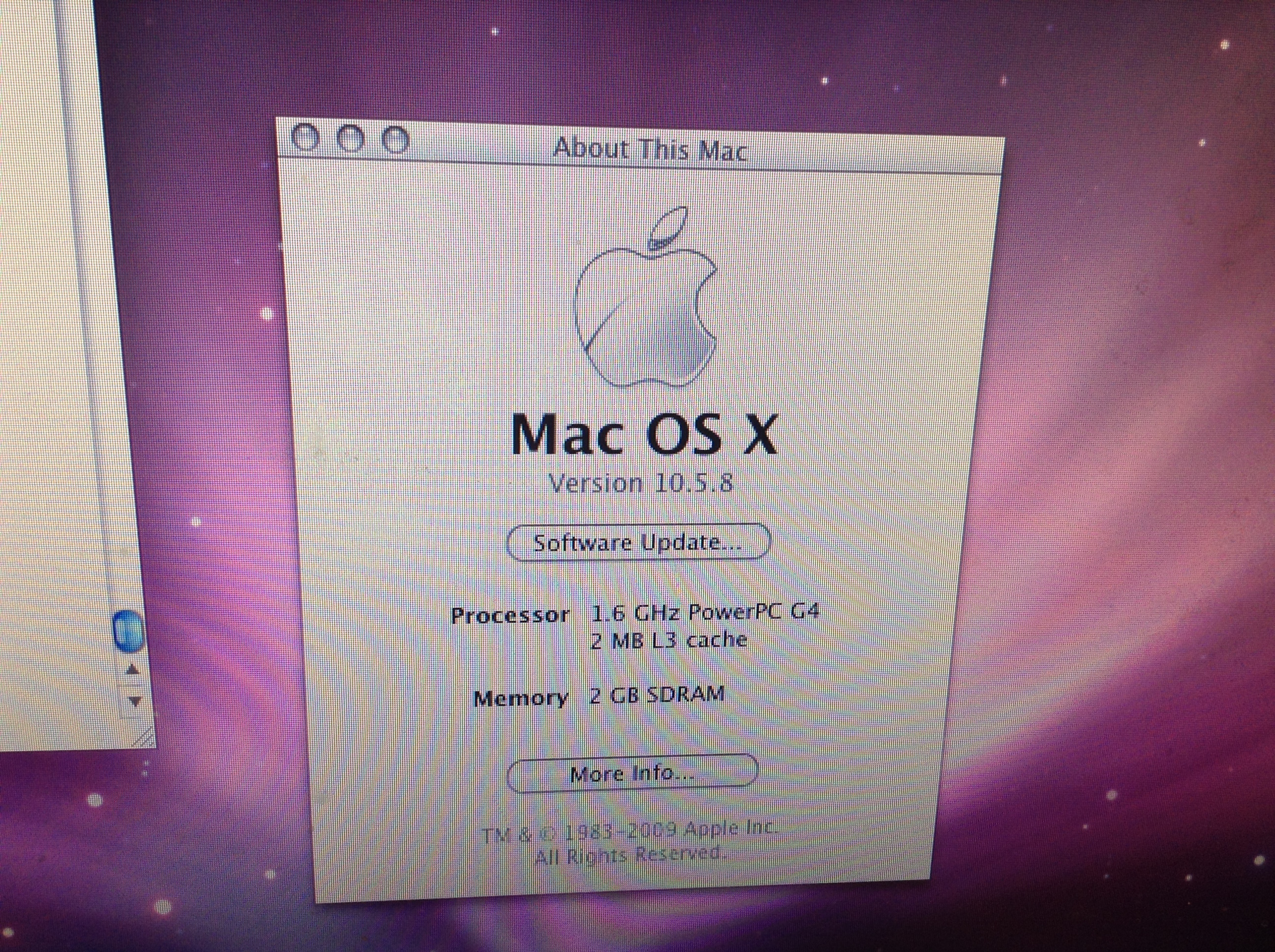

Well, I think I've hit problem #3.
I did a fresh Leopard install, brought it up to date, then ran the Gigadesigns installer(Giga-meter). I didn't let it boot in the host system(maybe I should have), and then transferred the drive over to the computer with the Gigadesigns processor.
It seems to hang at the Apple. I doesn't boot to the point where I even get the spinning indicator under the Apple. I let it sit like this for a while, and it didn't go anywhere. Heat doesn't seem to be an issue, as the heatsink remains cool to the touch.
I've tinkered with the voltage over the full range I have jumper settings for(1.35V to 1.65V) and nothing made a difference.
I then set it back to 1.5V, and bumped the speed to 1.73ghz. I didn't get anywhere with this-all I got was a black screen, and the LED on my mouse never turned on. I again tinkered with the voltage over the full range, and got the same result.

Yeah, that sounds like my experience.
It sometimes 'catches' and boots, but more than often not. That just reinforced my decision to leave the Mac running all the time. Once you can get it to boot, warm reboots aren't a problem. It's just cold boots.
Here's something to try.
Power on. Give it a moment to see if it works. If it does NOT, then press and hold the power button to shut down. The MOMENT the computer shuts off, press the power button again to turn power back on.
Sometimes multiple presses of the reset button while power is on works too.
I think you are now experiencing my pain. 😀
P.S. Try flashing the ROM again if all it does is hang.

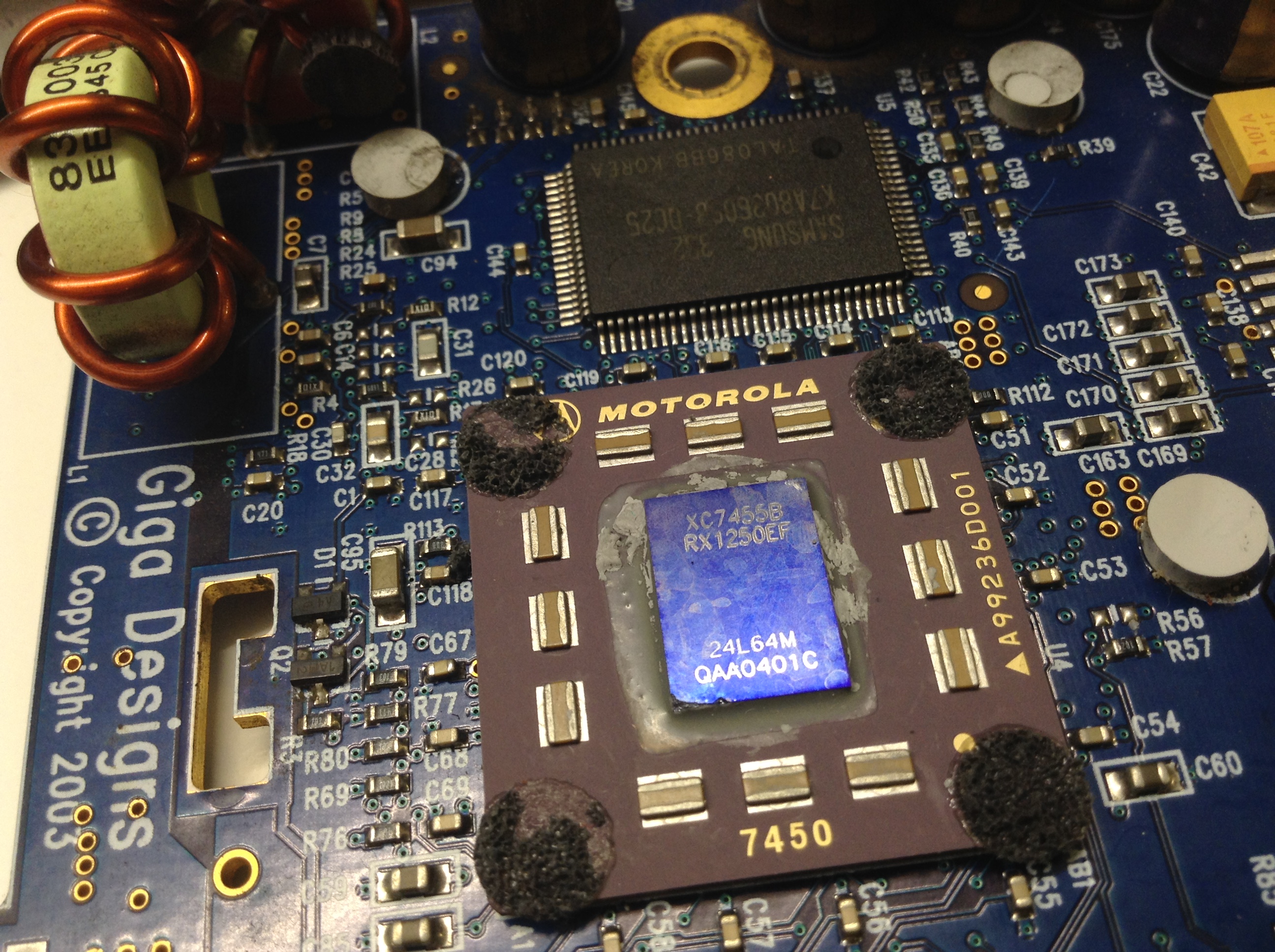

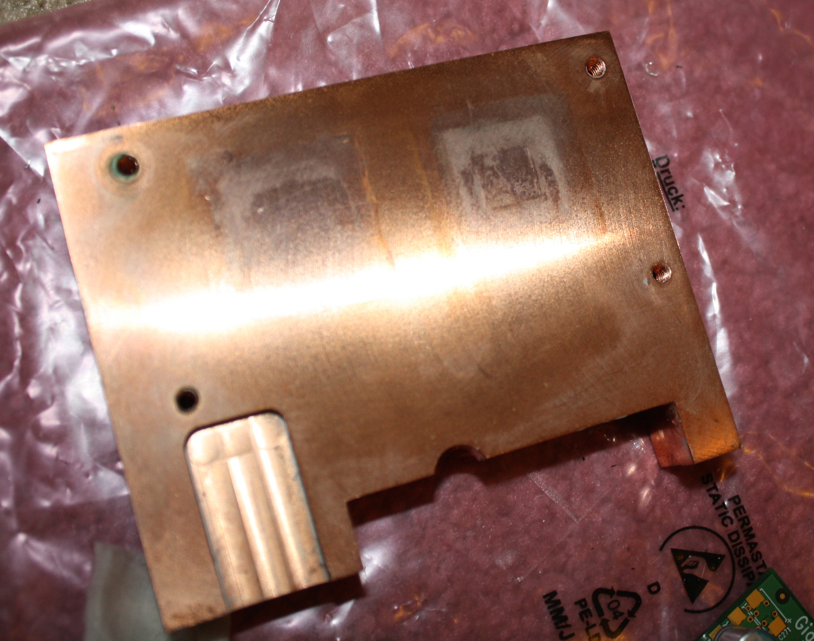

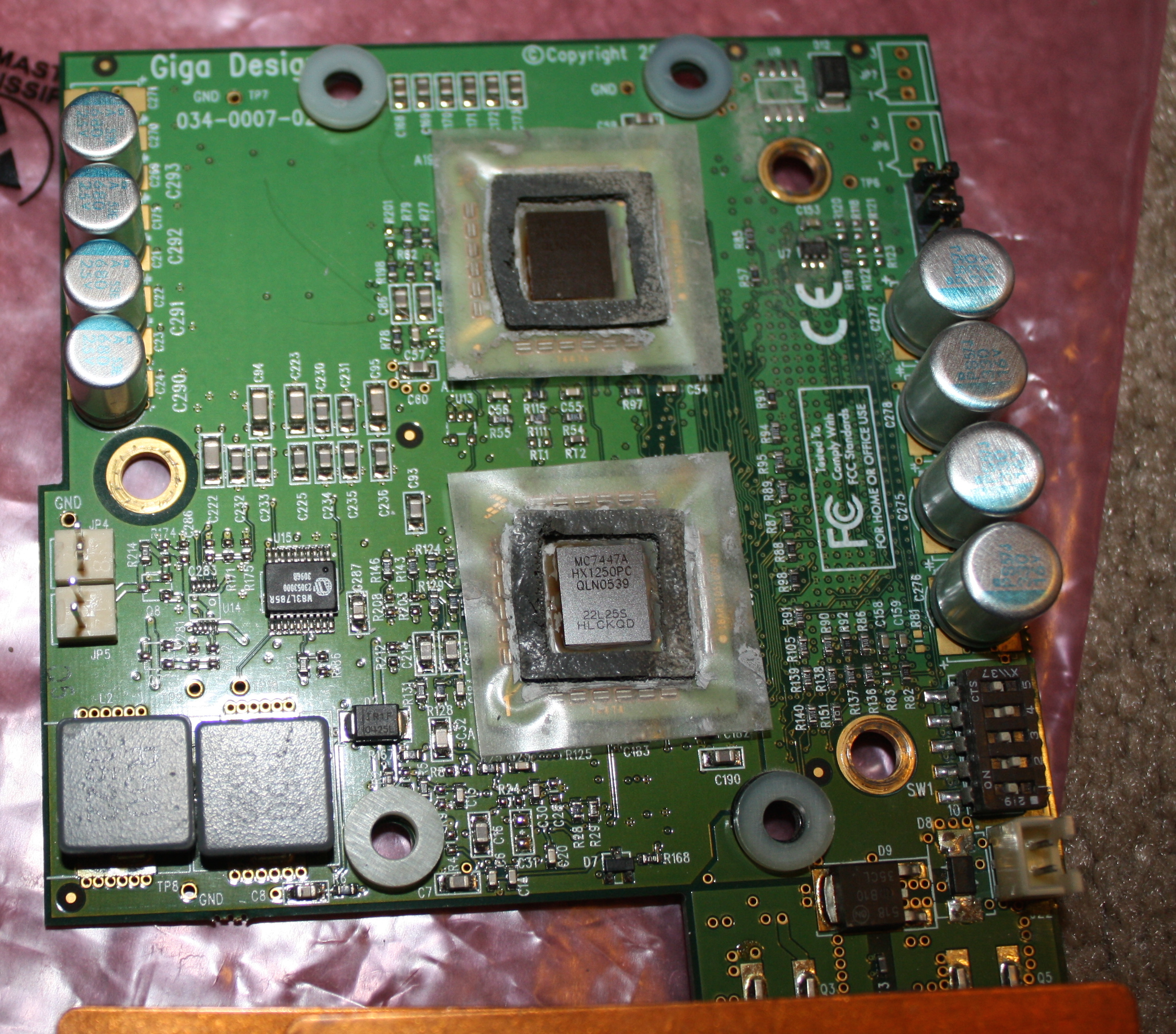

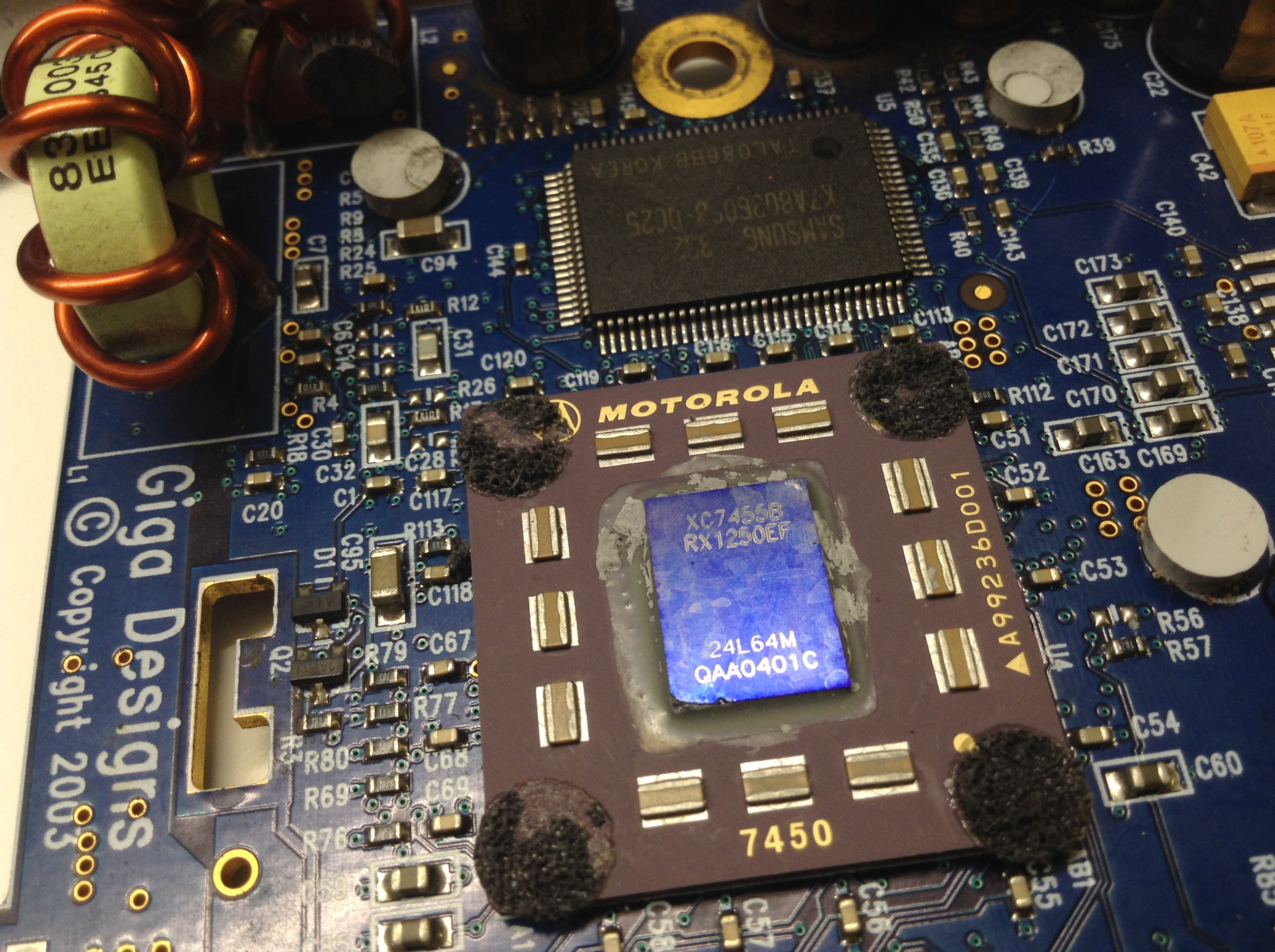

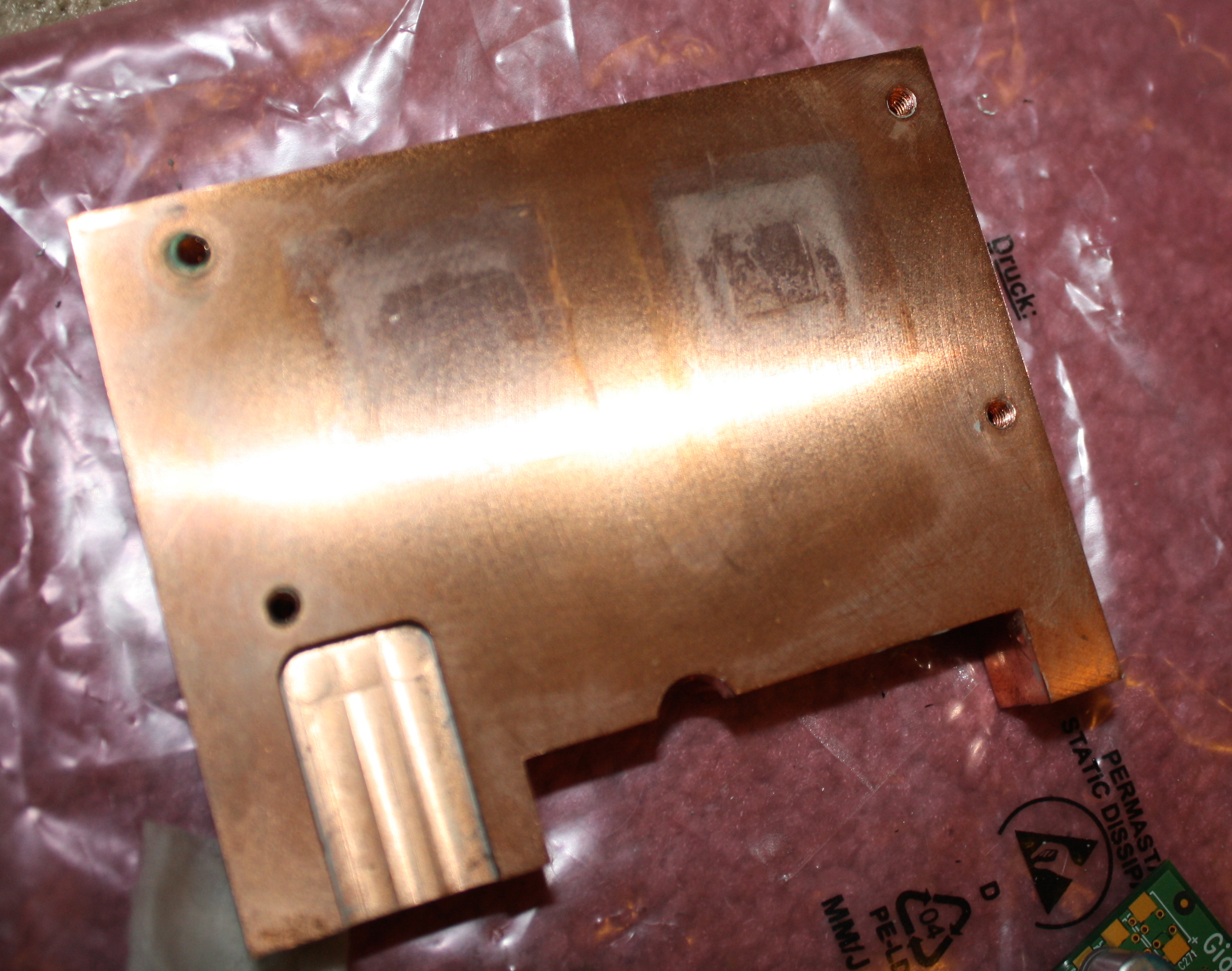

I'm doing that now, but in the mean time decided that it probably wouldn't be a bad idea to go ahead and repaste the CPUs. I had to go and dig out the point spanners I bought several years back when I was dabbling in camera repair to remove two of the screws(apparently GigaDesigns really didn't intend for these to be user serviceable) but otherwise had no trouble with the process.
I thought folks might be interested in seeing the clean CPUs to see what makes this upgrade "tick."

whoa 1.25Ghz CPUs!!! No wonder it has issues and to think they sold that saying its 1.8Ghz did they ship it set to 1.8ghz? I find it funny as I basically have the single 7455B version of that CPU upgrade again my chip is 1.25Ghz but factory OCed to 1.4Ghz and I have it at 1.5Ghz and the highest it will go and still boot is 1.6Ghz but its not very stable that highly clocked (on a 100Mhz Bus on my sawtooth I run out of multipliers at 16X 😛 )

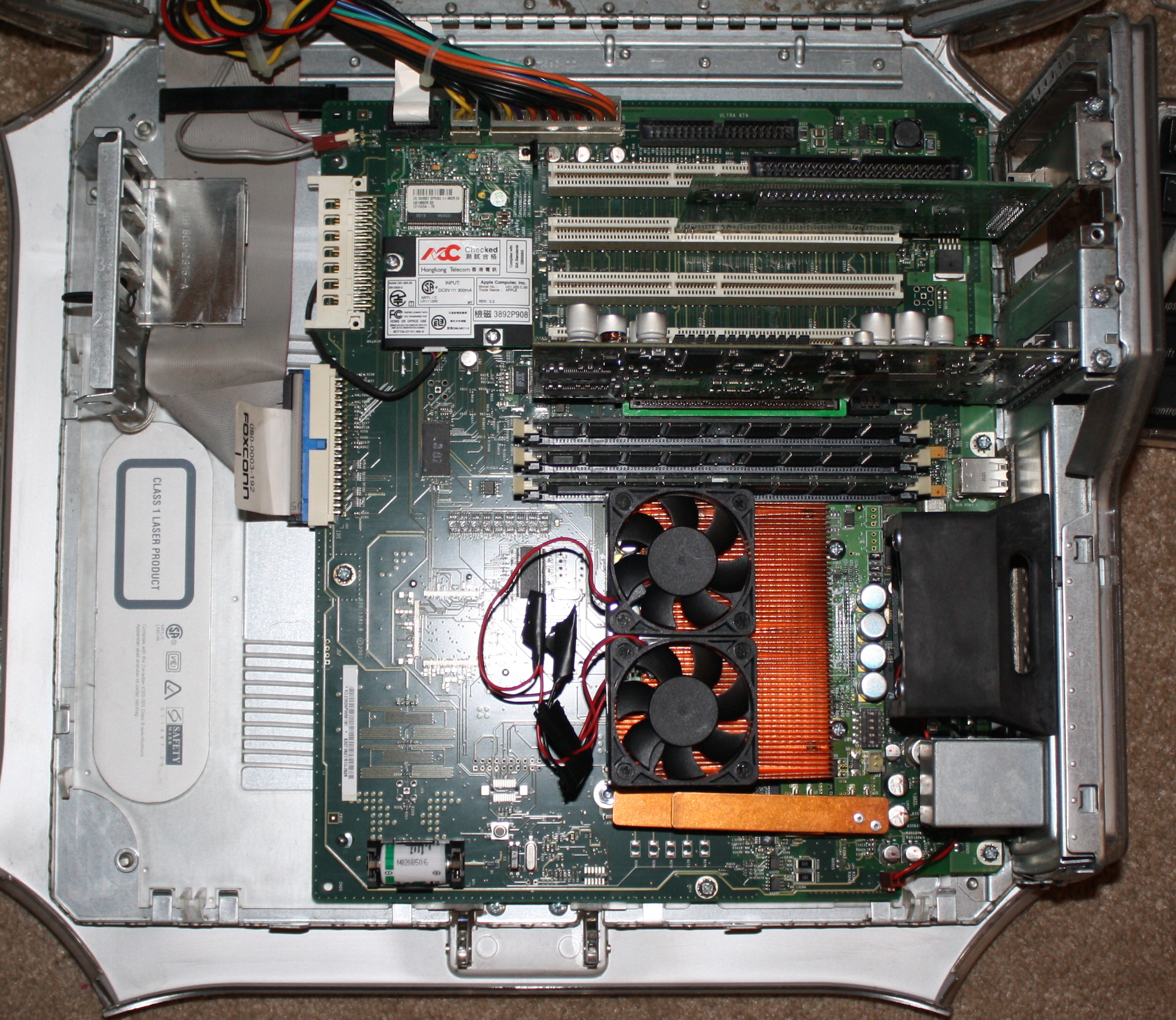

I really hope sonnet cards aren't this hard to setup...
The seller was going to take the money I spent on this and go shopping for a better Sonnet than the one he has now for that exact reason.
FWIW, this is the second after-market CPU upgrade I've installed. The first was a FastMac G4 upgrade for the B&W G3. There was a firmware upgrade for these that is necessary for one version of OS 9 to work, and that firmware upgrade locked out the ability for the B&Ws to recognize a G4 processor. The Fastmac processor came with a firmware upgrade that unlocked the firmware for a G4 to work. Once that was done, the processor dropped in and has been 100% reliable since then. I did have to change jumpers on the board to get the processor up to its fully rated clock speed, but the computer would have been fine if I hadn't done that.
The Gigadesigns is a different story...
