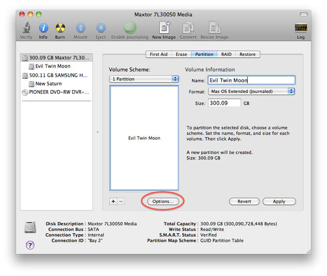

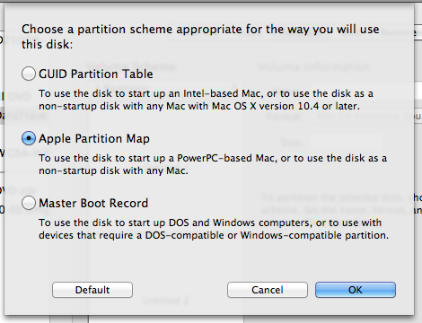

Create 2 partitions then immediately go to Options (as circled in this picture). Here you will see 3 options: GUID, APM, and MBR. Select APM.

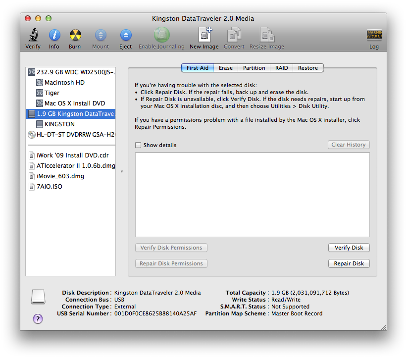

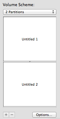

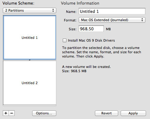

I did this just for you.
1. Select hard drive (in this case Kingston)
2. Select the Partition tab
3. Dropdown and select 2 partitions
4. Select "Options" at the bottom
5. Select "Apple Partition Map"
6. Rename the partitions from "Untitled" to "Machintosh HD" (which I didn't do in this picture but that's ok) then click Apply. You are now good to go and install OS X Leopard.
If this does not work, then I have to believe that it's a jumper issue on the hard drive.
