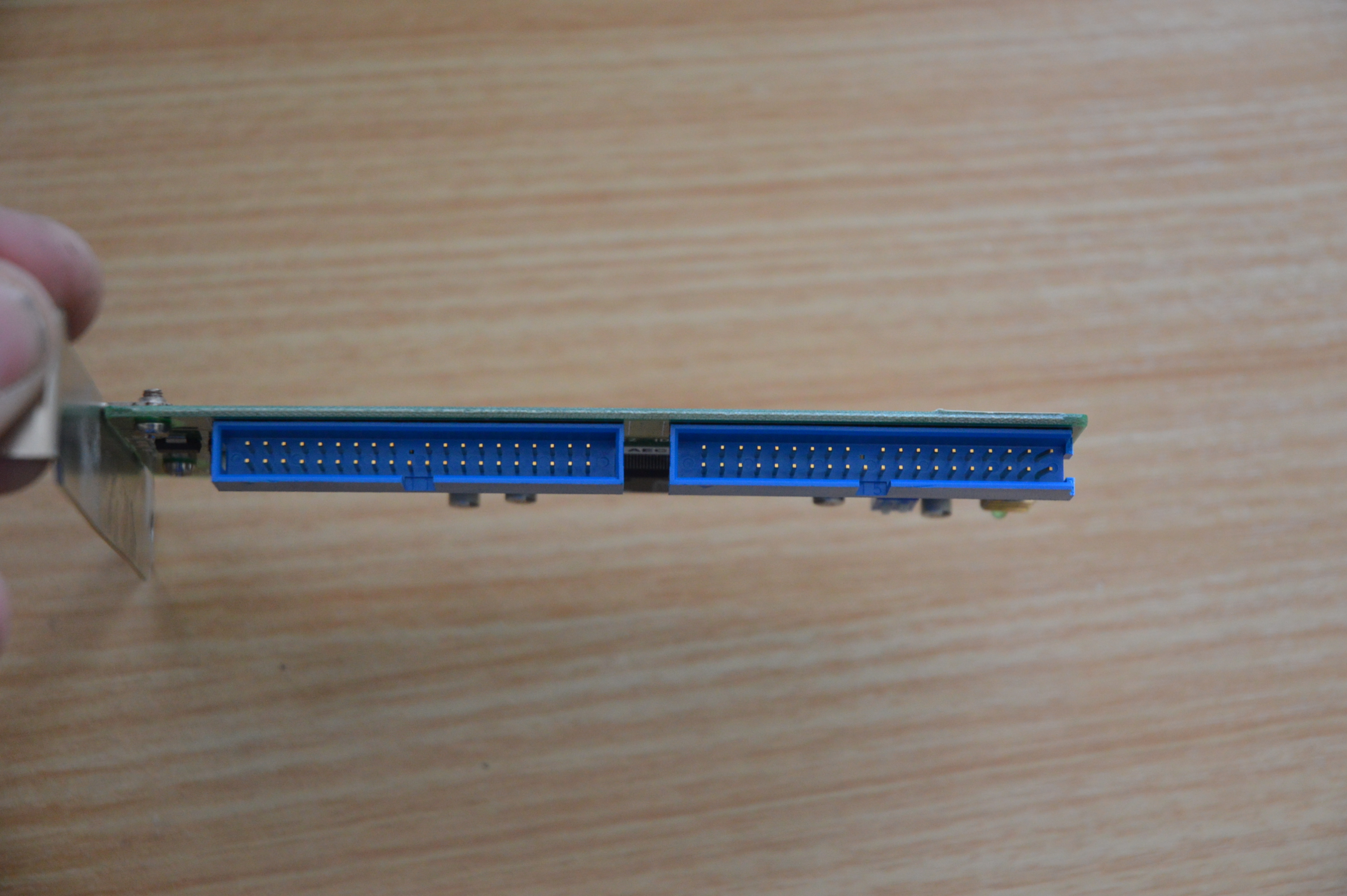

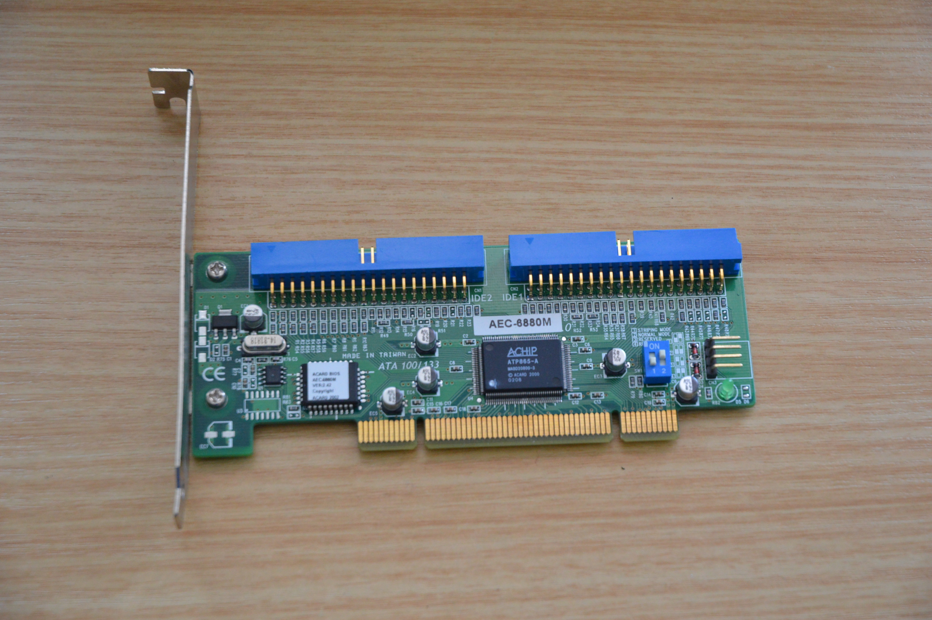

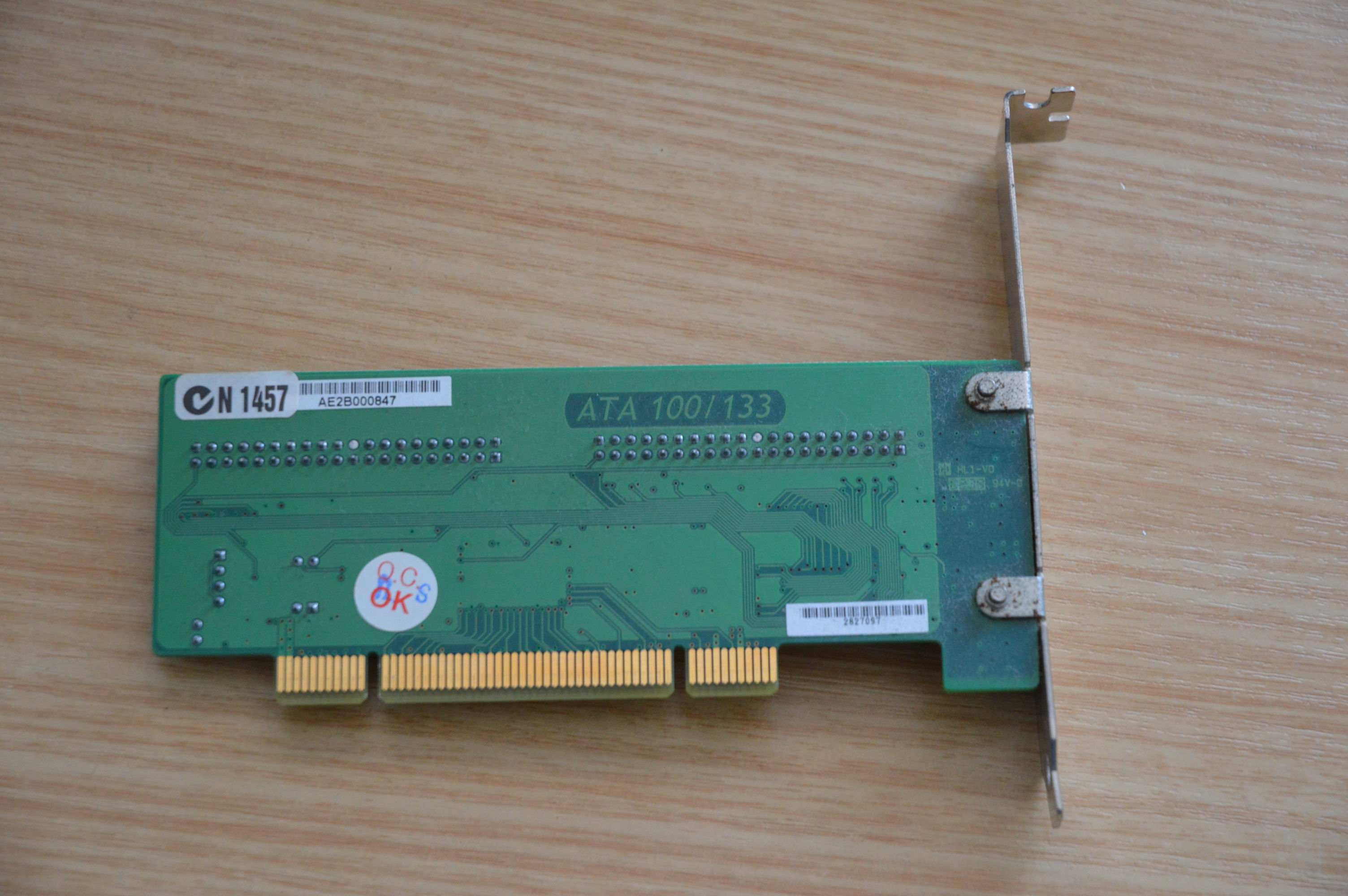

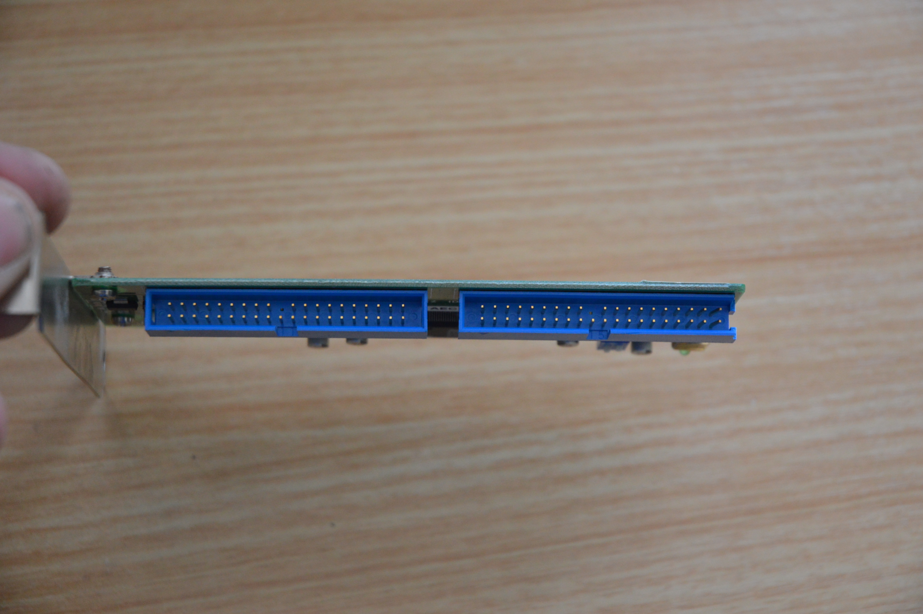

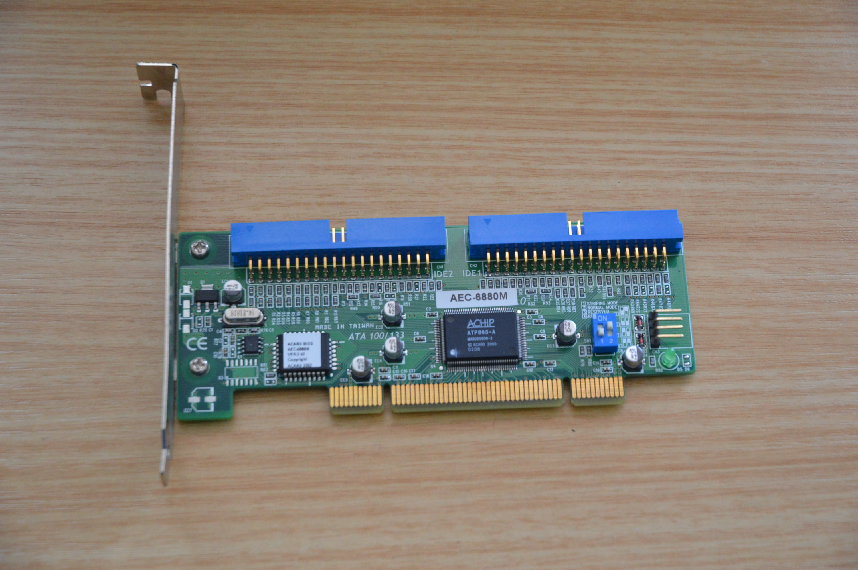

sitting inside the G5 is was this card with 2 IDE cables coming off it , so i am thinking if i use this it SHOULD work .finger crossed.

I suggest trying to not use that card at first. Instead work on getting the G5 running off of its SATA drive. That card is a PCI card and will not fit in a late-2005 G5's PCI-e slot.

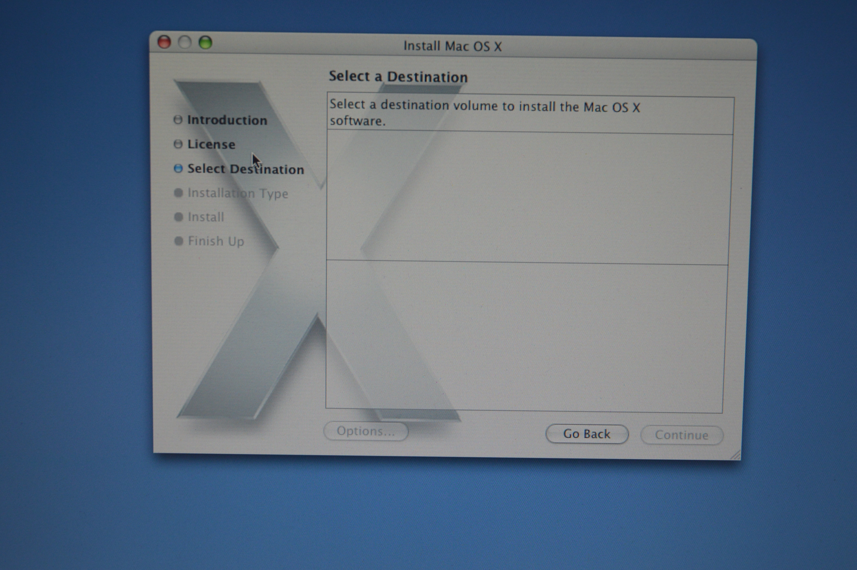

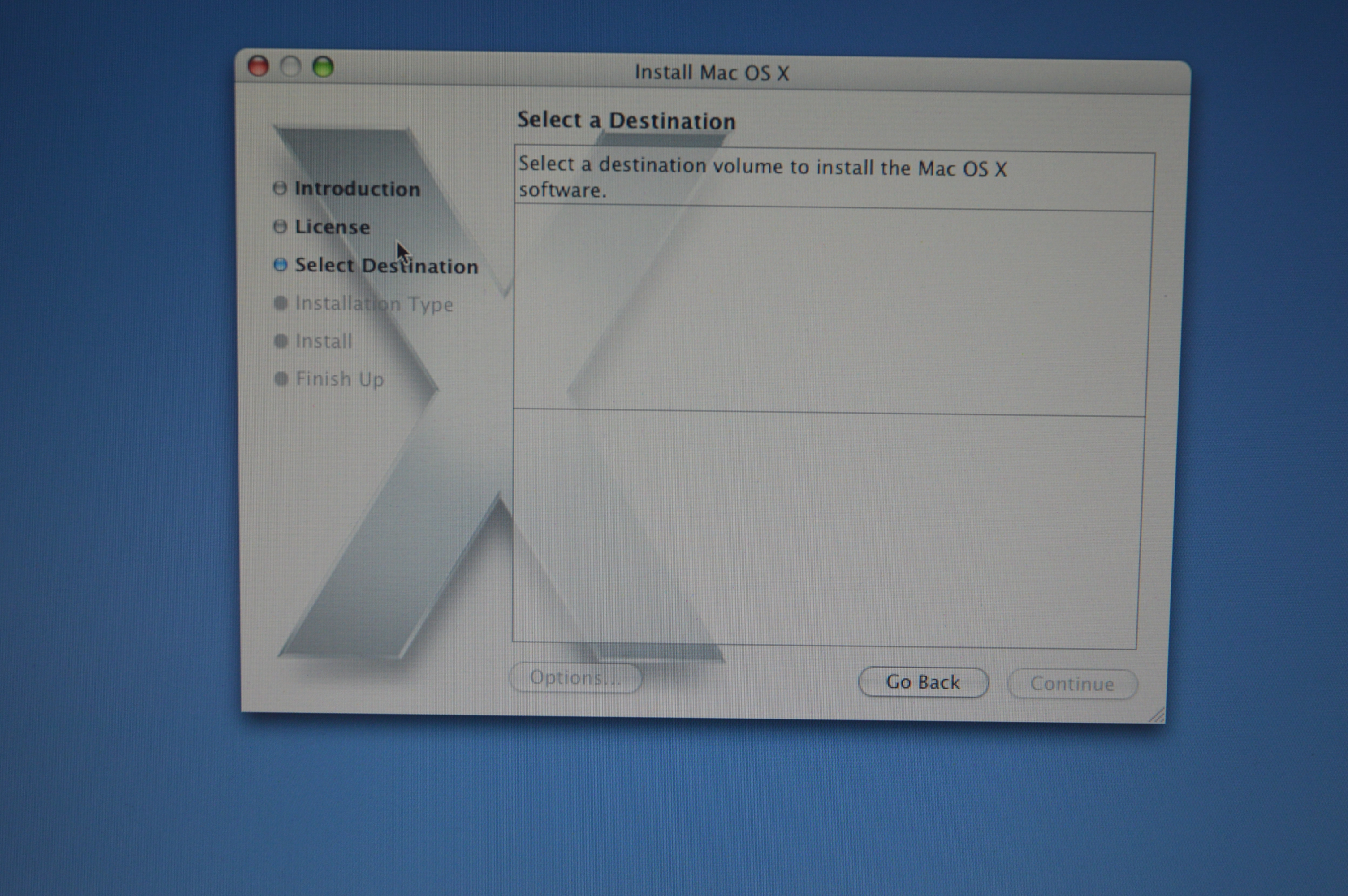

During the Tiger installation process, open Disk Utility and format your new drive as 'MacOS Extended (Journaled)'. Close Disk Utility and then see if it discovers your hard drive.

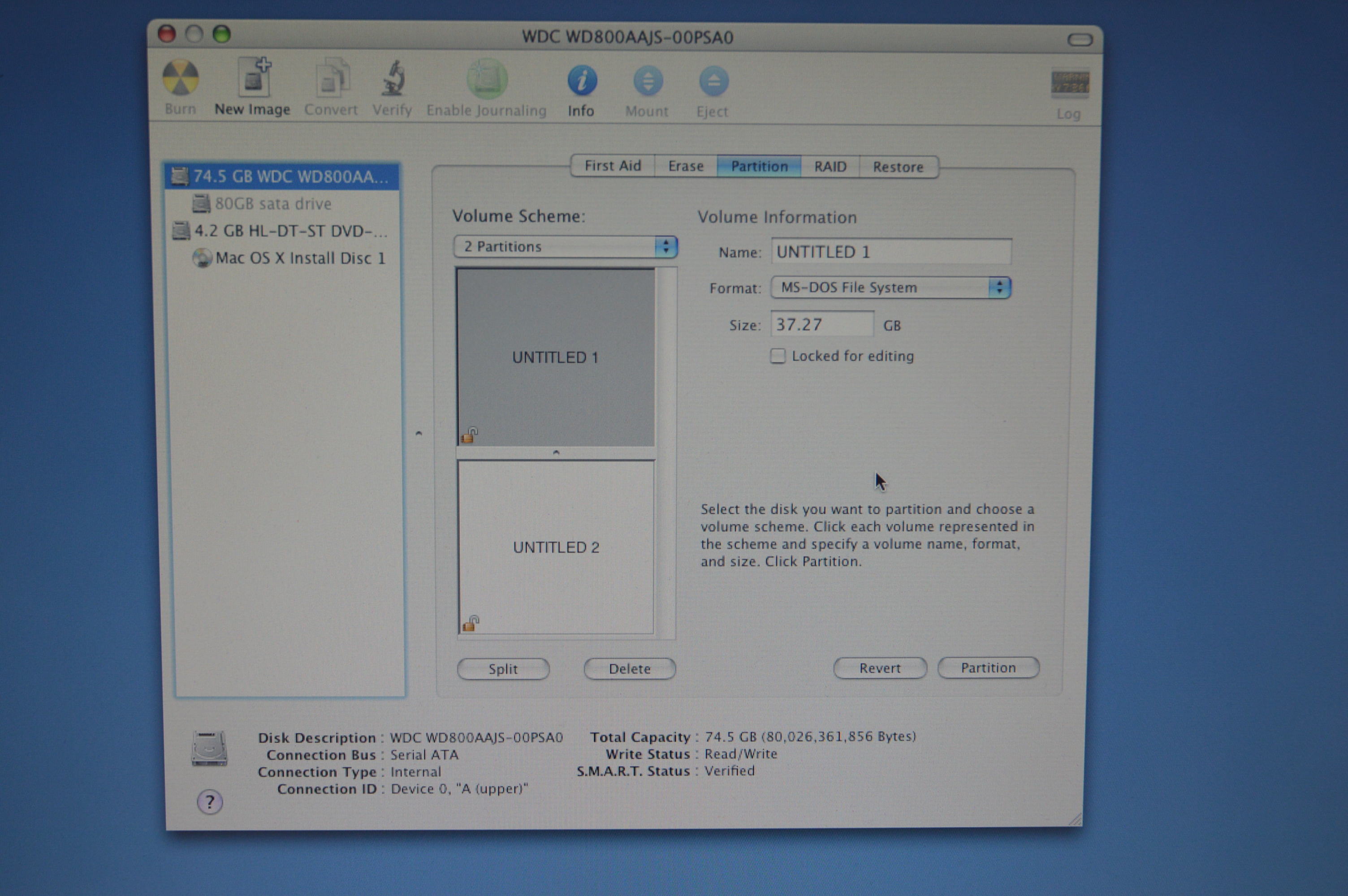

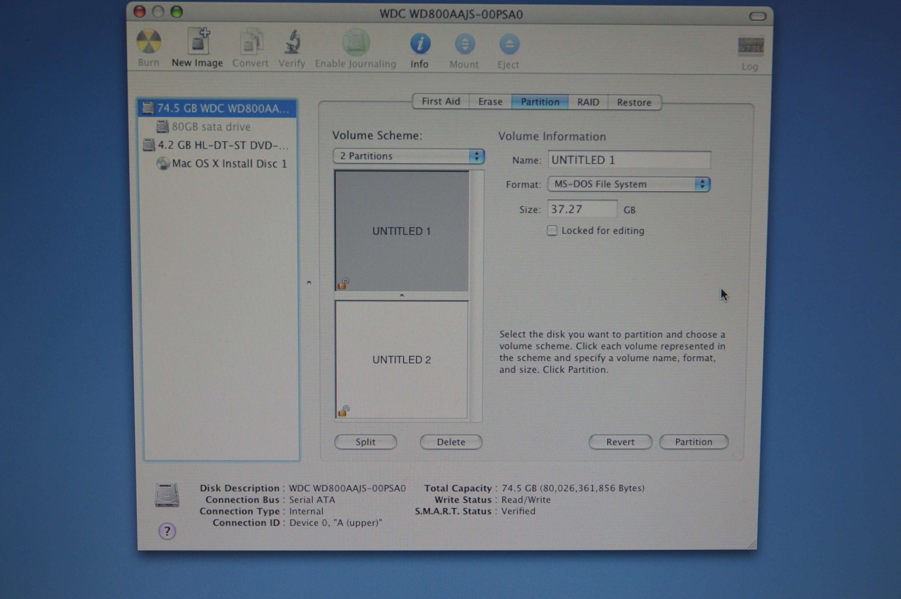

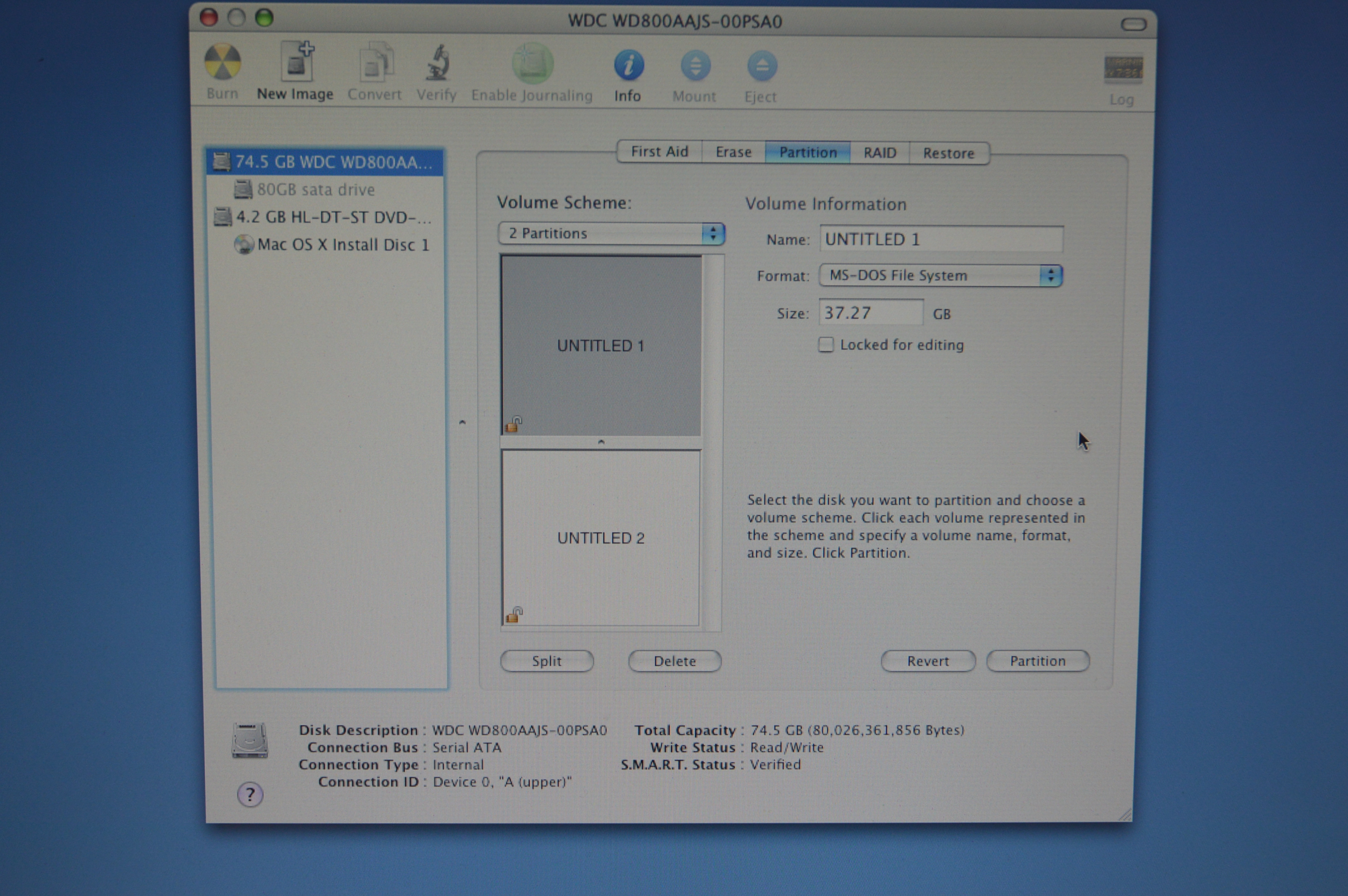

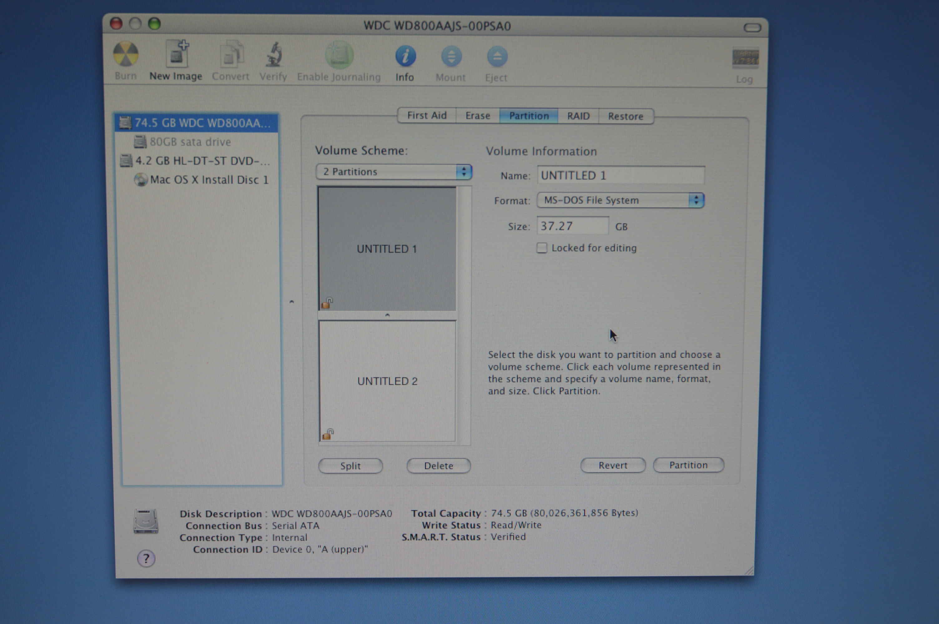

Right here go's guys here are pictures of disk Ute's screen on my G5.
You can see that i don't have any options button at all

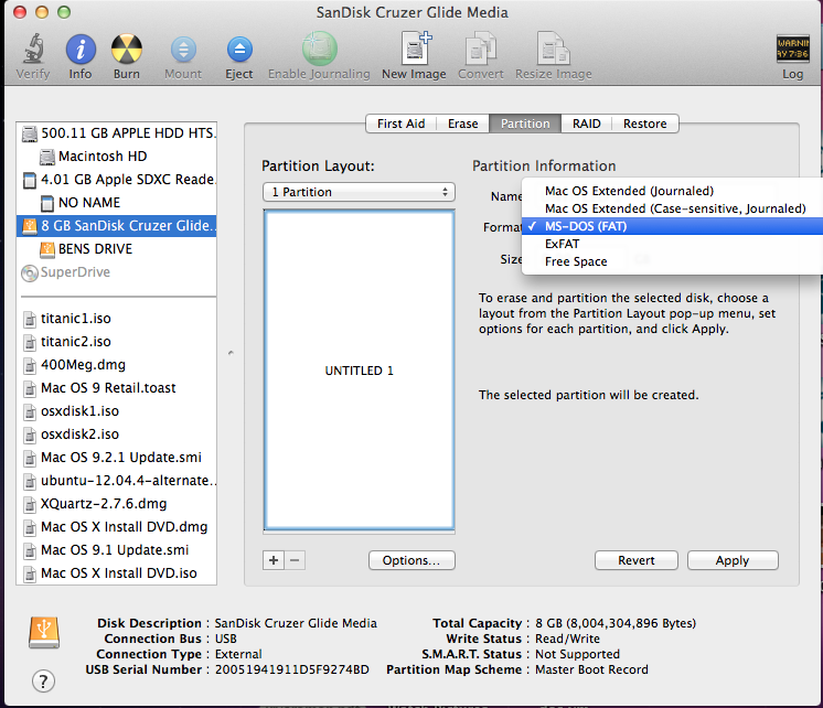

Just underneath the partition name, click on the drop-down menu that currently says "MS DOS File System" and select "Mac OS Journaled(Extended)" from the list.
I think that when you do that, you may see the "options" button that we've been describing.
I did this from my Macbook Pro, but disk utility in 10.4 should be "close enough."
