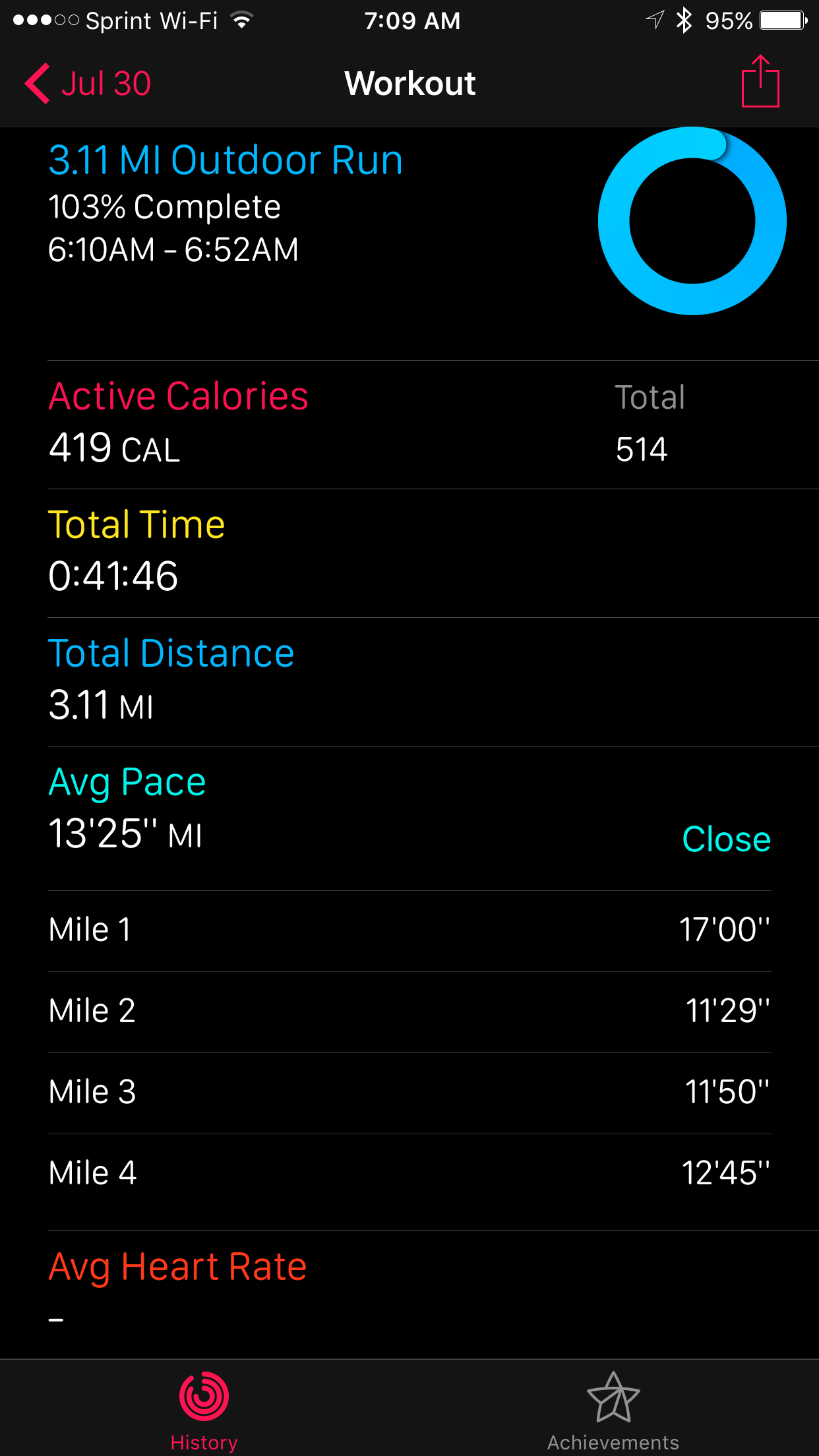

I would hang up the shoes if I ran a 17 min mile. No speed demon but not a extra on the Walking Dead either. This is what the AW told me I ran the other day.
Full disclosure running the public beta 2 on the iPhone so wondering if this is the issue.
