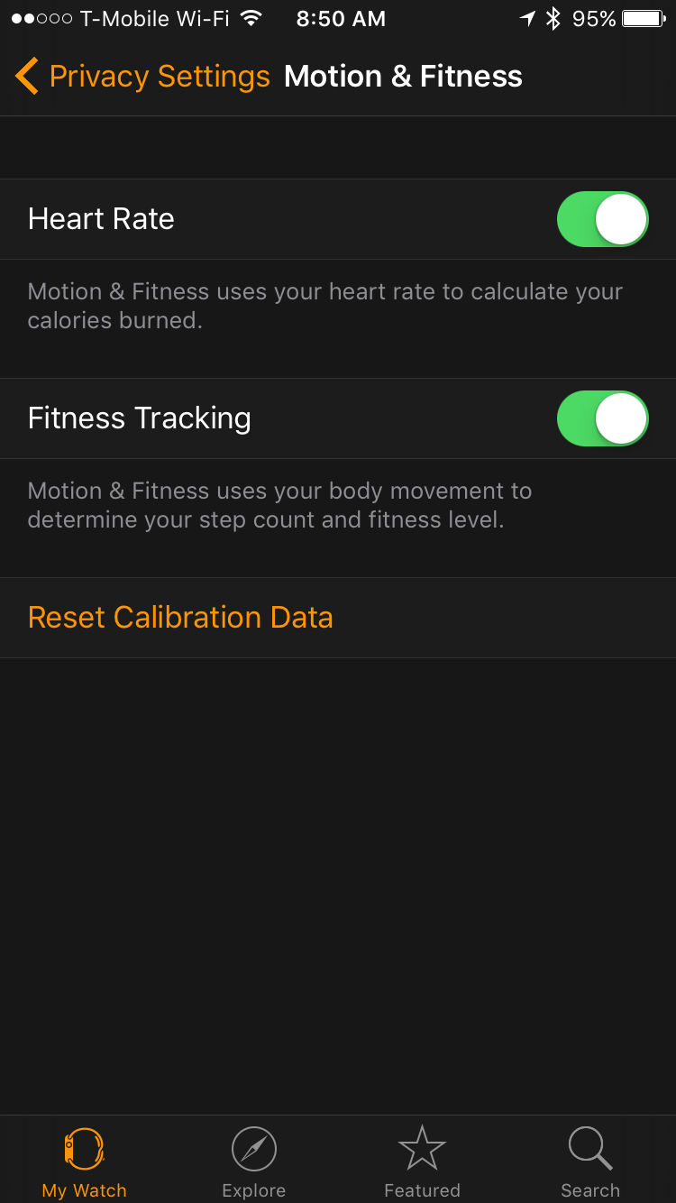

Apple fixed this. They gave us a "Reset Calibration Data" link in the Motion & Fitness section of the Privacy Settings in the AW phone app. Hooray.
Great! Now you have lots of options. Is the accuracy better for you now?
