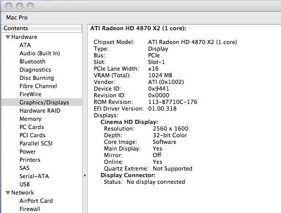

So I installed the latest build. (Thank you Netkas!)
My 4870x2 (Visiontek) booted up...but....QE/CI not running.
Also...how does it know that it only has 1 Core?
Very good progress.
It is possible that I still have a semi-patched EFI ROM on this from when that ****** claimed this was possible via ROM.
But I don't think that should DISABLE QE/CI?
Also, I have managed to get an OEM 4870 (yes, with the MDP port)
The OEM card boots up fine with this package installed, so Natit isn't killing it as in past.
I can do some testing later...going to a meeting in near future.
Let me know if anyone needs anything tried out or any IOPCI reports from whatever card.
by default qe/ci is not supported on 4870x2, you need to install patched kexts, find it here - http://www.insanelymac.com/forum/index.php?showtopic=161742
I added (1 core) to model name, so peoples will not think crossfire working on osx (its not supported), basicaly, all information you see about card in system profiler - all I set via natit.
I'll try to improve natit later, so it doesnt set keys for card which already has them (aka card has efi rom), then it will be more universal.

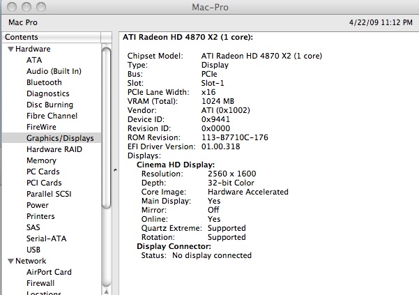

Patched kexts did bring up QE/CI.
Yay !
However, running the OpenGl View tests show performance is at about 60% of a normal 4870.
(usually scores around 1500-1600.....now at 900)
So something is still not quite right.
Happy to keep testing.
