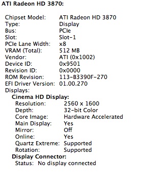

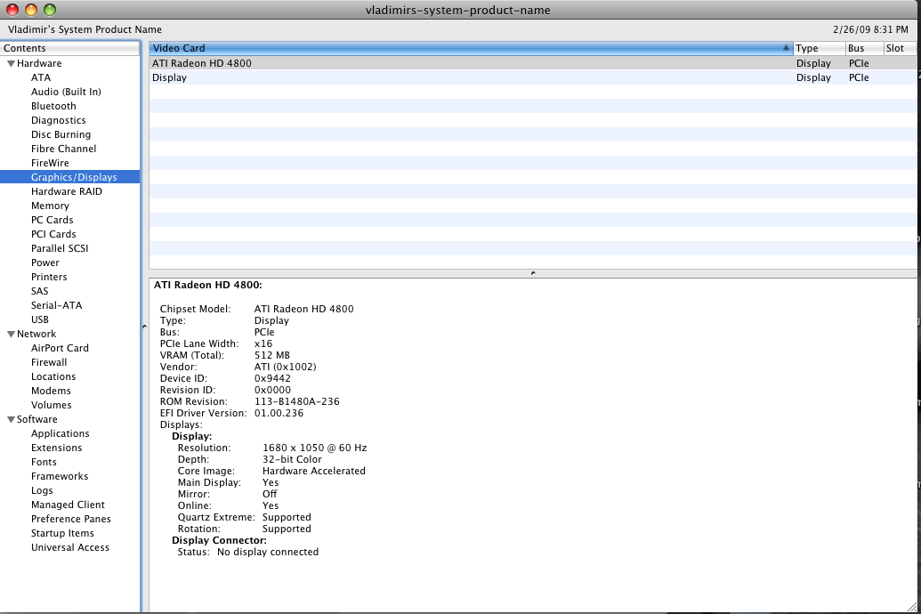

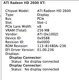

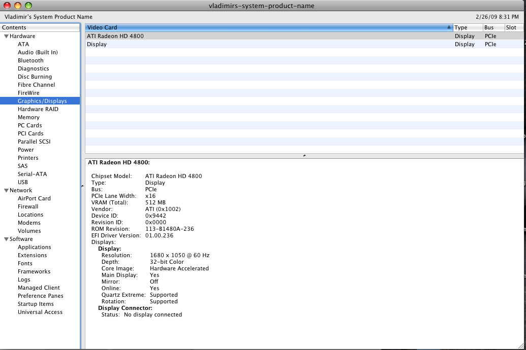

Meanwhile, I noticed something interesting in the netkas screenshots....the ROM and EFI version are EXACTLY those of a 2600XT.
And the System Profiler seems to indicate that there is another "DISPLAY" card in.

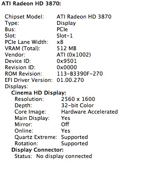

I have attached the screenshot he showed, plus ones from my 2600XT and a flashed 3870 I had lying around.
Seems odd that a kext could make the 4870 show up with a 2600 ROm number and EFI revision, but it does give one hope and adds to the excitement. If he made up the whole thing, then he went to alot of trouble to make up all those comments as well.
Netkas didn't make anything up, that I am sure of. He is a steadfast in the OSX86 community and the recent OSX86 progress would be lost without him.

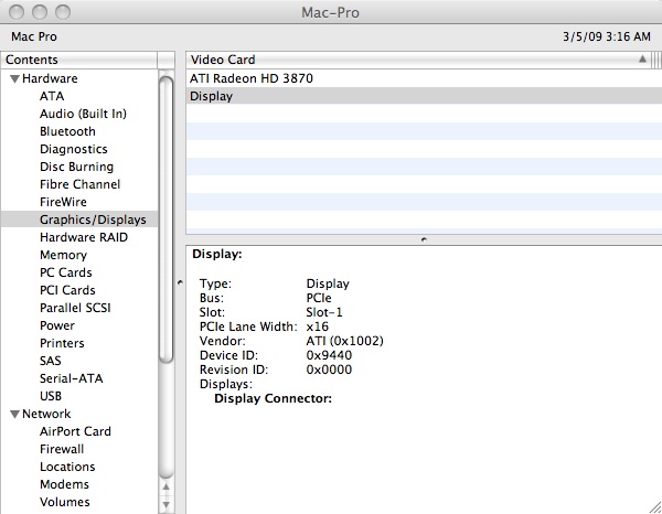

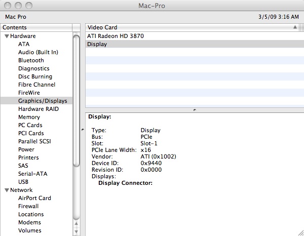

So,I discovered that the drivers pacjkage linked to in the thread at Netkas actually installs Natit kext as well as replaces several ATI ones.
Tried the above terminal command as well.
When I remove the Natit one, it will complete booting, but 4870 is just a "VGA Compatable Display" with id of 9440.
I looked at infoplist of one of those extensions and there was no 9440 as a device id to match too, so I added. Still no dice.
