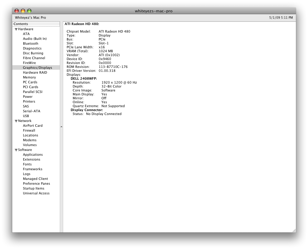

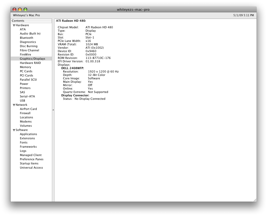

its working netkas!!! O MY GOD ITS WORKING!!! I will post screenshots right now. Moving windows its a bit laggy i think..and movies not playing 😛

Sure, 4890 needs patched x2000.kext, you guys can get it here - http://www.insanelymac.com/forum/index.php?s=&showtopic=160253&view=findpost&p=1142196
and install with kexthelper (only kext, bundle/plugin arent needed)
seems like i made typo in natit and 4890 has name 480, will fix in a bit.

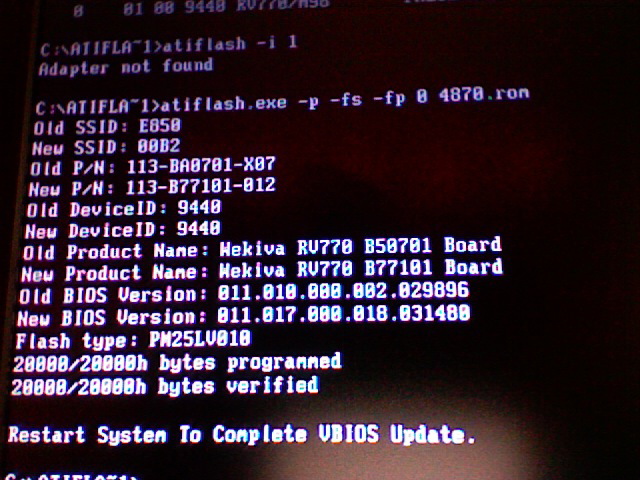

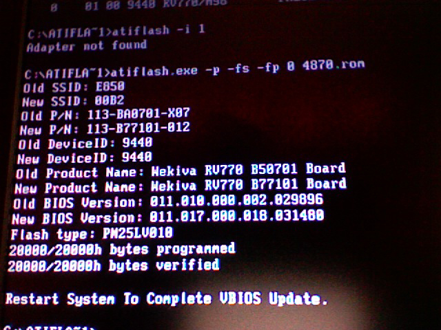

Don't work flash 🙁
I everybody,
I have buy a Sapphire ATI RADEON HD 4870 512Gb.
PN 288-10E**-***** SKU#11133-03
I have ATIFLASH360
I have 4870.rom of this page : http://netkas.org/?p=90 target=
But after my ATI was flashed with this firmeware, i have this problem :
I have no signal on may screen, and it is the same thing with an another graphic card (ATI HD2600:apple:) if my 4870 is in my macpro.
I have tried to put the 4870 in slot1 and 2600 in slot2 or the 2600 in the slot 1 and the 4870 in the slot 2, it is the same thing : no signal, like my screen is power off 😡
This is my screen during my flashing card.
There is an other rom for this card?
thanks a lot.

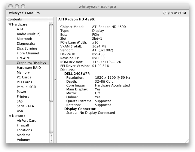

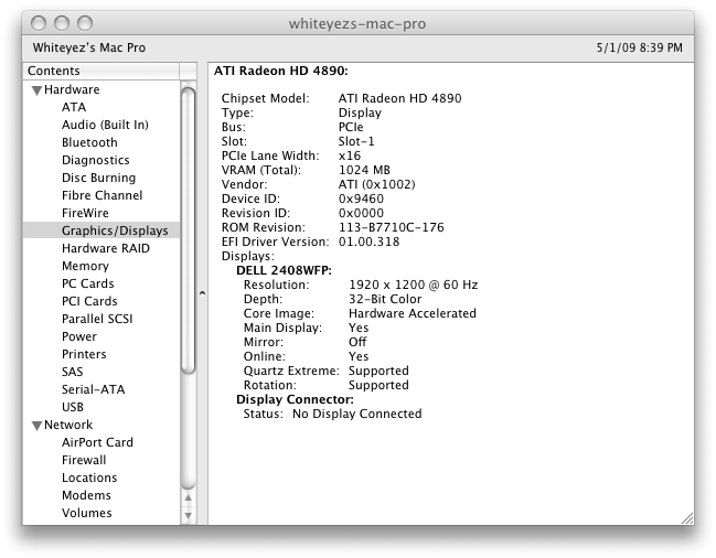

Thank you netkas i also confirm that its working fine.
Can you look at the PCI Card section of System Profiler and see if the link speed for the 4890 is 2.5GT/s or 5.0GT/s? Just curious if it's different than the 2.5GT/s we see on all the flashed 4870s.
