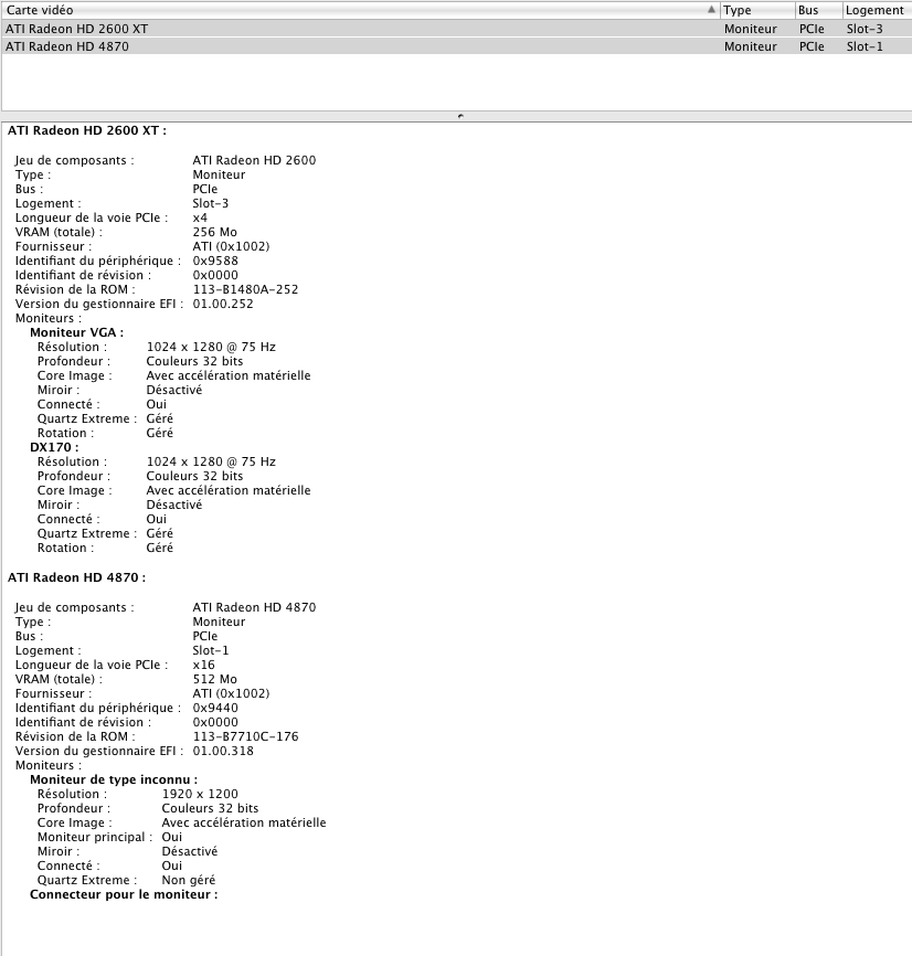

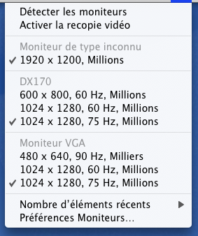

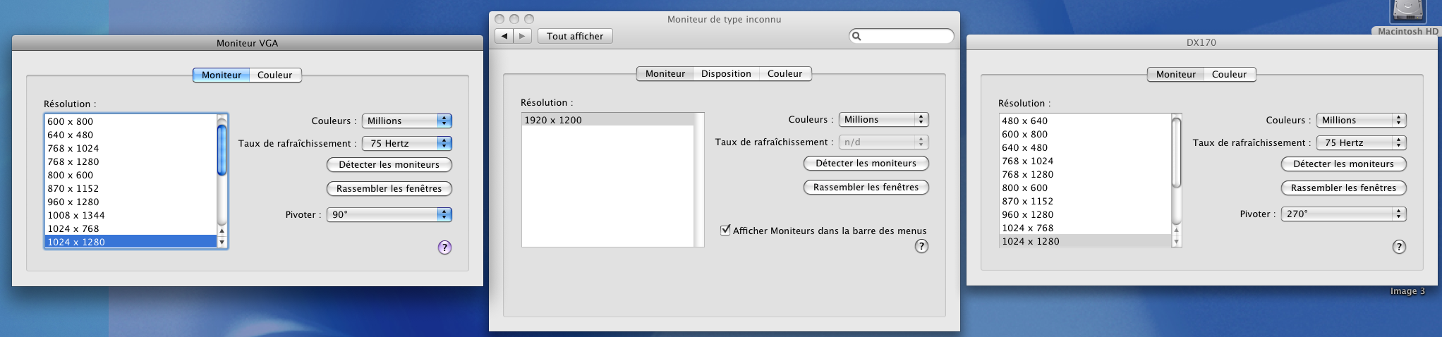

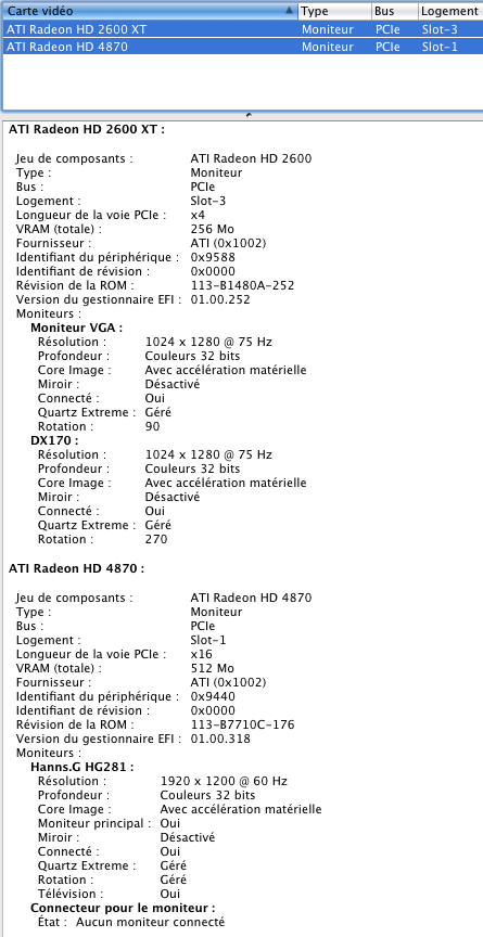

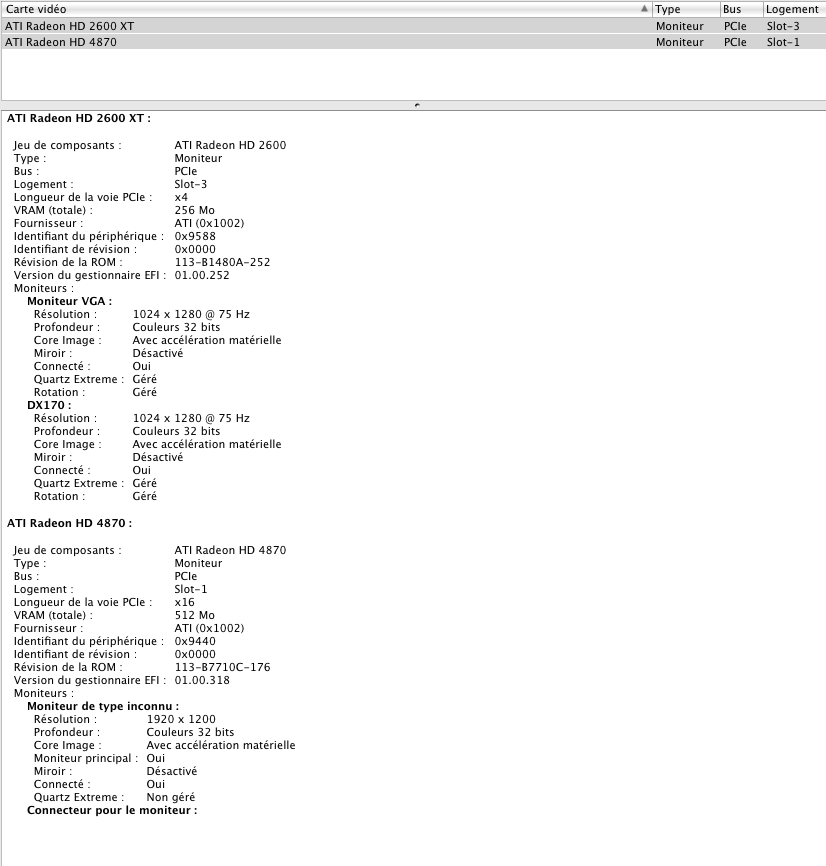

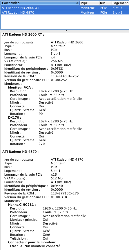

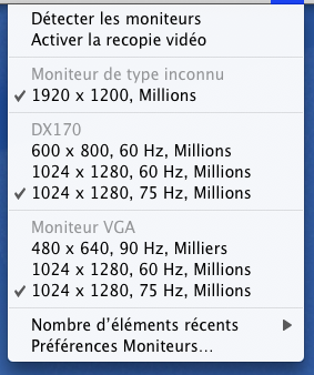

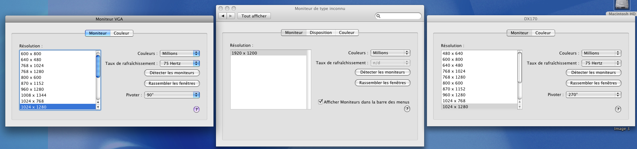

Hi everybody,
I have just custom my ROM with the 4870.ROM & my rom of my ATI (HD4870 512M SAPPHIRE) and flash it.
I have the monitor HANNSG HG281D, but my 4870 not detect this monitor but just "unknow monitor" and not détect its frequency.
So I have less frequency on this monitor than an other monitor on the ATI HD2600
But If I plug my HANNSG on the HD2600, my monitor is detected.
So, I'd like to know if anybody even meet this problem ?
And I would like tested the perf of my installation so anybody know a graphic benchmark for MacOSX?
Thanks

That you lost your monitor's name and its refresh rate does not seem a big deal, as long as it woks at its native resolution and refresh rate (right?). I suppose it is an LCD (since the flashed card will not output analog video), so you don't want to change its res or refresh rate. It could be problematic in games, though.
You may try several tricks: connect you monitor on the other DVI port, add a DVI to VGA converter on the upper DVI port (but no display connected on it), remove the HD2600... and see what it does.
For benchmarks: try cinebench and glview.

Ok , I'll try that tomorow,
But instead, I have installed the pilote : MacOSX_10.5.6_radeon_hd_48x0_drivers.pkg
And when I reboot my three screens are blue with black lines !!!!!!😡
Is it normal that my 4870 works without driver and dont works with driver?!😕
Thanks

try switchresx to create modes u need.

The unrecognized display and refresh rate may be due to the lack of drivers. Try reinstalling them, repair permissions... or alternatively wait for 10.5.7, which should be around the corner.

Are you running on a hackintosh or a macpro? I was under the impression that on true blue macpro's that the initial package supplied here of the drivers had a natit.kext that barfed when the 2600 was present (thus you wer instructed to not install on macpros). In short macpro did not need the natit.kext and in this instance was detrimental. This was in prior early instructions if I recall.
So... try removing natit.kext and see if that helps (if you are on a macpro).
Ok,
I'm on MacPro 2008 2X3ghz MacOS X.5.6
HD 4870 on slot1
HD 2600:apple: on slot3 (for a beter ventilation)
Yesterday I have installed the driver, and befor the reboot, I removed the natit.kext, and after the reboot : Bleu screen+black lines
After :
Format DD
Reinstall MacOs10.5.6 = OK
Install driver without remov natit.kext = Bleu screen+black lines
Remov the 2 VGA screens on HD 2600 = Bleu screen+black lines
Remov the 2 adaptators on HD 2600 = Bleu screen+black lines
Remove the HD 2600 = Bleu screen+black lines
Perhaps a bad driver? It come from this tuto : http://web.me.com/jacobcroft/4870Flash/4870Flash.html
Is it normal that my 4870 work without driver but no with driver?
Thanks

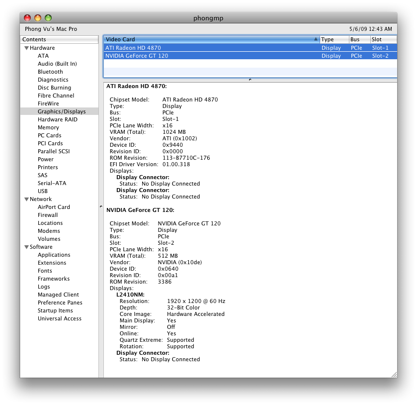

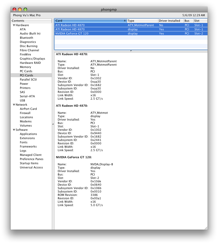

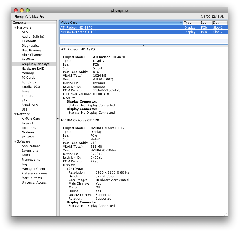

I need help please
Hello Mac fellows!
I followed this tutorial to flash my card:
Everything went perfectly, only the last part, when I shut down and plug my monitor to the new card and restart, The startup screen shows up with the Apple logo and the loading spinner. After that the monitor went black and my Mac pro continued to load into Mac OS X with completely no signal to my monitor. I plug out and connect my monitor to the old card and everything went normal, the display worked just fine. I tried connecting different ports on the new card but nothing happened.
I looked into System Profiler and saw that Mac OS X recognized my 4870, is just that it doesn't have any signal to the monitor.
I plugged my monitor into the new card and load up Boot Camp. everything went smoothly. Windows recognized my card, drivers installed and everything looked perfect, games ran fast. So I think my card is working fine.
Any help to get it working, thanks.

My problem is solved
Hi everybody,
I have found the solution of my problem.
That was that my original DVD:apple: of MacOSX was 10.5.4 and not a 10.5.6
So I have formated my HD, installed MacOSX with the DVD:apple: and updated MacOSX10.5.4 to 10.5.6.
After, I have installed the driver and all is right.
All screens, all résolutions and all frequencies are detected.🙂
My benchmark are ok too.🙂
Thanks everybody

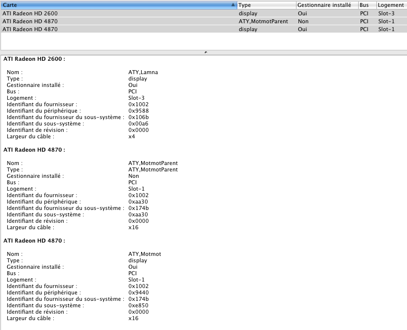

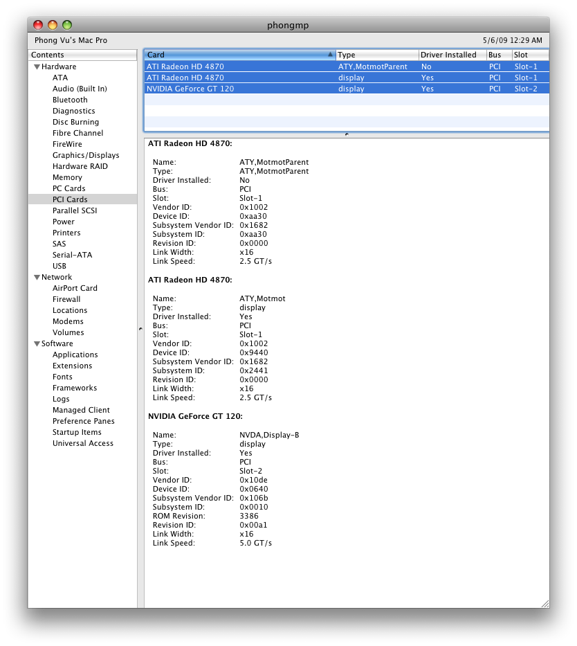

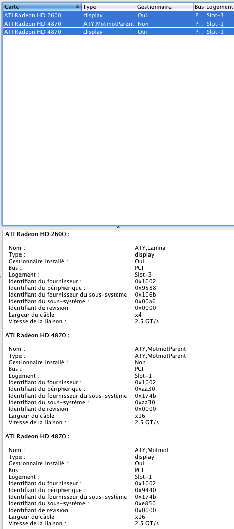

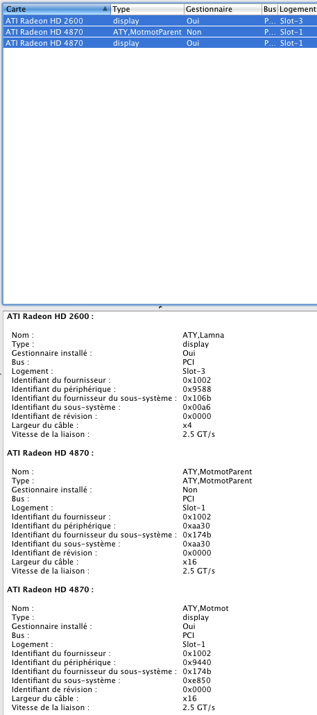

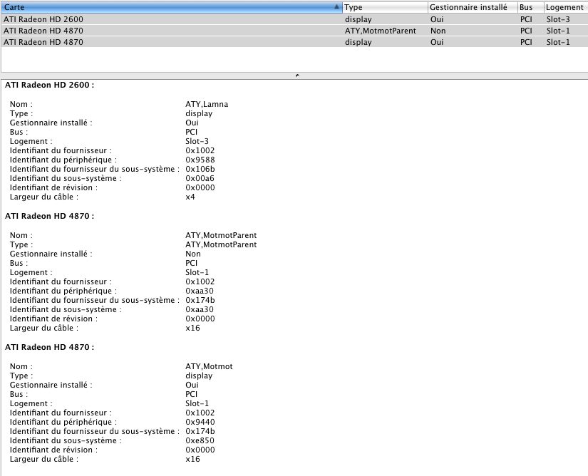

Just a last question : Why, two 4870 cards are detected? 1 ATY, Motmot and 1 ATY, MotmotParent?😕
Why are two cards detected? I am not sure, but this does not happen on the original 4870s, only on newer cards which apparently have a different design. I suppose this has something to do with the absence of signal from the upper DVI port, no VGA output, lower link speed, etc... as we could only get one half of the card to work.
Interestingly, it seems that the 4890 cards than can be made to work without flashing, but with ATI_init and modified kext's do not suffer these problems.
As reported on Macbidouille, they work correctly, except for the upper DVI port, which is single-link only (but this may have something to do with the fact that the apple card has a mini displayport).
How could un-flashed 4890's work better than flashed 4870's, with should be more similar to apple cards? 😕
Phong: be sure that you flashed the exact same card as the one in the tutorial. If not, I would suggest that you flash it with a custom ROM.
However, since you see the gray apple logo, I guess that the flash went OK, but that you have driver problems. Be sure to install drivers on OS X 10.5.6, repair permissions, or wait for 10.5.7.
Yes, i bought the exact same card. Ans mine is 10.5.6; and what do you mean by repair permission? You meant repair permission in Disk Utility?
