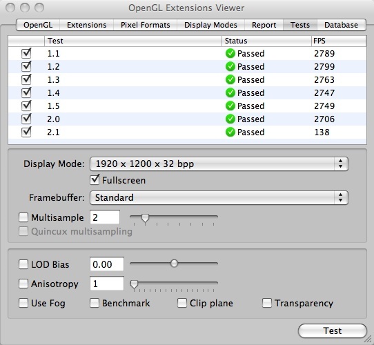

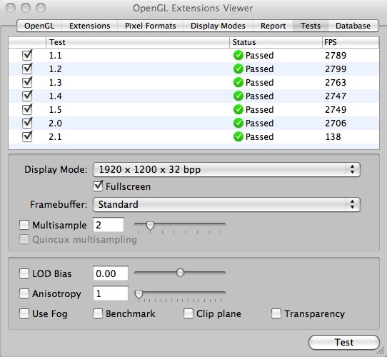

Another 4890....
Got an MSI 4890 today (would swear it was supposed to be an XFX...)
Had some difficulty getting everything installed. (needed Natit, Exotic Cards patched X2000, and ATI-init) but now it is working.
FWIW...while the iGig 4870 with slightly higher clocks scored nearly identical to OEM Apple 4870, this new 4890 blows them both out of the water on the OpenGl Viewer....past scores @ 2560x1600 were around 1500 for most...now at 1700.
Interestingly, I was able to get 9800GTs to do this same score in past in OSX...so we still have some driver growth coming, I hope.
So, a 4890 working in 10.5.7 using Natit's method.
Now to play with the ROM.........

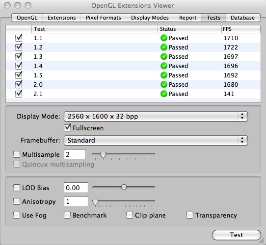

Can you test 1920x1200 for me as a comparison? I am seeing 2,500 range on the tests with the Sapphire 1GB HD4870 at 1920x1200.
