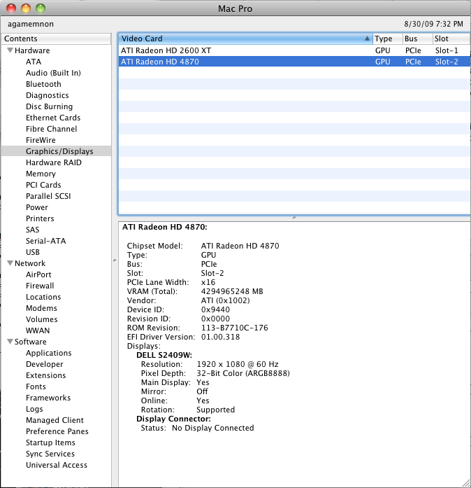

Actually, I do have a VGA display, and I tested with it. I have 2 24" LCDs, one with VGA and DVI, the other with HDMI, DVI, and VGA. Tried connecting both, via VGA and DVI, and with various adapters.
I had given up on the 2gb 4870 card, but left it installed in my Mac Pro. However, after installing the 10.6 upgrade, I noticed that something was different. (Screenshot of System Profiler attached)
I then attached a DVI monitor, and voila! The display works, and I'm looking at it, as we speak. Also, when I attach a VGA display, or an HDMI display, the screen now switches on and off, as OS X usually does when a new display is connected. So, it seems like all 3 inputs are recognized, now, though only the DVI input actually works.
Also, the amount of VRAM is obviously wrong, but that's no big deal.
Any suggestions to try to move forward on the last couple issues?
Thanks!

Ajacocks, have you tried injectors? It's cool that somewhat improbably, SL is making all the 4870s work better, but nobody's gotten VGA or HDMI to work out of the box as ports like that yet. Maybe injectors in SL will enable you to use HDMI?
