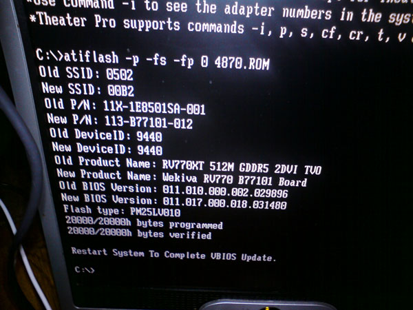

Ok I busted out the MP 2x2.8ghz Octo I just got and... same thing.
So it's not a MacPro1,1 issue I'm having. This board just looks like it may not work for some reason.
I have reflashed with the original firmware and put it back in my Vista PC and Vista is back up and running with this card just fine.
I'm not done messing with it yet, but so far things aren't looking good.
More info:
I reflashed this card back to the stock rom and just FYI, here is what the output of an 'atlflash -ai' looks like
Code:
	Adapter 0		(BN=01, DN=00, PCIID=94401002, SSID=0502174B)
		ASIC Family		 :  RV770/M98
		Flash Type		 :  PM25LV010	(128 KB)
		Product Name		 :  RV770XT 512M GDDR5 2DVI TVO
		Bios Config File	 :  1E8501SA.002
		Bios P/N		 :  11X-1E8501SA-00
		Bios Version		 :  011.010.000.002.029896
		Bios Date		 :  09/08/08 06:32
I flashed by running: (renamed 4870.rom to appl4870.rom)
Code:
atiflash -p -fs -fp 0 appl4870.rom
Old SSID: 0502
New SSID: 00B2
Old P/N: 11X-1E8501SA-001
New P/N: 113-B77101-012
Old DeviceID: 9440
New DeviceID: 9440
Old Product Name: RV770XT 512M GDDR5 2DVI TVO
New Product Name: Wekiva RV770 B77101 Board
Old BIOS Version: 011.010.000.002.029896
New BIOS Version: 011.017.000.018.031480
Flash type: PM25LV010
20000/20000h bytes programmed
20000/20000h bytes verified
Then I ran atiflash -ai (After flashing with appl4870.rom)
Code:
		Product Name		 :  Wekiva RV770 B77101 Board
		Bios Config File	 :  S3B77101.012
		Bios P/N		 :  113-B77101-012
		Bios Version		 :  011.017.000.018.031480
		Bios Date		 :  01/06/09 16:27
I manually typed all of this so there may be a typo somewhere.
