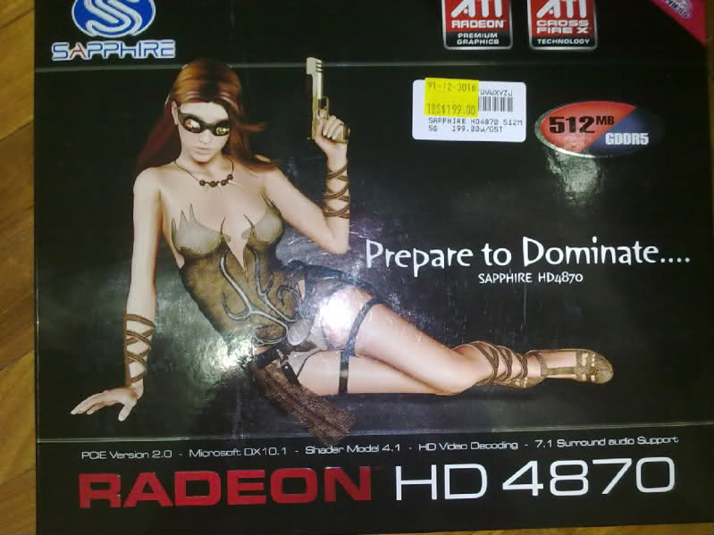

Does anyone has success with the below card? I don't see anyone with the same PN and SKU# with search from this thread.
PN 288-2E131-000SA
SKU# 11133-20-42R
I would like to confirm it works before I buy. Thank you
