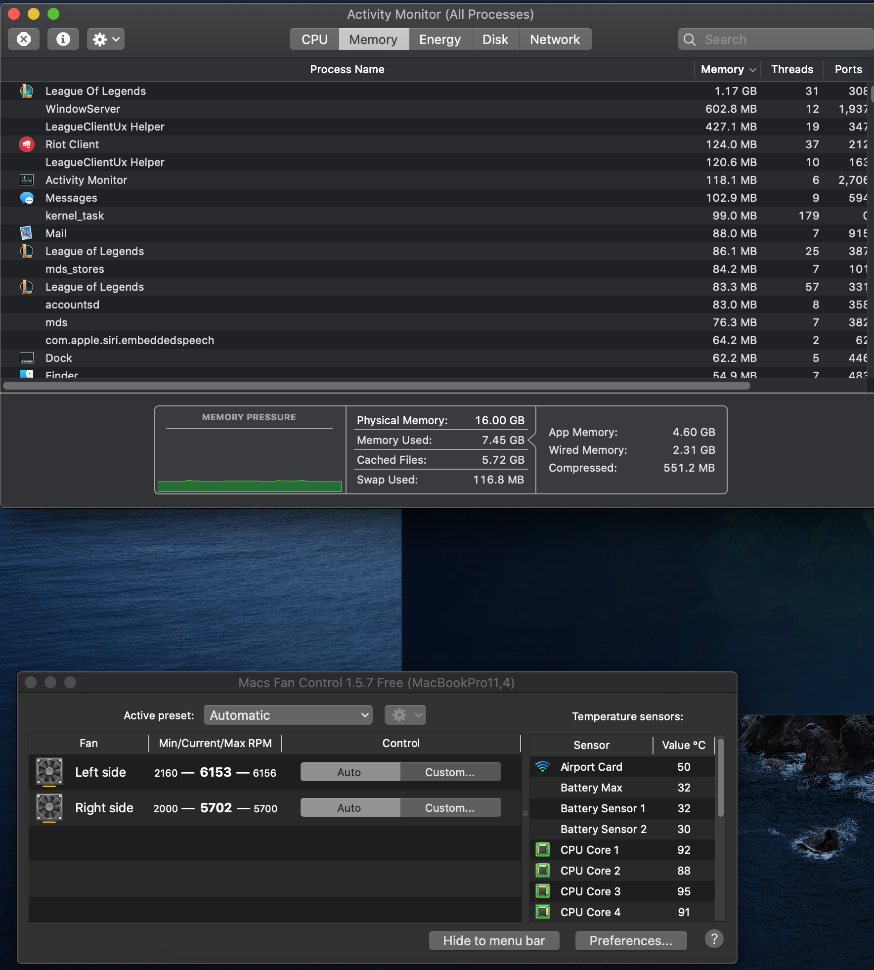

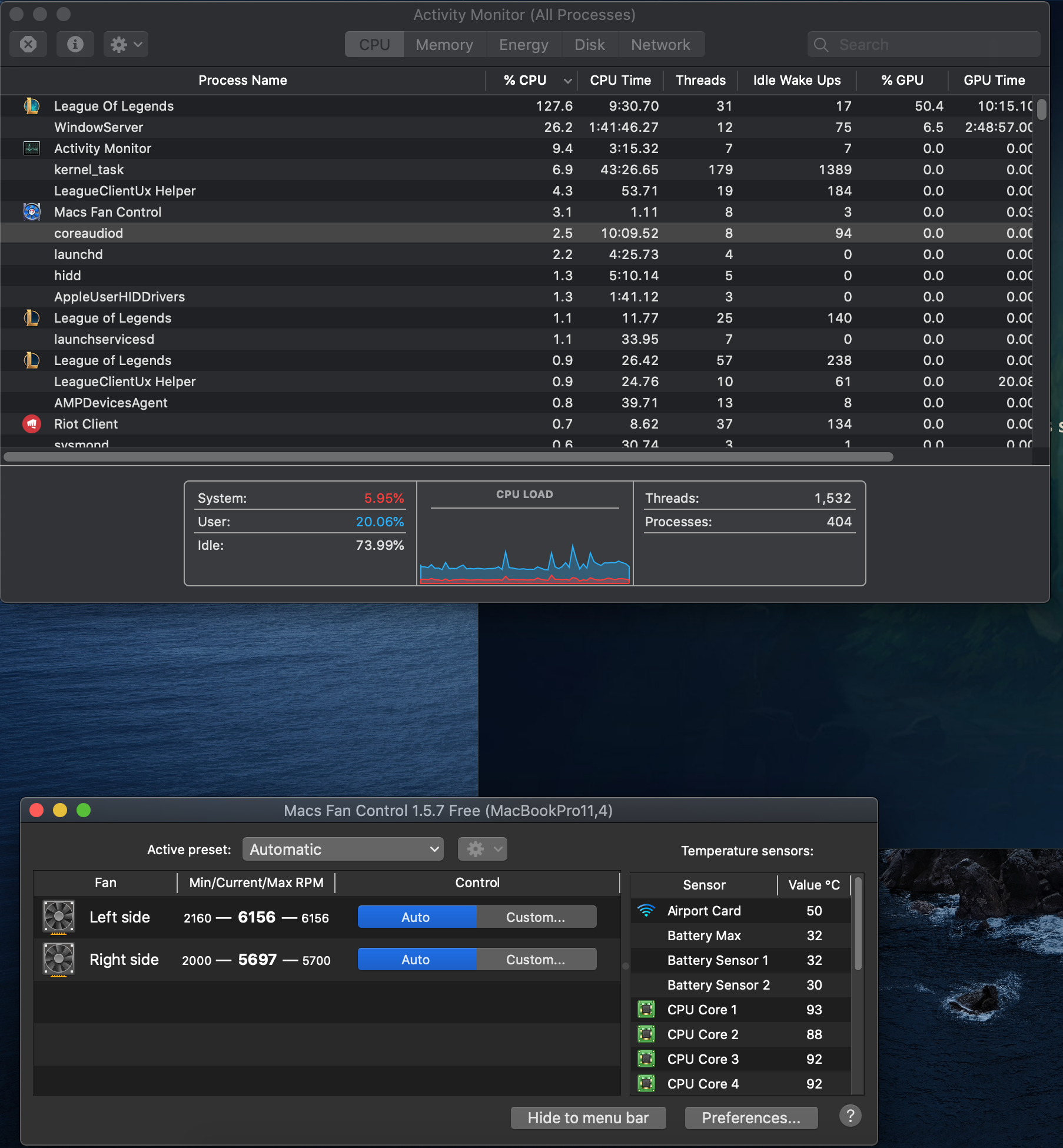

Oh k...did a little cleaning and nothing much has changed...its obv not my ram as i have checked enough times...it gets high as ~11.5-12 gb of ram in use at times.
i am curious as to what the numbers on activity monitor mean. i would appreciate the help

Just look at the memory pressure graph, it goes from green to red. If your system is struggling it would be red. As it stands, your graph shows it's struggling to use the available RAM - meaning you're not taxing the system at all.
In basic, apps use RAM to store temporary information for the CPU to run calculations, things like undo-history or anything that doesn't need be permanently saved. So the OS gives apps plenty of RAM so they have room, otherwise it would constantly be at the limit and you'd get stuttering.
When you open more apps that demand RAM, the OS will reduce these overheads to ensure that everything runs smoothly and the user doesn't notice any problems.
If RAM is either maxed out capacity (Very rare) or too many apps are requesting RAM, then the OS will start to move things onto the SSD (Which is slower to access, but if the user notices a few seconds it's fine - vs. system crashing). This is your swap space.
So think of it all like a layered memory for your computer. Firstly, the CPU has incredibly fast RAM of its own, which is very limited. After this it moves to the system RAM, which is fast but still limited. After that it moves stuff to the SSD, which is slower but plenty of capacity. Your OS will work all of this out on the assumption that the user should never notice a system slowdown, or have apps crash due to memory - so it calculates the best scenario for you.
People get very obsessed and panicky about the RAM in their system and want to throw way more RAM at it than the system could ever handle. It gives people peace of mind having more RAM, but the system isn't using it. Your system is using half of the available RAM as it is, so buying a new machine with 16GB of RAM is still going to use 50%.
What is more likely your issue is either due to an older CPU or older GPU - check the system requirements of the stuff your doing and see if your computer matches these specs. If it doesn't, consider turning down settings, it will make things run a lot smoother.
So i havent seen my memory pressure go red yet..what are u seeing that makes u say its struggling to use the available RAM?

If you confident enough to attempt it, I would recommend reapplying the thermal paste to the CPU. If the CPU can't transfer heat to the heatpipe/heatsink/fan then it will thermally throttle and drop its clock speed.
Did it to my MBP 13 2015 a while ago - made a difference. There are plenty of videos around on how to do it.
Basically just involves removing the bottom cover, remove the heatsink from the top of the CPU, clean the top of the CPU and heatsink really well with isopropyl alcohol to remove the old paste, apply a SMALL bead of paste to the top of the CPU, reassemble and test.
Struggling may not have been the best word. He just meant that your computer is using only about half of its RAM as it is. On your memory picture, it says 7.45GB is used out of 16GB.
