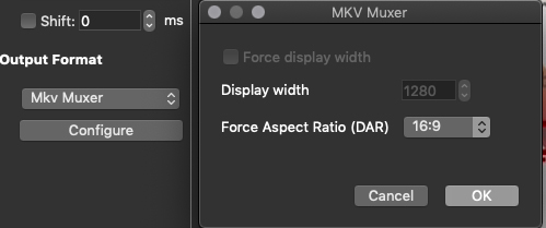

One question though, when saving the edited files, I can save some space by muxing it to .mkv. However, when I do this, I lose the aspect ratio. Loading and then re-muxing back to .ts brings the correct aspect ratio back (so I haven't lost anything) but I was wondering if you knew of a way of mixing to .mkv without losing the aspect ratio?
Output format - Configure - Force Aspect Ratio
My understanding is that, by "forcing" an aspect ratio, you bypass the apps's automatic detection, thus keeping your desired aspect ratio.
