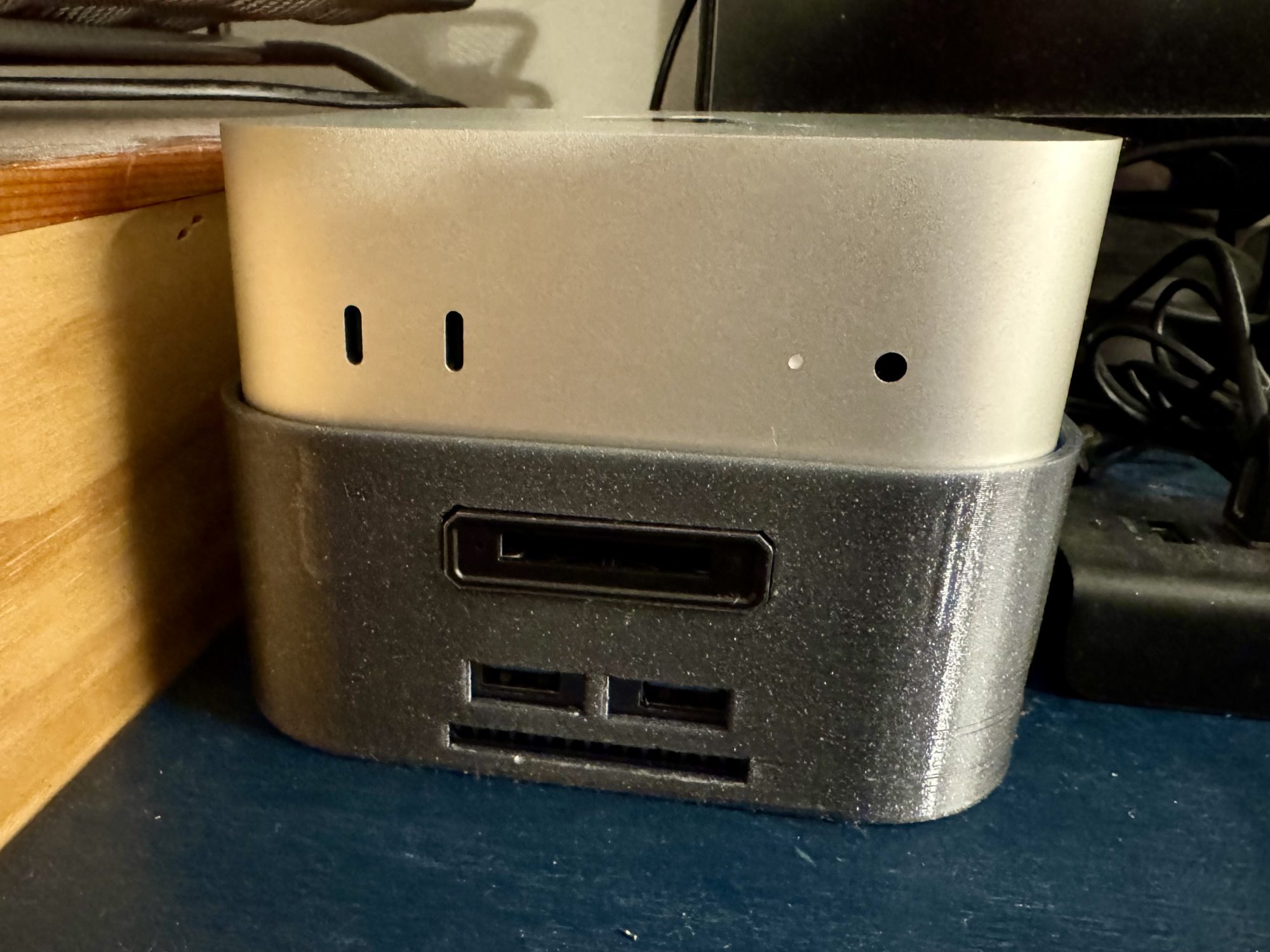

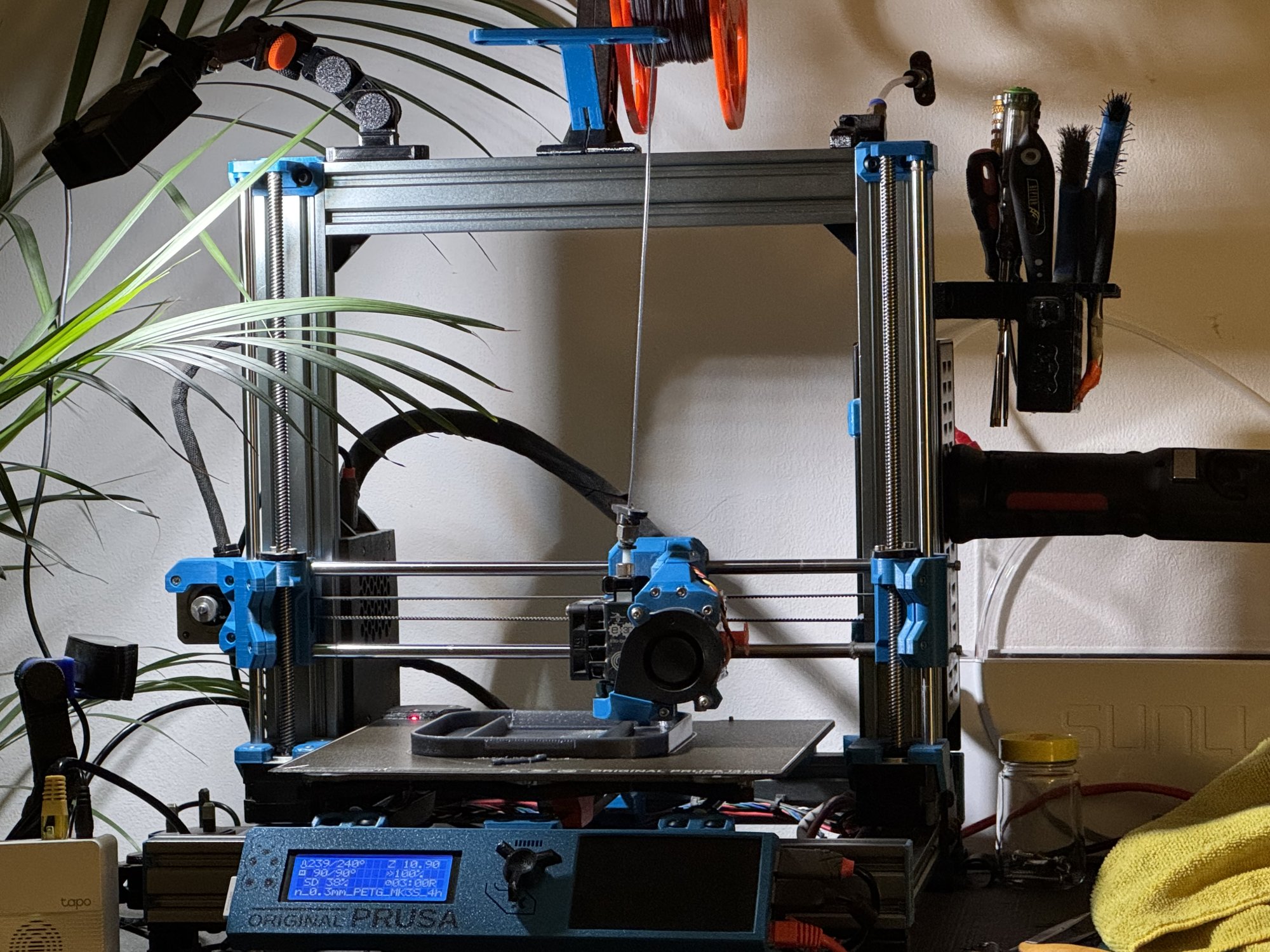

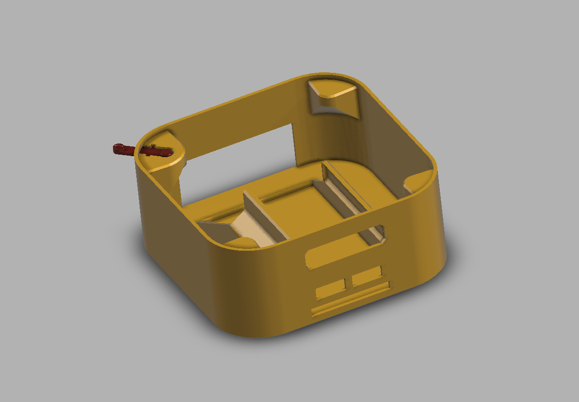

Work in progress, Apple Mini 4 Pro Enclosure, Acasis NVMe Enclosure and CFexpress card reader. Complete with Power Button. 2nd prototype, hopefully I’ll have success with 2nd Attempt? Printing now.
I‘m pleased how it came out, usually takes at least three prototypes to get it right.
