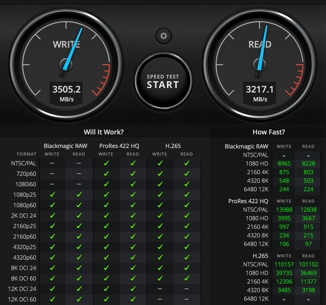

ALRIGHT! It's Black Friday week. Which enclosure should we be buying here?? I want the best possible chipset at the lowest possible price!

this is what i got on my first pass.
