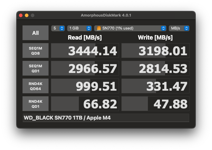

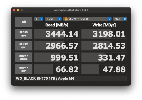

I’ve added a TB4/USB4 WavLink 40Gbps m.2 case and a 4TB Orico NVMe PCIe 4x4 (7000MB/s) to my Mac Mini M4. I changed the user folder to be on the external drive and the application directory to be on the external drive (changing external to be boot prohibits AI from working), so most work files will be placed there automatically. Read speeds are over 3.5k, writes about 3.1k on external. On the 256Gb internal reads are just over 2.5K, writes about 2.3k. So external is faster than internal! I plan to add a second identical ‘raided’ TB4/USB4 drive which should add about 1k to performance through striping. So with right hardware an external TB4/USB4 is actually faster than the 2 chip 256Gb internal drive. Until you get to a 4 chip config (1Tb) I think external will remain faster.
The drive and case cost $248(amazon) and I have 16x the base storage.

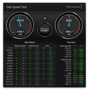

Got a decent SSD for the Ugreen through today. Not bad for £127 all in. Less than a third if the upgrade price to 1TB.
