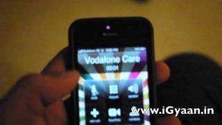

In a dark room, there seems to be a very visible red dot next to the speaker. Its intensity actually changes (increases when I touch the screen) and dims when not. Turns off completely when screen is off. Anyone experiencing this problem? It seems like a light leak into the infra red sensor? Anyone else seeing this?

It's the proximity sensor

If you have Siri enabled, Raise to Speak will keep the proximity sensor on, thus the red dot will be on. The iPhone 4 doesn't have Siri, so it's only on during phone calls.
It may be that the manufacturer Apple chose for the proximity sensor gives off more red light than the one in the iPhone 4. Either way, it's completely normal. Your iPhone is fine.

I see the same thing as well. I don't think it's light leak even though it does go off when the screen goes black (I tested it via phone call/proximity use). For me it is not any brighter when screen brightness is way up vs low. Additionally, on mine it fades out if I don't touch the screen. When I touch the screen it comes on and fades out slowly over a 2 second period which wouldn't happen if it were light leaking from the LCD through the ir sensor hole (I'm guessing that's what you mean by light leak into the sensor).
Ultimately the answer on whether its defective or not depends on how bright yours is relative to normal. As mentioned by others, people's ability to see different colors (any color, whether this is light leak through the ir filter or the ir illumination itself) differ from person to person. This is one of those cases where you need to look at other iPhone 5s and see if others are better or not. If they're all the same, then either live with it or get a different model/brand phone if it is a distraction.

Just to inject some scientific approach, I've used my spectrophotometer to measure the light coming from the proximity sensor emmited by iPhones 4, 4S and 5. The peak for the iPhone 4 and 4S are almost identical at 871nm and 867nm respectively, while for the iPhone 5 is 842nm, so it's shifted 25nm down. So there seems to be a difference in the iPhone 5 towards shorter wavelengths. I don't know if this shift is enough to bring at least part of the spectrum into the range of some people's vision, though. At least the shift is in the right direction to make it plausible.
These are the spectra for the 4S vs 5:
