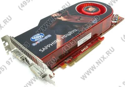

Hello, I have read these various threads as best as I can. I'm not overly technical minded. I'm able to acquire an ATI 4870, which appears to be this card:
Code:
ATI Reference 4870 (512 MB)
Sapphire 1st Gen 4870 (512 MB) (102-B50701-10-AT)
Sapphire HD4870 512M GDDR5
PCI-E DUAL DVI-I/TVO
PN 288-XXXXX-XXXXX
SKU# 11133-03-20R
..as the SKU# and other info matches. I am able to get this card for a limited time from someone locally. My questions are as follows. Is there any likelihood that despite have the same SKU and appearance that his is a newer card that will not work? Also, in your Flashing Tool it states that this card as a "Power Warning" issue, has any way been found to remove this, and if not is it a major issue? For anyone who knows, how is the fan noise on this card compared to say a stock 2600? I ask because I often need to record audio in the same room as my Mac Pro. Last questions, if you will, will it just be better to just look for a 4890 card, and if so...why?
I consider the 4870 since it is "closer" to the "Apple version" and so not to have to add the identifying file for the 4890 on every OS update. Again, I'm not very technical with computers, but I'm willing to take a chance with flashing the rom. Incase the info is needed, I'm use a version 3.1 (2008) Mac Pro.
Please, excuse my English, it is not my first language. All help is welcome. Please? 😛

Since that is a 512 MB card, you can not use any roms in the ROM folder (they are for 1gig)
but since it is a reference model, you should probably have success with apple 4870 rom.
just like Mark Booth did here:
https://forums.macrumors.com/threads/661681/
he didnt link the ROM but you can find it if you search that thread.
edit:
that card has a modified fan. those cards have a history of being troublesome to get working. I would try to get a 1Gig card, only few $ more, but more performance and also alot bigger ROM pool.
