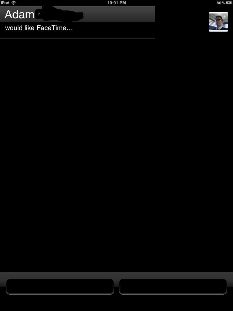

Ran it. Works almost flawless, but I can't answer calls. It just displays the incoming call screen with two blank buttons at the bottom that are unclickable. Also, i assume this has to be backgrounded with backgrounder from cydia to work without having the facetime app running?

No buttons or automatic backgrounding on the iPad. If I call myself, the iPad doesn't start ringing until I manually fire up the app.

It's a pretty stock iPad with not much in the way of tweaks except the usual (SBSettings, Gridlock). I attached a screenshot of the weird no button thing.
Are you able to navigate to your iPad's /System/Library/PrivateFrameworks/TelephonyUI.framework folder? Its where the buttons are located. Even though my script doesn't touch the buttons, something may be wrong with them. You should see a bottombargreen, bottombargreen_pressed, bottombarred, bottombarred_pressed, bottombarfire, bottombarfire_pressed, vc~AcceptVideo, and a vc~DeclineOrEndVideo files. If you don't, then something is rather wrong with it.
Also, do you have Winterboard installed?
No Winterboard. I did nail down the multitasking problem. Basically (and presumably because of the missing buttons), the app crashes when the call hangs up.
Code:
adamBook:TelephonyUI.framework adam$ ls -al bottombarred*
-rw-rw-rw-  1 adam  staff  1178 Oct 22 00:06 bottombarred.png
-rw-rw-rw-  1 adam  staff  1150 Oct 22 00:06 bottombarred_pressed.png
-rw-rw-rw-  1 adam  staff  1134 Oct 22 00:06 bottombarredfire.png
-rw-rw-rw-  1 adam  staff  2282 Oct 22 00:06 bottombarredfire_pressed.png
adamBook:TelephonyUI.framework adam$ ls -al bottombargreen*
-rw-rw-rw-  1 adam  staff  1217 Oct 22 00:06 bottombargreenT.png
-rw-rw-rw-  1 adam  staff  1163 Oct 22 00:06 bottombargreen_pressed.png
adamBook:TelephonyUI.framework adam$ ls -al bottombarfire*
ls: bottombarfire*: No such file or directory
adamBook:TelephonyUI.framework adam$ ls -al vc~*
-rw-rw-rw-  1 adam  staff   521 Oct 22 00:06 vc~AcceptVideo.png
-rw-rw-rw-  1 adam  staff  1205 Oct 22 00:06 vc~DeclineOrEndVideo.png
Edit:
Changing the bottombargreenT.png to bottombargreen.png fixed it! Though there is still a crash happening. After the call ends, either from accepting the call and hanging up or declining the call, the app crashes (which kills the multitasking). I dug around a bit trying to find a log which maybe could have helped you, but I couldn't find one.
I would also add that the script worked great up until the point where it tried to SSH into my iPad to change the permissions. I hadn't ever tried to log in via SSH on my Macbook before, so it asked me to confirm the RSA key. Of course, this broke the scripting, and I had to run it manually. I know how hard that would be to script though.
Thanks for all the hard work! Now I can Facetime myself!

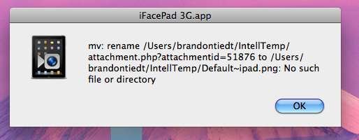

If someone can please help me out i have been trying for the last 2 days to get iFacepad working but keep running into a problem. I am running OSX 10.6.6 . I have all the files downloaded and saved to my desktop. When I launch iFacePad it i click the ipad buttom then it goes on and i select the ipod firmware . Then it hangs for about 10 seconds and gives me a message and when I click ok the app closes. i have no idea what is causing it but i was hoping someone here ( Intell? ) could help or new what the problem was. below is the screen shot of what i am getting. Thank for your help
I'm not sure what's causing that. But I'm working on iFacePad now so I'll look into this error.

I did fix the error. I was almost done testing when Apple released 4.3.1. So it'll be another few days as I test and find the proper keys.
