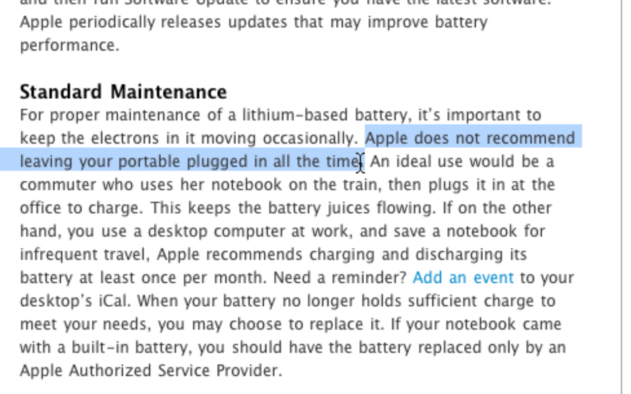

Apple recommend to have the laptop plugged in AS MUCH AS YOU CAN, and not to fully discharge your battery on a daily or weekly basis, but rather to do the calibration about once a month.
Off apple website
http://www.apple.com/batteries/notebooks.html
Standard Maintenance
For proper maintenance of a lithium-based battery, it’s important to keep the electrons in it moving occasionally. Apple does not recommend leaving your portable plugged in all the time. An ideal use would be a commuter who uses her MacBook Pro on the train, then plugs it in at the office to charge. This keeps the battery juices flowing. If on the other hand, you use a desktop computer at work, and save a notebook for infrequent travel, Apple recommends charging and discharging its battery at least once per month

apple recommend to have the laptop plugged in as much as you can, and not to fully discharge your battery on a daily or weekly basis, but rather to do the calibration about once a month.
not true
