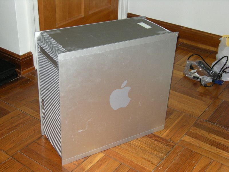

I found a picture of a G5 with the handles removed, for those curious:
oh NOOOOOOOOO
thats all i can say....
