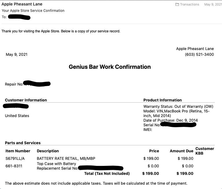

I have a 2014 MBP 15 and a 2015 MBP 15. I'm typing on the 2015 right now. I started another thread on battery bulging and replacement in this forum several weeks ago. The case was bulging so I replaced the battery - they also replaced the top case for $200. After I got it back, the Service Battery indicator turned on on the 2014 so I had the battery replaced on that one as well. Both of them are nice with the new top case.
I don't understand the $550 quote for a top case replacement unless they are replacing more than what they replace for the battery. With the battery replacement, you get the metal, trackpad and keycaps. I wonder what you get for the $550? You don't even have to do the replacement if you can live with an external keyboard. I do think that it's a good idea to do the battery replacement as I think that these will become obsolete by 2013 (last ones were sold in 2018 I think).

I think I can explain the pricing anomalies. Just today I learned all about this from the Genius Bar at the Apple store in war-torn Portland, Oregon. This info is for 2015, 13" retina Macbook Pro. But the same general idea probably applies to the 15".
My ESC key is broken. Applecare couldn't tell me over the phone what it costs to get a new keyboard; they made me go see a genius. Here's what the Genius told me (round numbers):
new keyboard $500
new battery + new keyboard $200
It only costs $200 if you need a new battery. But they're attached to each other, so you get a new keyboard for free.
Unfortunately for me, my battery, which has a cycle count of 1533, isn't yet failing. It passed the Genius' diagnostic test. So he couldn't give me the cheaper rate. So I walked away. Not worth $500 to me.
new keyboard $500

I just chatted with Apple rep. He said Apple does not provide parts for vintage machines and suggested using third party authorized providers. When I mentioned this thread he said he does not believe it.
Reactions: MBAir2010
Apple services Vintage Machines. They don't service Obsolete machines. The 2015 is neither vintage nor obsolete.
The 2015 is neither Vintage or Obsolete yet. The 2013 and 2014 Retina MacBook Pros are Vintage but battery service is still available for them as per Apple's official websites and per my recent battery replacement at The Apple Store for my 2014 Retina MacBook Pro.
I have a 2014 machine (vintage). I literally first chatted and now also spoke to an Apple rep. They said the same thing. Take it to a third party service.
