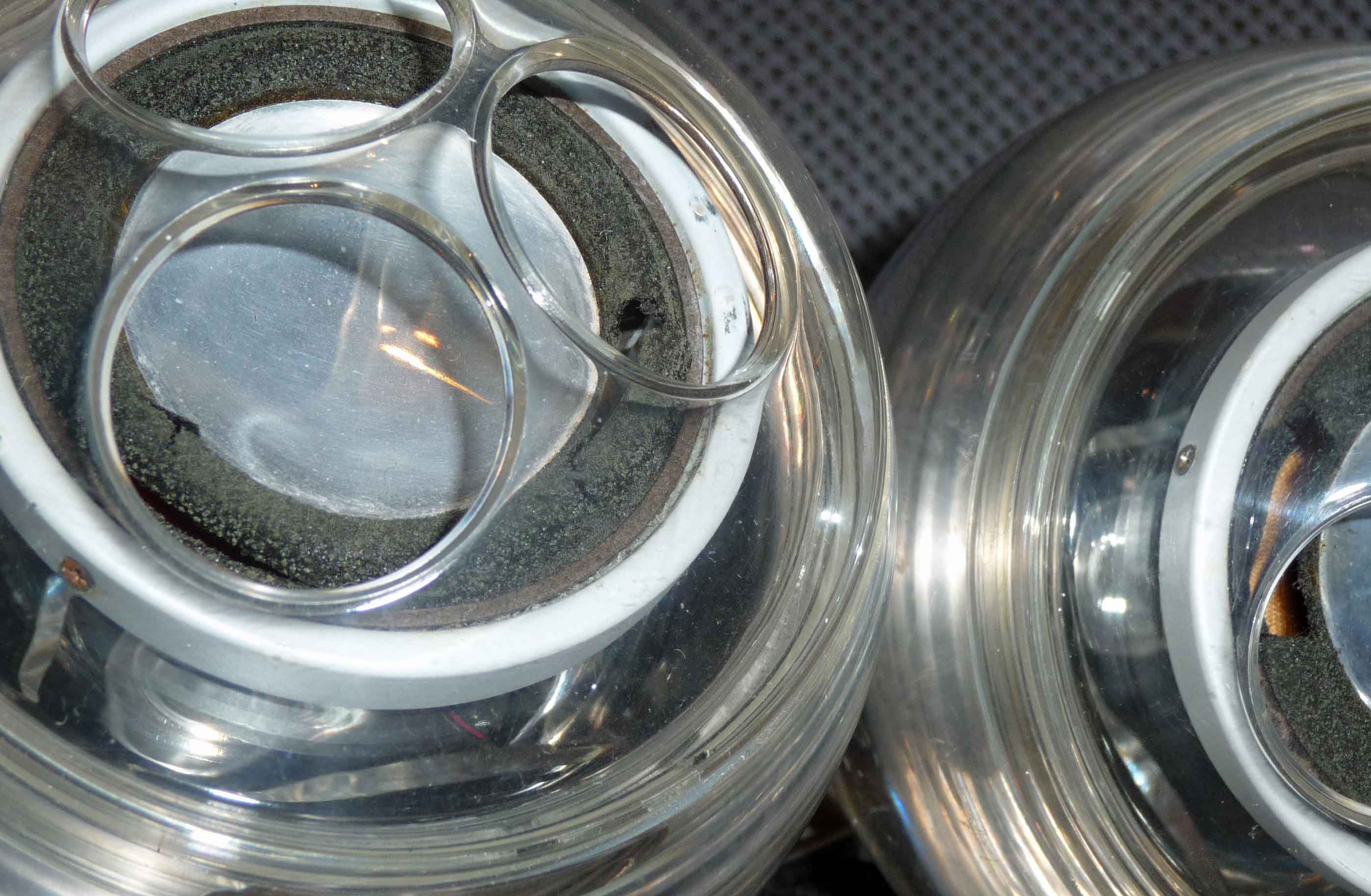

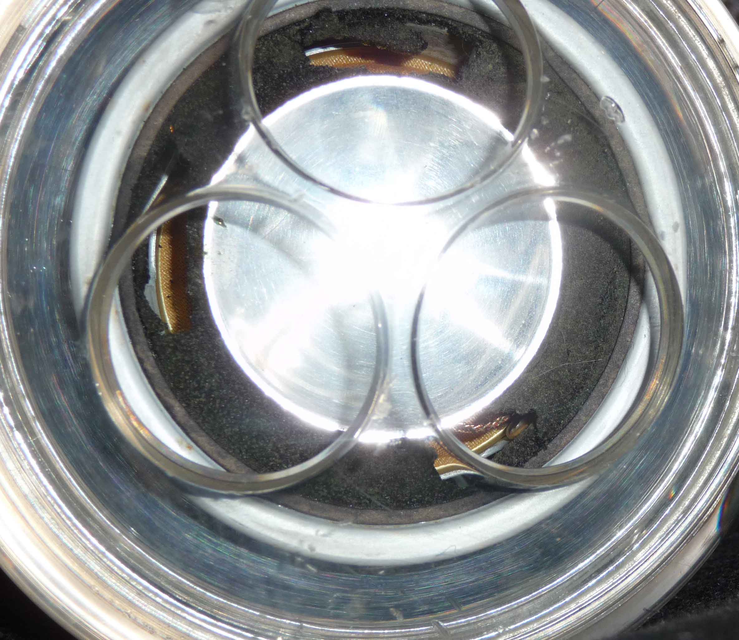

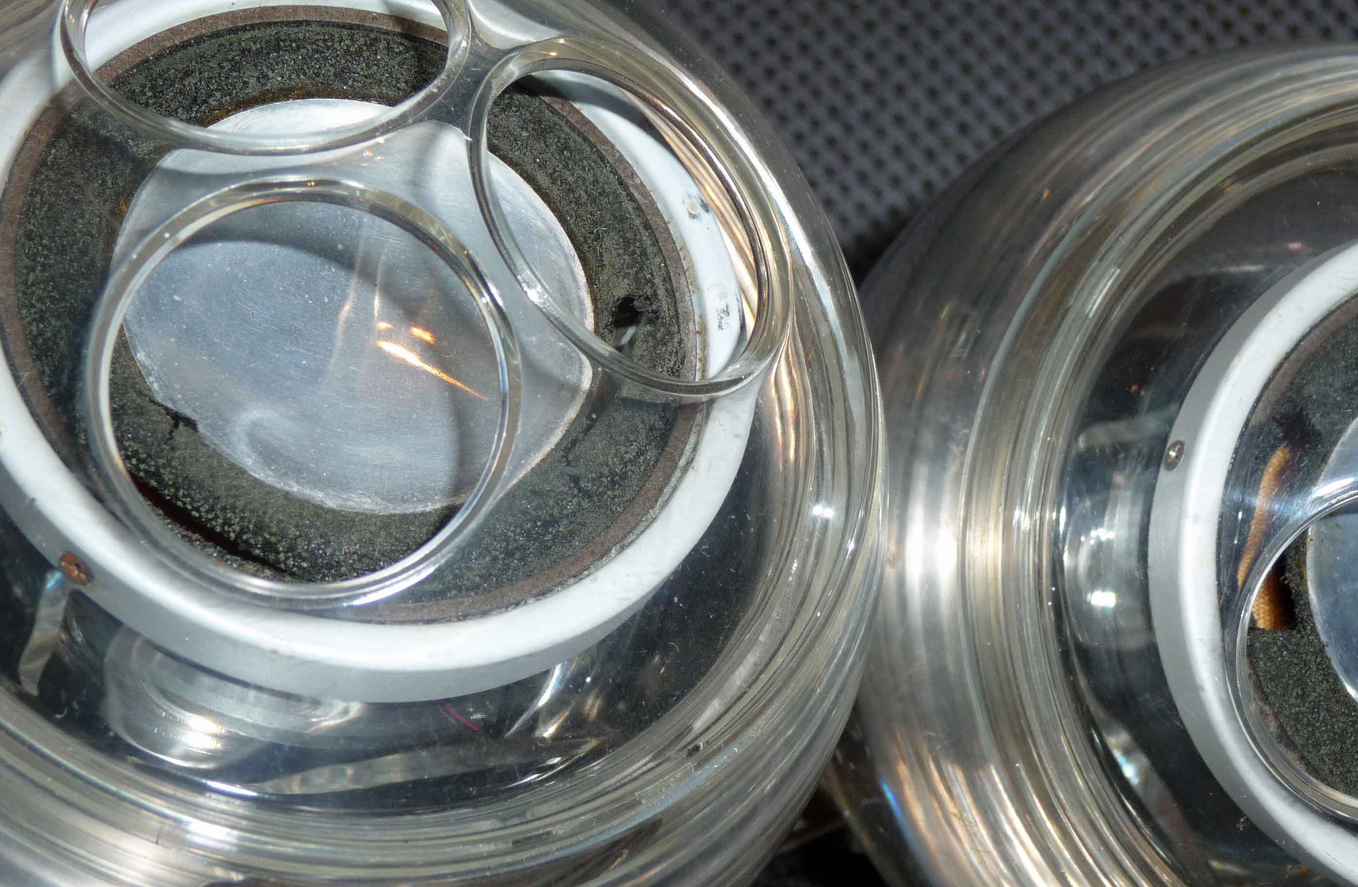

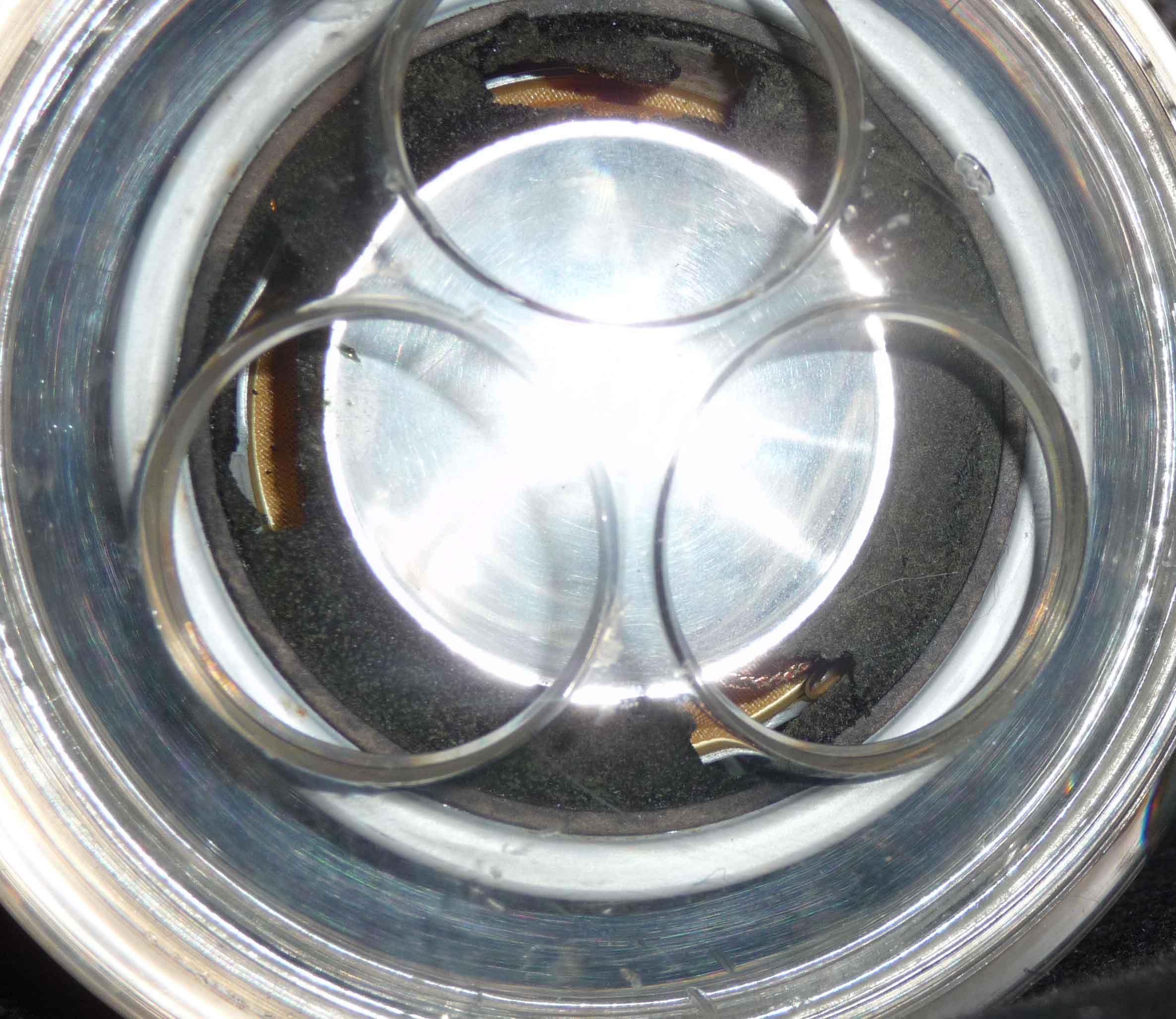

I see on a recent thread there is mention of speaker damage on a G4 Quicksilver, namely separation of a rubber membrane and tears of the speaker cone.
Which reminded me, I have a pair of G4 Cube speakers - model M7963 that are not aging well, and ideally need repair of the black cone material. (See photos below).
Has anybody here attempted such a repair? If so, could you please share what was the precedure, the material used, and was the final result satisfactory?

Wow that's some bad rot. I'd say get a surround repair kit but I'm unsure of where to get something that small.
Hmm, so on lesser damaged surrounds, (where the foam is not missing, just torn - & on 10" speakers) I've used brushed on dry-flexible rubber cement to sure them up with excellent (audibly silent) results.Those surrounds look pretty rough but at least as a stop-gap measure to stop further rot, I'd gently brush on a few layers of flexible rubber cement to the surround. Once shored up, to fill/address the gaps/missing bits, you could use some thin layers of something super thin like tissue paper. Cut them to fit, glue them on with the Cement, let it dry & then brush a few layers of the cement over that.
The above process is what I typically do to cone damage specifically. I've not tried it on the rubber/foam surround but if you're up for a project, you might give it a shot.
Good luck.
I think the best option is to replace the cone with those from a set of Apple Pro Speakers which used the white rubber. Its been pretty well documented as a great option which I intend to do on at least one set of my Cube speakers suffering rot like that.

I think I'll try RhianB`s suggestion first, and see how that turns out.
After posting yesterday, I did a more detailed web search and see there`s a clip somewhat similar to the one Hrududu referred to. That may be another solution, but would mean the purchase of additional speakers which I'd like to avoid if possible.
