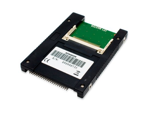

Yes you can use a CompactFlash drive in place of an iBook's internal hard drive with use of an adapter. They work rather well considering their limitations. I have one in my G3 iMac and it works very well with the card maxing out the iMac's ATA/33 bus speed.
You can, but it will be bootable only in open firmware. Or not bootable at all.
CompactFlash cards work like standard IDE/PATA drives when used with an adapter with the internal PATA bus for booting.

Yes. You use an adapter made to convert the CF connection to IDE and as long as you change the jumper settings correctly, if needed, then it works fine.
The adapters are on eBay, I found some by quickly searching "cf to ide 2.5". I'm not sure if some work better than others but here's a few:

as an iBook replacement, you'll need a 44pin IDE to CF adapter. lots around, ebay is full of them. some of the generic/board ones are flaky to use and hard to mount, you might try something like THIS as it mounts in place, and then you pop the cf card in, and you're good to go. i'd also mention that you might want to tape/glue the card in after you get done to secure it, as having it come loose and then needing to take the laptop all the way apart again would be a royal pain!
i had problems with cheap/generic cf cards, so i'd also recommend cards that are listed as dma or udma compatible or at least list the pio modes that are supported. better chance of getting one that will 'act like a drive'.

They even come pre-built in a 2.5" form factor like this one (which happen to be less expensive than 60MB/s UDMA CF cards).
Or you use an adapter and supply your own CF card.
