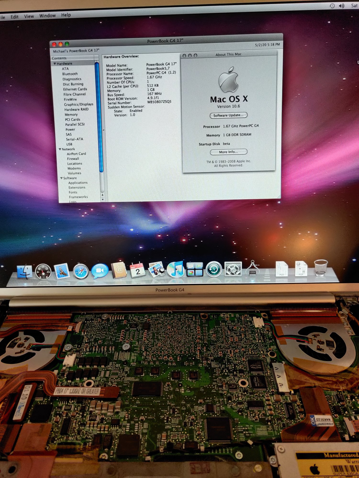

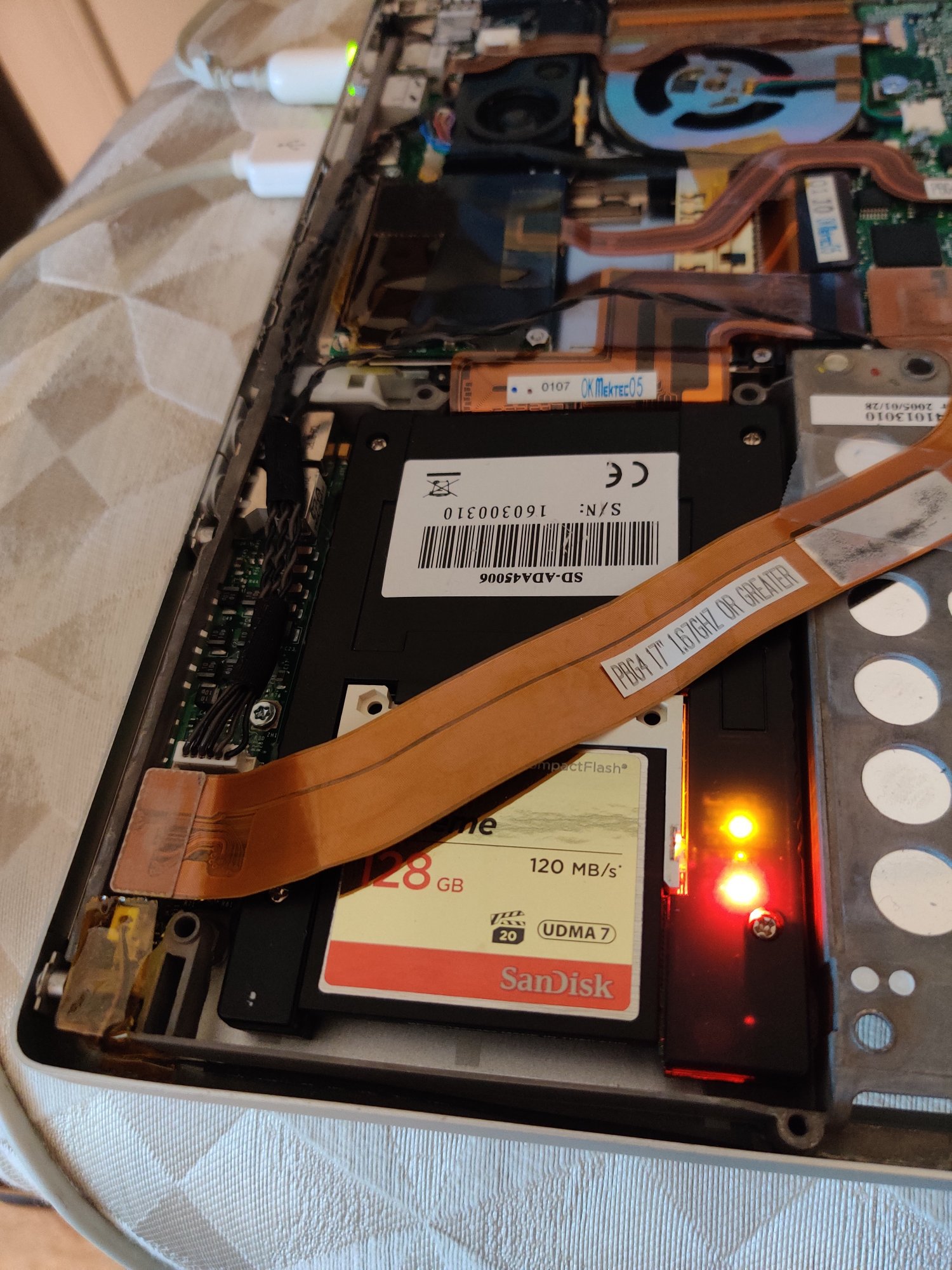

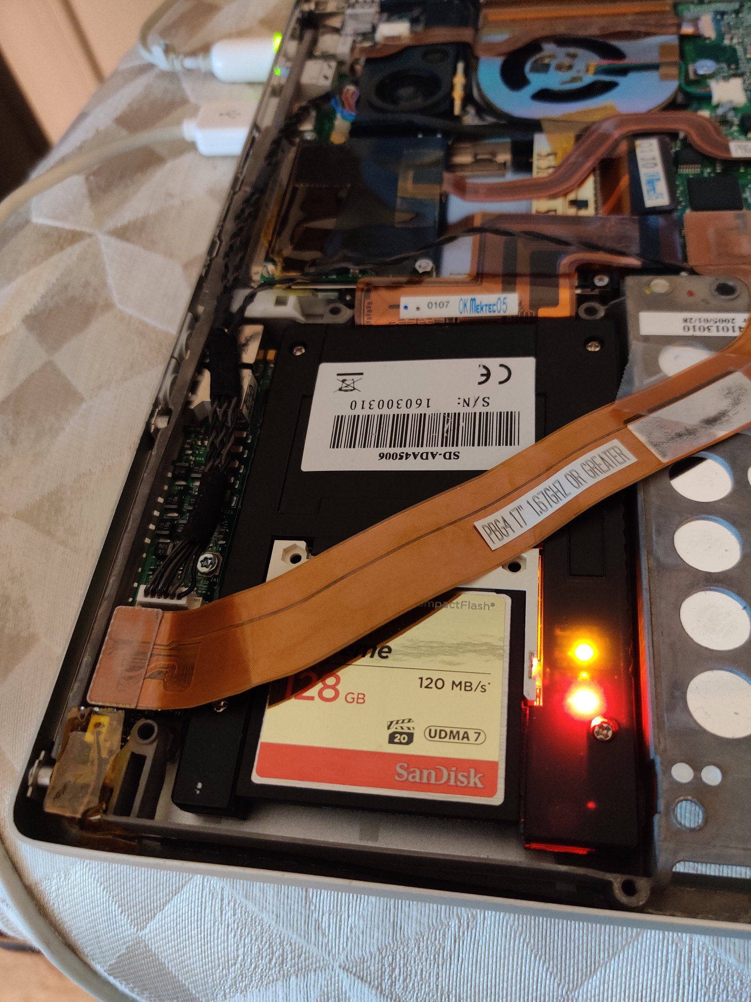

Reviving an old thread for other googlers, reviving an old PowerBook G4 with a 128gb SanDisk 128gb compact flash card+dual CF adapter is working great so far. Will update the thread if I have any issues.
Reactions: bushidounohana
You have any ideas for PPC software to check?

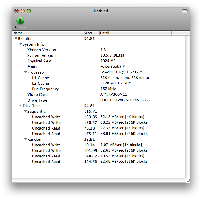

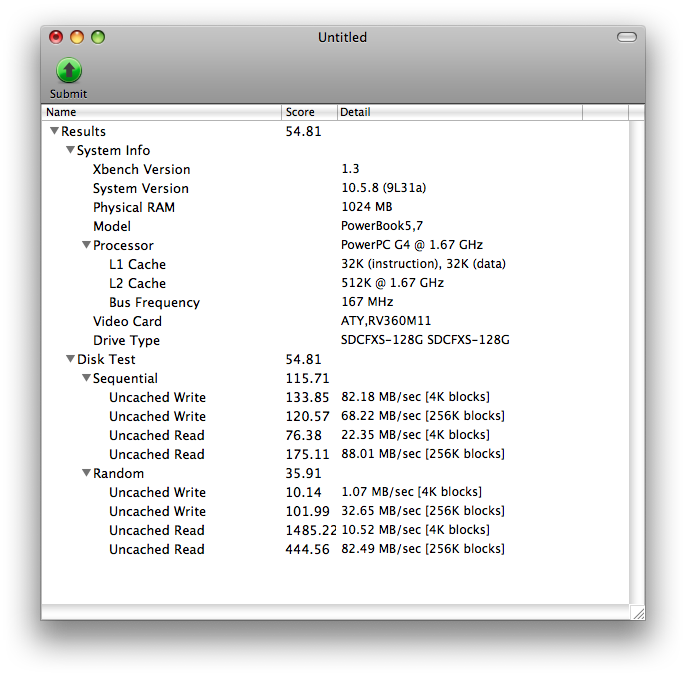

Decent results for a compact flash card.
