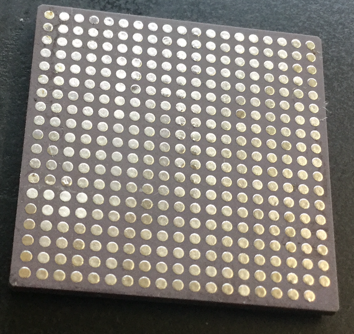

heres a picture of the nice clean pads on a 7410 im in the middle of reballing, which I used the TS-100 to clean up the pads on :) and despite the fact I was using my "bad" solder wick as I had run out of the Goot stuff (Pun intended) :p the pads still cleaned up quite nicely, having done this exact same thing before but using my 936 clone with the same wick I can say for sure that the TS-100 makes a world of difference (if anyones wondering, my BGA stencil has gone walkies so I have not yet been able to put the solder balls on this chip)
I would highly recommend that if your looking to get into this sort of work that you pick up a TS-100 soldering iron (or some sort of Soldering iron that is compatible with the Hakko T12/T15 bits) :)

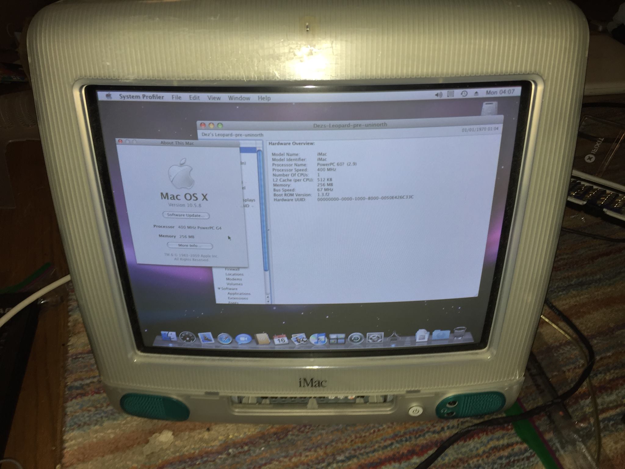

I managed to get Leopard to run on the machine using an image that @LightBulbFun made. It runs, but not very well.
Is this a revision A or B? I read that the revision B can take 2x 256MB RAM, maybe that would help. (Not that it would probably change a lot, but the revision B also has an ATI Rage Pro Turbo graphics with 6 MB instead of an ATI Rage IIc graphics with 2 MB, or does it?)
I'm not even going to make that attempt on my Bondi. Tiger with 6mb of video RAM and 512mb of system RAM drags pretty badly, even with a 400mhz G4 upgrade. With the View script and mplayer from a different thread, I can watch some video, but Coreplayer just crashes due to the lack of video RAM. OS 9 flies, though, and the Bondi is a screaming console and arcade emulation machine with the G4. I'm curious whether 3D games' performance have improved, but those are more GPU- dependent than anything else. Regardless, I'm glad I made the investment.
Leopard can actually run suprisingly well on such "low end" hardware :)
after talking to @dosdude1 for a bit we got leopard running quite a bit better on his iMac G3, turned out some files got corrupted during the OS clone which messed some things up (on top of that there was some dodgy RAM that needed swapping out IIRC)
if anyone wants to give the image a spin you may or may not find it here... :D: https://mega.nz/#!ZNJzRR4A!mA1svzvbBzWa7dJwH8XlWUjJ-3xiSBAxzeHlWaKgSP4 (the password to the user account in the image may or may not be: leo)
this image should work on any* Pre uninorth machine as long as it has a G4 (however if your doing this on a Beige machine make sure to run xpostfacto 4 "install everything" option from the menu bar. during development of this image the PowerSurge platform expert went walkies and I only noticed it after packing the image up, and that kext is vital for booting Leopard on PowerSurge machines ie 7300-9600s, running "install everything" will stick this kext back :) )
*sadly I dont own any PowerSurge (PowerSurge are the Power Macintosh 7300 through to 9600) machines to properly test this image on so I have only been able to test it on machines as old as my G3 beige. but in theory as said it should boot on a PowerSurge machine as long as it has a G4
I think I might try a clean install of Tiger to see if that improves things. The G4 is definitely an improvement in performance over the G3, but my install may just be borked from years of use.

I took the plunge and restored the Leopard image that you supplied (thank you) to a spare 7200 rpm drive that I had laying around. It boots to the desktop, but I get no USB love. I tried resetting the PRAM and pressed the CUDA switch, but still, no USB. Any ideas?
[doublepost=1528237595][/doublepost]
We addressed this in your PDQ thread. I wonder if this would work in the Leopard image that @LightBulbFun supplied. I guess we can test that theory when I get USB working in Leopard on the Bondi...
ok interesting your iMac G3 probably has the USB controller I originally thought all Tray-loaders have, which is the same as whats in the G3 BW, I still need to work on getting that USB controller working in Leopard. however the leopard image does have Screen sharing and file sharing enabled and the ethernet should work, so you should be able to remote in via screen sharing etc :) (but expect it to be a bit more sluggish then normal)
( @dosdude1 tray loader has a diffrent USB controller then i was expecting which works fine in Leopard)
