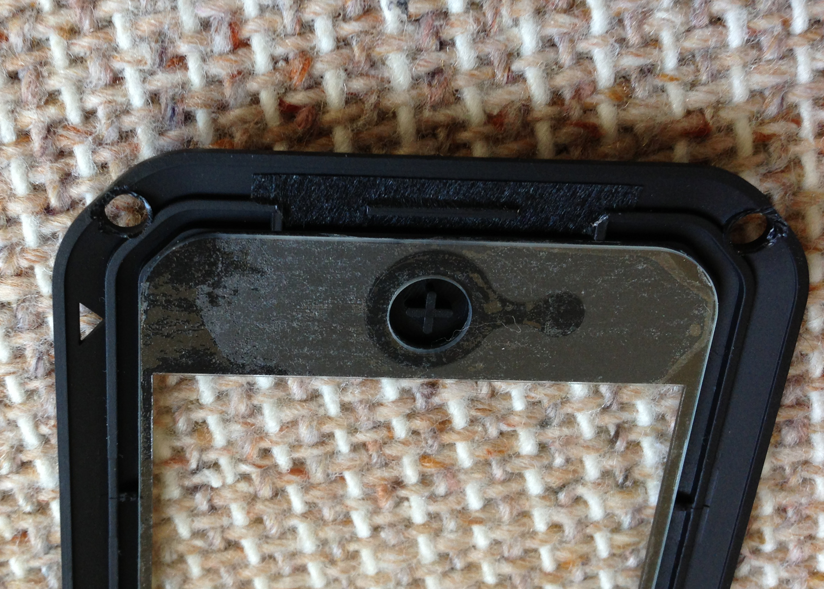

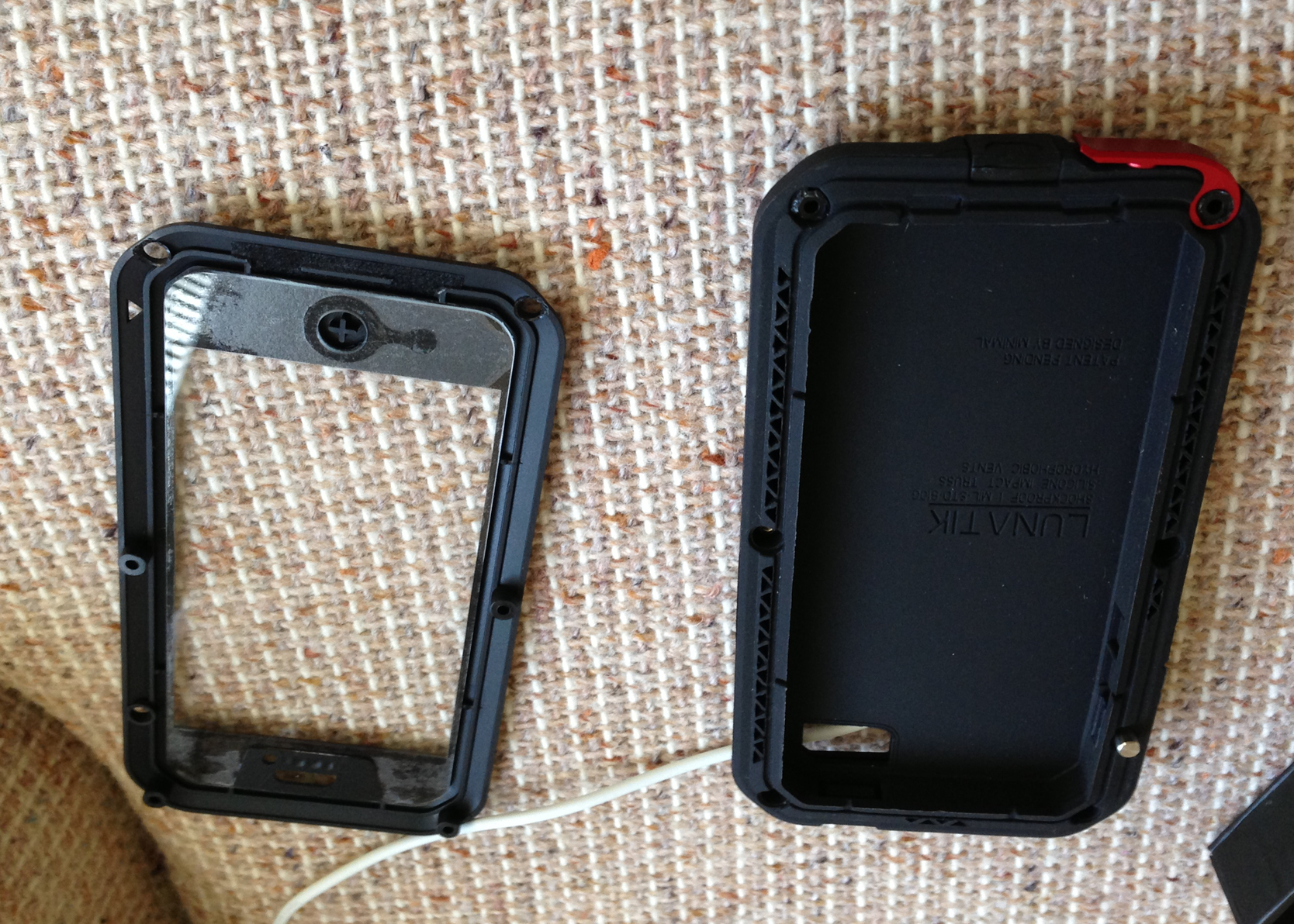

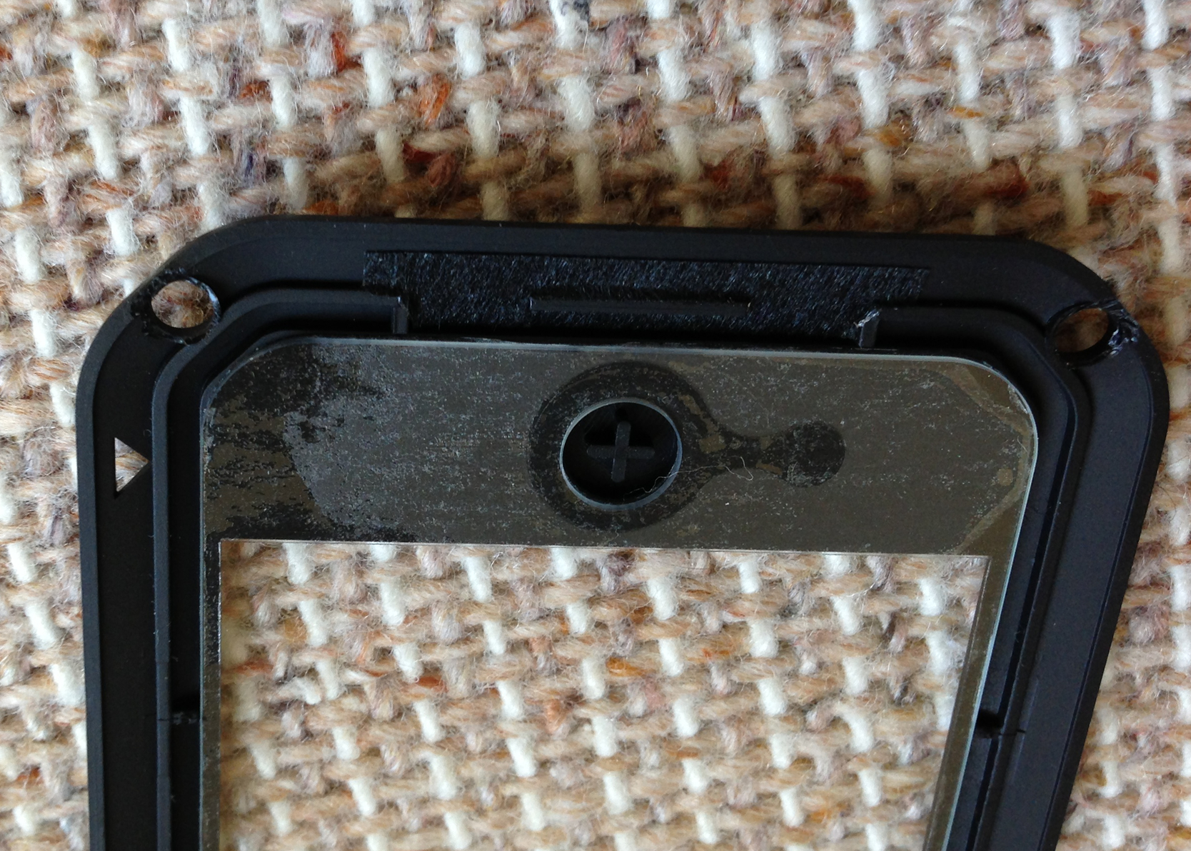

Case is already falling a part. As you will see in my pics, if you take the case apart more than a few times, the female end of where the screws go in, have come off. This is not indicative of a quality case. I have requested a new case. I hope this doesn't happen for all of you but if you look at the pics, I don't know how it won't happen to the rest as the screw seats are not physically molded into the plastic body...

Mine is OK so far after two removals My suggestions:
1. Squeeze case together when tightening screws so as to take pressure off
the screw seats.
2. DO NOT over-tighten the screws. I suspect that this is the problem with
the female end being torn loose.
3. I removed the tape from both sides of the top speaker area. I used a
label remover (Label Off) to remove the tape residue. Make sure that it will not affect the case material.

Finally got out today after much snow blowing. I got the case and for the most part it looks like good value for $50. However the two bottom screw holes were broken off right out of the box just like on Philly2's case. So I sent an email and pictures to iphonecase2011 to see what he can do to remedy the situation.
Screen works great though right away and the case fits right and secure. Will add more pics shortly.

Sounds like a quality control issue, which is what I was worried about prior to ordering from china. I've screwed and unscrewed mine only three times, but haven't had any issues with any of the screws this far.
