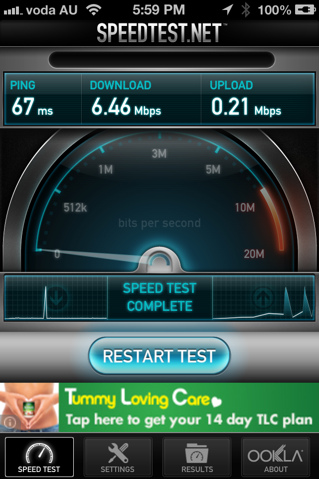

are these pics just to make me look bad ?, or do you guys prefer to use LTE/3G allot ?
:eek:

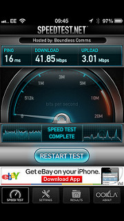

Before I got to work I ran a few speed tests...
My Ipad is always up to about 30mb/s, although I am on Fibre Optic with at least 80mb/s, but not sure because its a wireless device.
My Iphone 5 was pretty slow last night, but this morning I had nearly 20mb/s and upload between 14-18mb/s.
