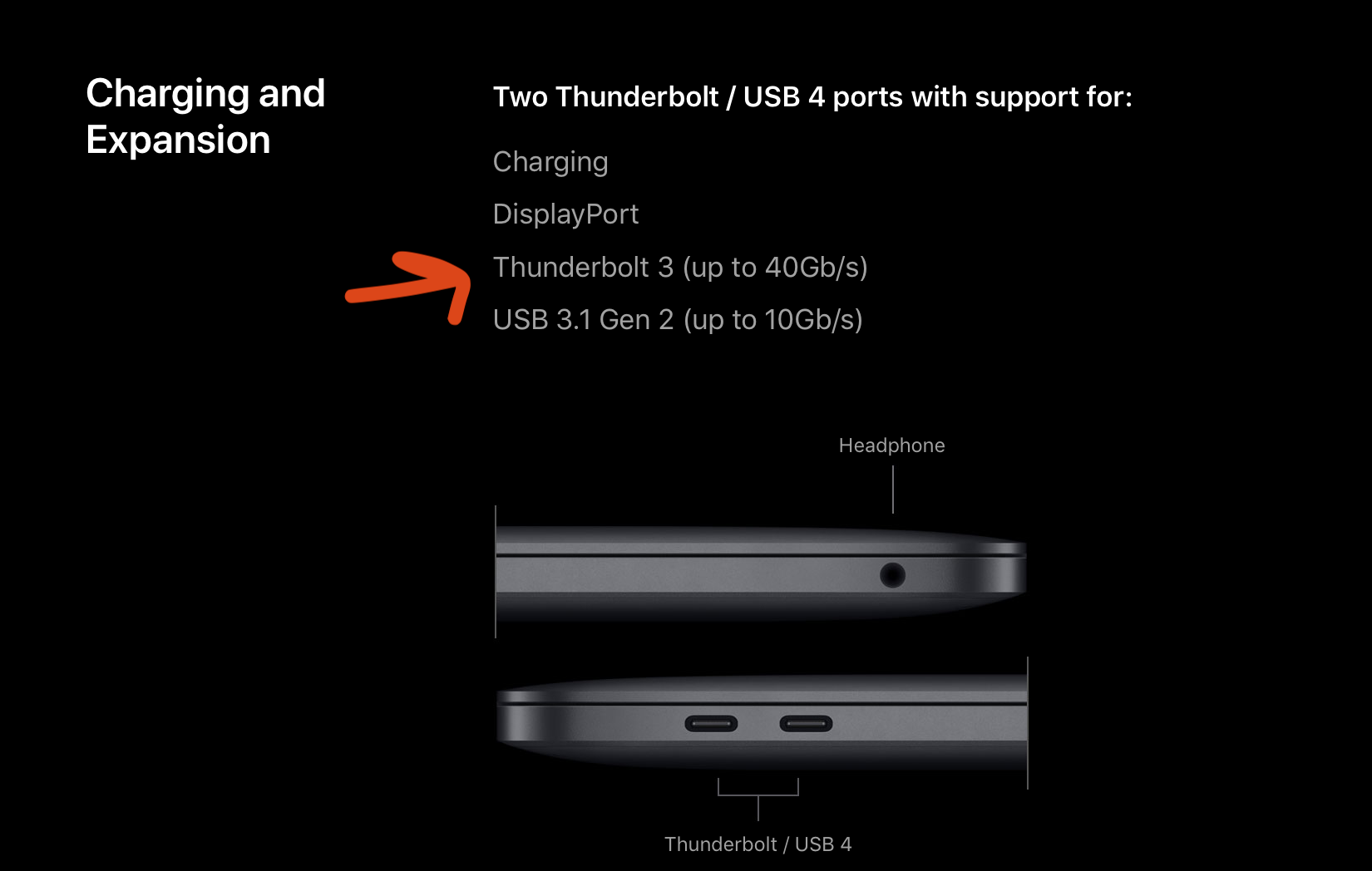

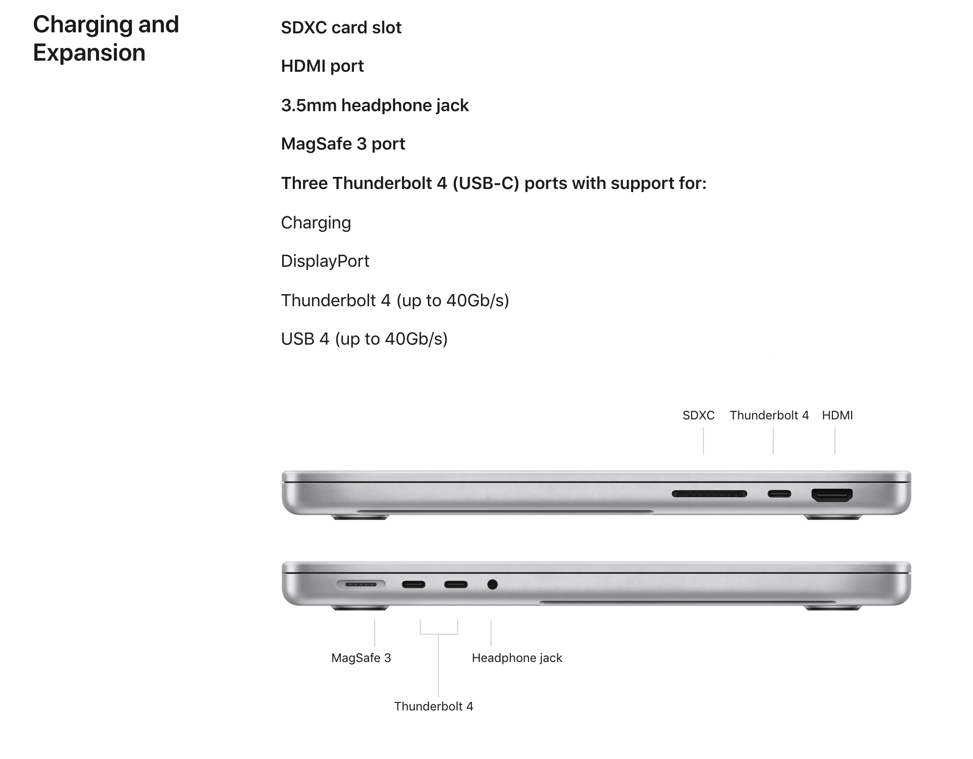

Wrong again.
That says Thunderbolt 3. The original remark was regarding Thunderbolt 4 but your reply is technically correct for the second remark which specified only USB4.
The M1 Pros from 2020 were only USB 4.
The only reason Apple couldn't call the USB4/Thunderbolt 3 ports of the original M1 Macs "Thunderbolt 4" is because Thunderbolt 4 requires that two 4K displays can be connected to a single Thunderbolt port, but the original M1 Macs can only connect one display to Thunderbolt (but a Thunderbolt port of an original M1 Mac has a second DisplayPort connection to drive tiled displays like the LG UltraFine 5K at full resolution/refresh rate so it's almost Thunderbolt 4).
Thunderbolt 4 doesn't actually add anything to Thunderbolt 3 for Macs except for USB tunnelling which doesn't mean anything to the user and just gives inferior USB performance. Macs with Thunderbolt 3 are able to use the extra Thunderbolt ports of Thunderbolt 4 docks and hubs so that's not an issue. I suppose Thunderbolt 4 adds support for USB4 devices that don't support Thunderbolt but I don't know of any such USB4 devices.
Thunderbolt 4 is basically Thunderbolt 3 with no compromises. The only Macs that had limited Thunderbolt 3 were the MacBook Pro 13 inch models with four ports from 2016 and 2017 where the right hand ports had reduced PCIe bandwidth (1500 MB/s instead of 2800 MB/s) but still had full DisplayPort bandwidth and could therefore still use all the 40 Gbps in some situations. Oh wait - Macs with Alpine Ridge Thunderbolt 3 controllers are limited to DisplayPort 1.2 output but that's not a big limit since it still allows connecting two 4K displays and can still use up all the 40 Gbps.
