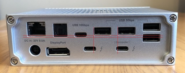

Af far as features and functions are concerned, very impressive.
But the design, oh boy. Port layout is a mess and it looks looks like a $50 box.
Ugly? Yes but who cares. No box stuffed full of cables is ever going to look pretty.

You're kidding, right? Look again - the port alignment is all over the place. If it works, then I guess that's all that matters for most people. But to say it's gorgeous when clearly it has design issues is to miss something important to Apple users. Imagine Apple putting something out like this - we'd think standards had slipped in the design department.

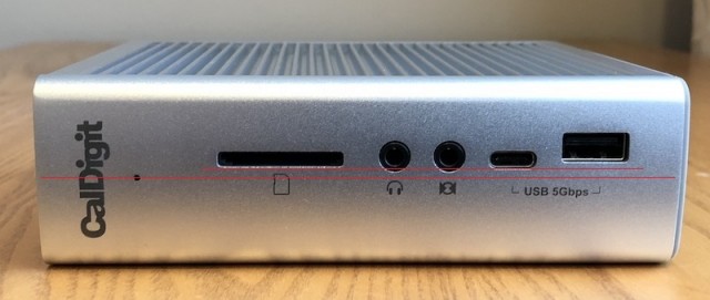

I kinda agree with you, BUT that's only a couple ports on the back that have slightly off alignment. If you have ever used a docking station, you would probably plug in Ethernet, Thunderbolt, DisplayPort and most USB ports on day one, then leave them there for few years. You wont care about how messy the cables are behind the dock; they would be very messy anyway, and that's the whole purpose of using dock where you can route all the cables to the dock and use only one cable to your laptop from the dock. It's not like an iPhone, you have to use it, feel it, and look at it every day. The Dock is meant to be installed on your desk and forget it.
The ports I use a lot is the front USB ports, not the back 😉 so I care more about the appearance on the front, not the back; TS3 Plus and TS3 have sleek design on the front, and I can understand why they have to put that many ports on the back and jam them together, after all, we need more missing ports back, the more the better 😉
I would give an A+ for the feature, a TS3 Plus can provide; A- for the off-alignment design on the back panel unfortunately, and A++ for the pricing they offer.
No, you're being too kind here... (as OCD, and largely irrelivant this is!). It's more than a couple of ports on the back that are off. And the front also has issues too.
