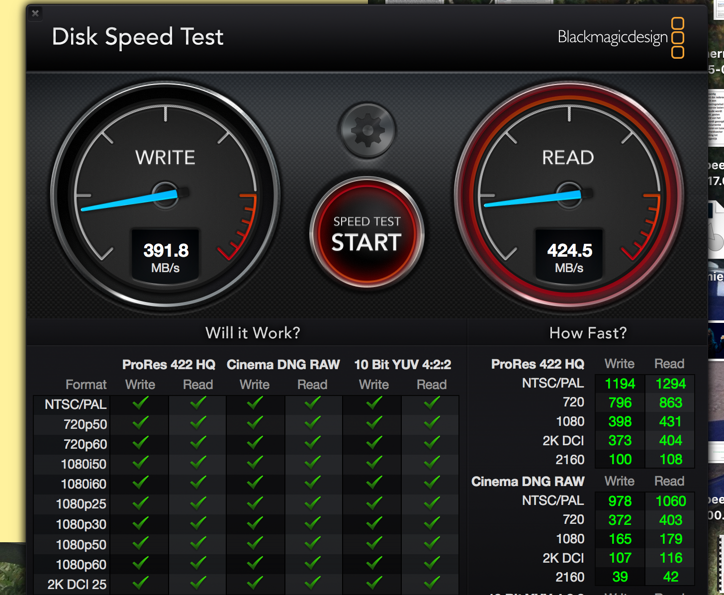

Just bought a TS3 Plus from someone that had trouble getting it working on HP Zbook. my luck: I saw W10 installation tips like 'wait 20 secs' next 'wait 2 minutes for drivers' and a lot of 'message xxx might appear' and 'settings might be needed to be changed in account/administrator/BIOS:...".
I think he was a bit overwhelmed when he saw me hook it up: "you 'll probably have to give it some time, he said". My reply: I already installed the Utility in one click and while saying that I hooked up and opened a map on SSD disk, grabbed a CF card reader with CF card in and attached it and pushed a 32GB SD card in the onboard reader. All in like 5 seconds. Wooow!
Just one point I don't agree on: UASP speed over 5Gb connections is called 'normal' at 300 and something MB/s. NO, IT IS NOT! I get 380/420 like with my Samsung T1 attached directly to my Macbook Pro, and attached to a SeagatPlusHub I get like 380/420 or maybe 375/415, but no less. Any 5Gb/s port I tried on the TS3 Plus gave me no more than 325/345. A Samsung T5 over USB-C 10Gb/s will hit way higher speeds probably, and some decent TB-storage even more. But that's not my point: how come Seagate's external disk and hub manages topspeeds over UASP and Caldigit can't get it done after receiving data over TB3? If there is a fix for that: 100% ok.

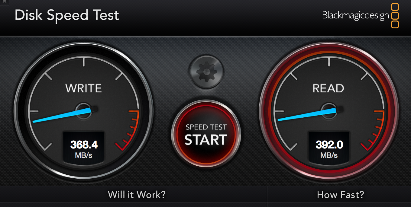

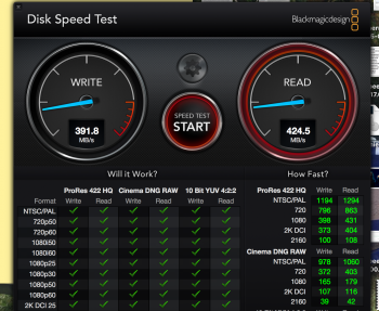

OK, so Macbook pro => Caldigit => Seagate hub => Samsung T1 gives better results... using the USb port next to the USB c 3.1 port.
