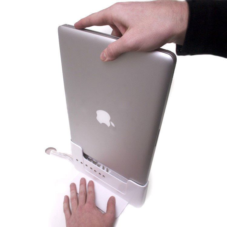

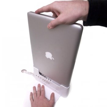

Hengedocks is one name with a decent pedigree and some interesting designs, such as this vertical docking station for the 2012 MBP.
I liked the concept, the quality of the base itself, and the aesthetic. However, the product just doesn't hold up well to frequent docking/undocking. I would take my laptop out on average 4-6 times per day. Within 1-2 weeks, one or more of the passthrough cables would become unseated. No amount of tightening could resolve the issue for me. I think it came down to the hex screw digging into plastic that was just ill-suited for this heavy use.
1) You'll need to install the cables yourself by adjusting four screws, and they require a fairly tight tolerance. It took me hours to get them seated correctly, and they move over time as you use the dock. It turns into a crapshoot every time you insert the laptop: It may work, and it may not.
couldn't keep everything working. Had to remove the actual stand up part and just use the cords.
