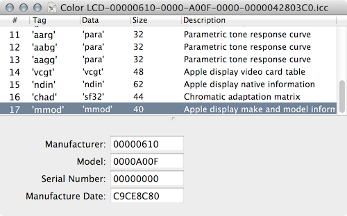

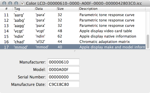

Those that have noticeable ghosting, care to post your screen model number? Under Displays - Color, make sure Color LCD is selected and click Open Profile. Then see the info under #17.
See enclosure.
I have image retention on an A00F model. The phone support guy at Apple connected me to what I think was one of their engineers. He asked some questions and then told me the image retention is a problem they have been having on a very small subset of RMBPs. He scheduled an appointment for me at an Apple store and said I would be able to just swap it out, and that they want to run some tests on my original RMBP.
Alright, I brought my laptop into an Apple store and swapped it out. Got home, opened it, and immediately noticed a blob of fuzzy/pressure damaged pixels on the new one. Brought it back the next day and got yet another one. This time I opened it in the Apple store!
No problems. I can say having seen both a laptop with the image retention and one without that there is a very real, very noticeable difference.
From the "Color LCD" information under "Displays", this one has identical specs (A00F model) as my original one that had image retention. So you won't be able to tell if you have it by looking at any sort of system information.
