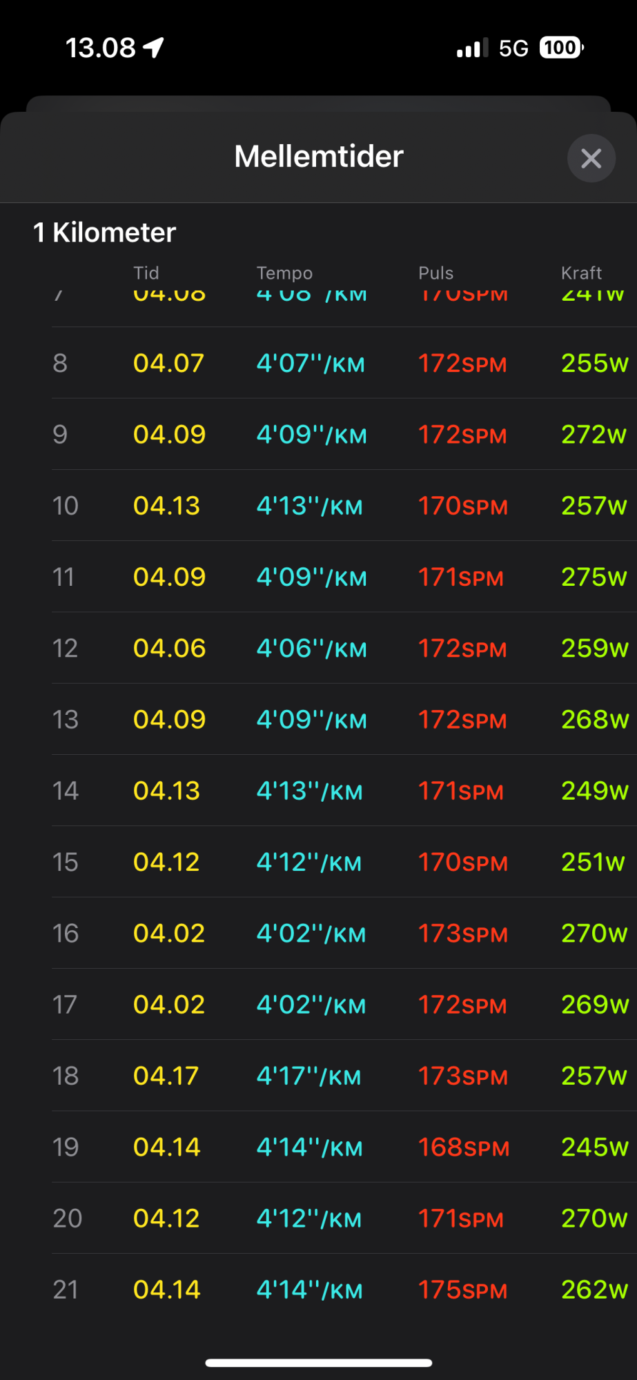

View attachment 2259558View attachment 2259555

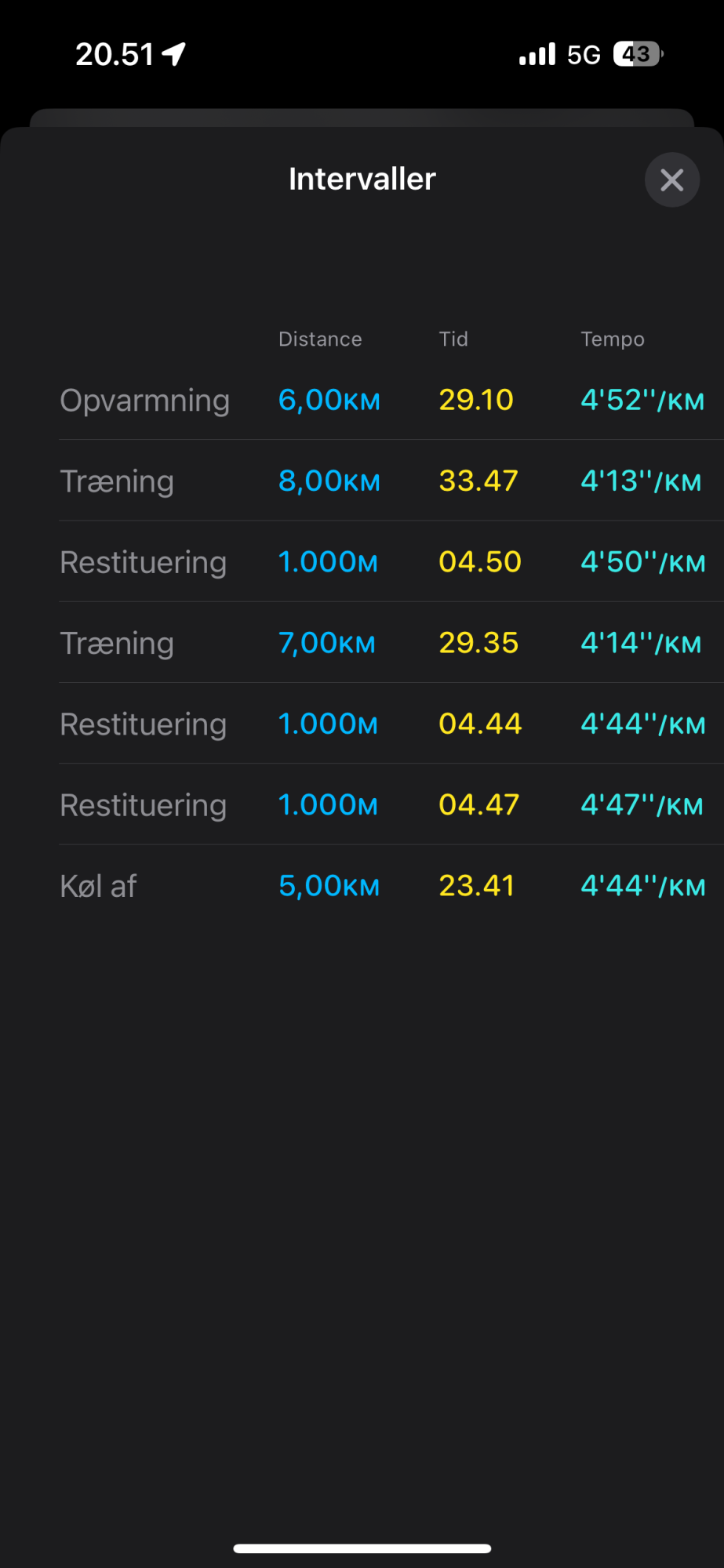

I have spotted another weird thing with custom runs now with the current PB

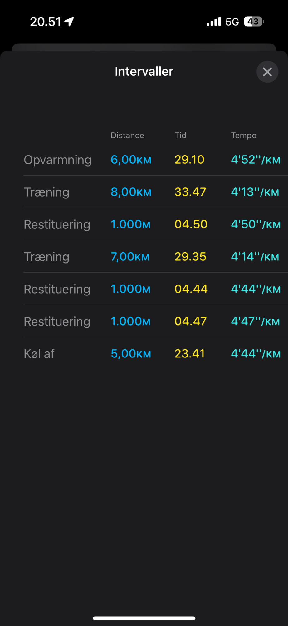

On my (very) long run the Saturday it was fine on the watch with segments and recovery etc. but afterwards the last training segment is gone and my cool down longer than it was? Then interval training today - the warm up not showing? What is going on?
That’s exactly what happened to me last Saturday (and the reason of my cursing here 😂) The custom workout was consisting of 10 work / 10 recovery intervals, but the 8th work interval simply “vanished” (a lap wasn’t marked), there’s two consecutive recovery intervals as if I skipped it.

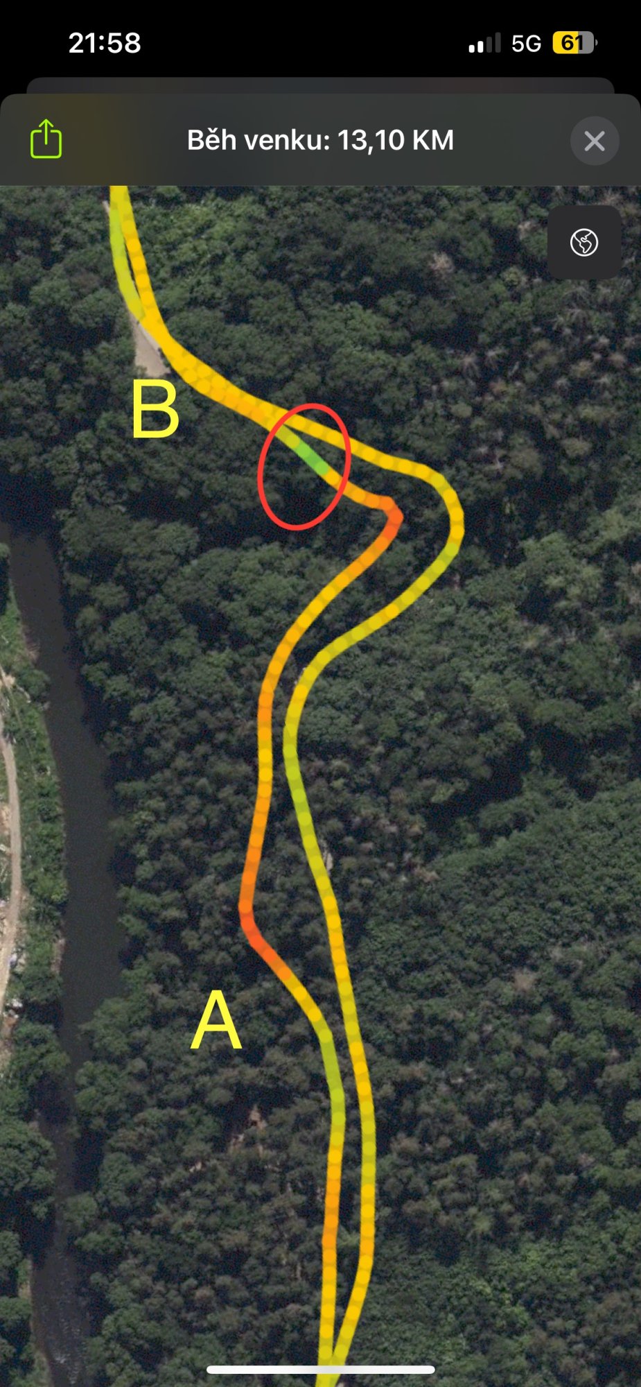

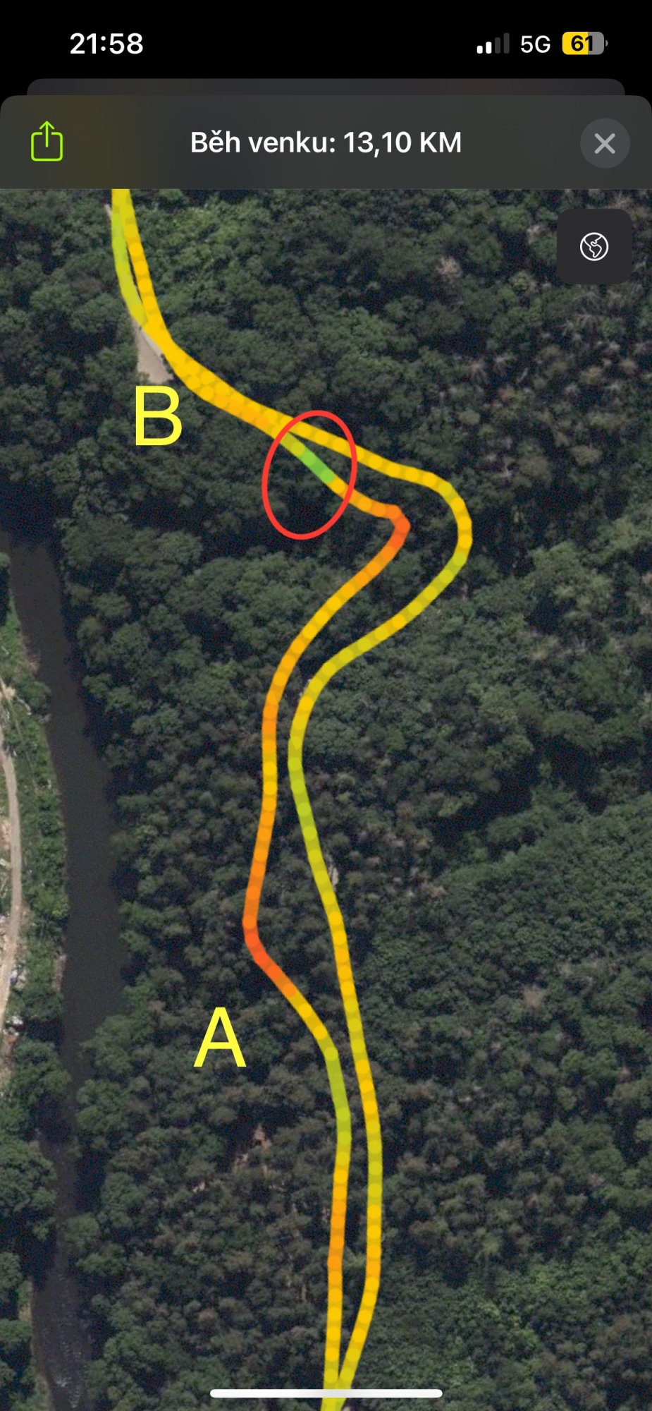

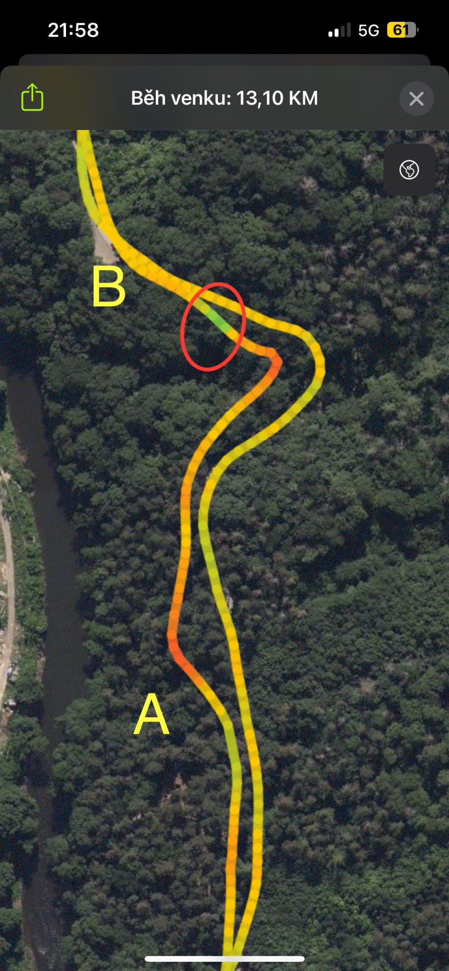

I’ve done an Open Run with the RC today. There are several small gaps but those didn’t seem to cause anything unusual.
I wasn’t watching the pace extra carefully but I’m quite certain it was incorrect / too slow at least in one segment (~10:00/km instead of actual 6:30-40/km); there was no gap at that place, rather the route was recorded incorrectly / shortened - on the attached map, the part from A to B should be in a more or less consistent pace/colour, and should follow the same path as the opposite direction. Instead, it’s shifted and goes red (very slow) and then bright green for a bit (very fast - I’m 100% sure I didn’t go sonic at that spot!). - Anyway, it’s probably just an one-off glitch, i.e. nothing to worry about; posting it here just in case there’s a pattern (similarly as with the missing lap/interval).
Other than that, it was okay I guess. Will try intervals with RC tomorrow too.
Was this a S7 run with or without iPhone? If you had your phone, it uses that GPS antenna still - try Airplane mode on the phone (not watch!) next time maybe to force it to go to the Watch GPS

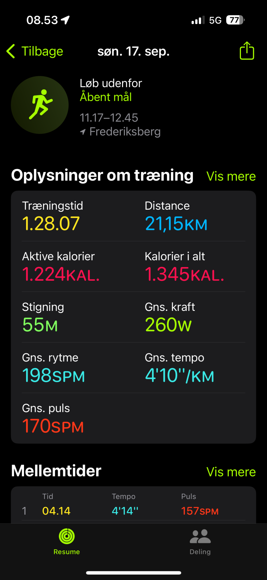

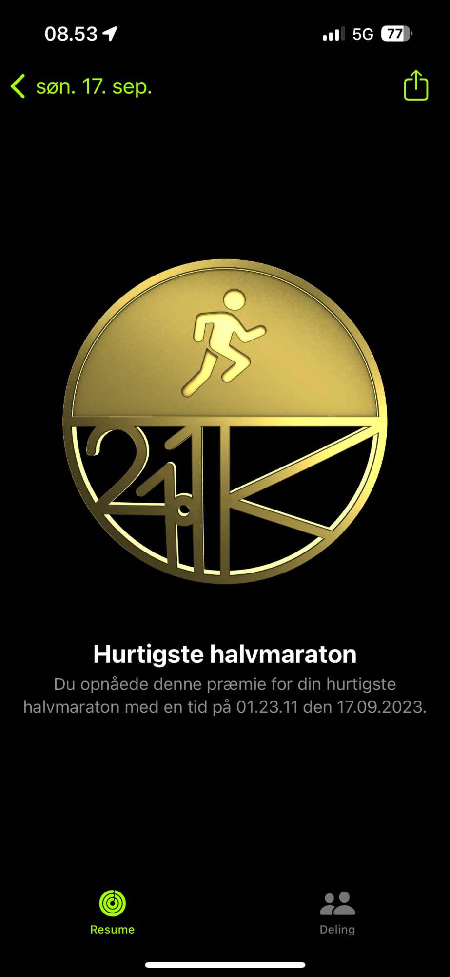

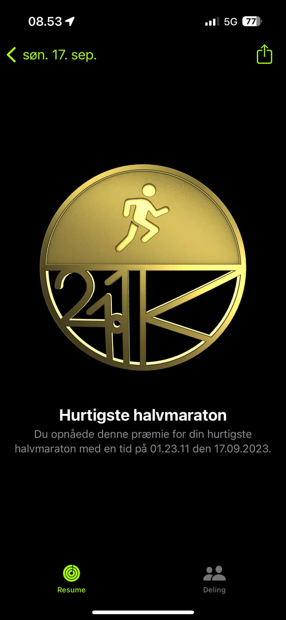

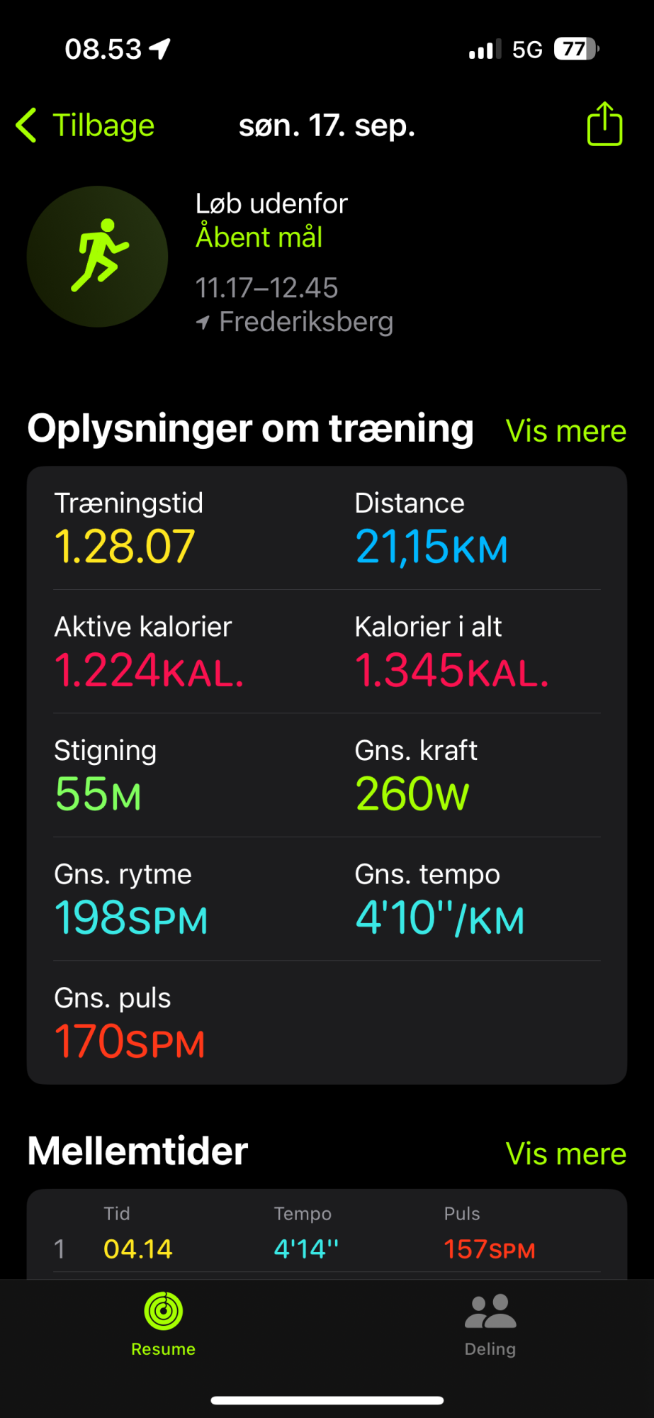

Maybe a small glitch - official time was 1.28.27 although my activity app says my fastest half is done in 1.23.11, but I ran with watch clocking 1.28.07 (know that pressing the start/stop button at the right time is a little of, but that’s me🤷🏻‍♂️)
Would be smart that I could modify my time to 1.28.27, like in Garmin so future recommendations would be correct.

View attachment 2268659Maybe a small glitch - official time was 1.28.27 although my activity app says my fastest half is done in 1.23.11, but I ran with watch clocking 1.28.07 (know that pressing the start/stop button at the right time is a little of, but that’s me🤷🏻‍♂️)
Half and full marathons are weird in the medal department. Seems like the take the time from 20K and 40K instead of 21.1K and 42.2K - Over five minutes would fit your last 1.1K plus/minus?
My fastest marathon medal is 11 mins and 12 seconds too fast and the half is around 4 minutes and 50 seconds too fast. The full marathon was from May so WatchOS 9 and the half from Sunday with WatchOS 10 GM. So no fix here.
I've never run a full marathon (yet at least), but I see a similar odd behavior on my best half marathon. You're probably right that the time is actually the 20K time.
I submitted feedback to Apple about this.

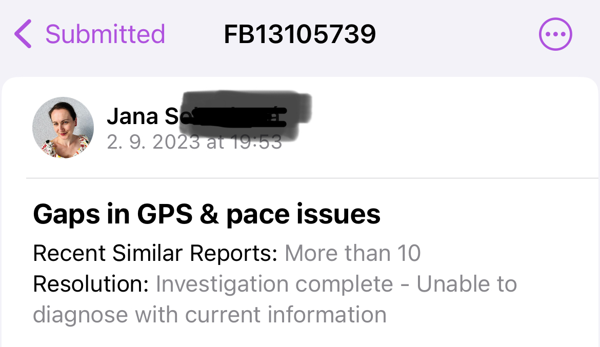

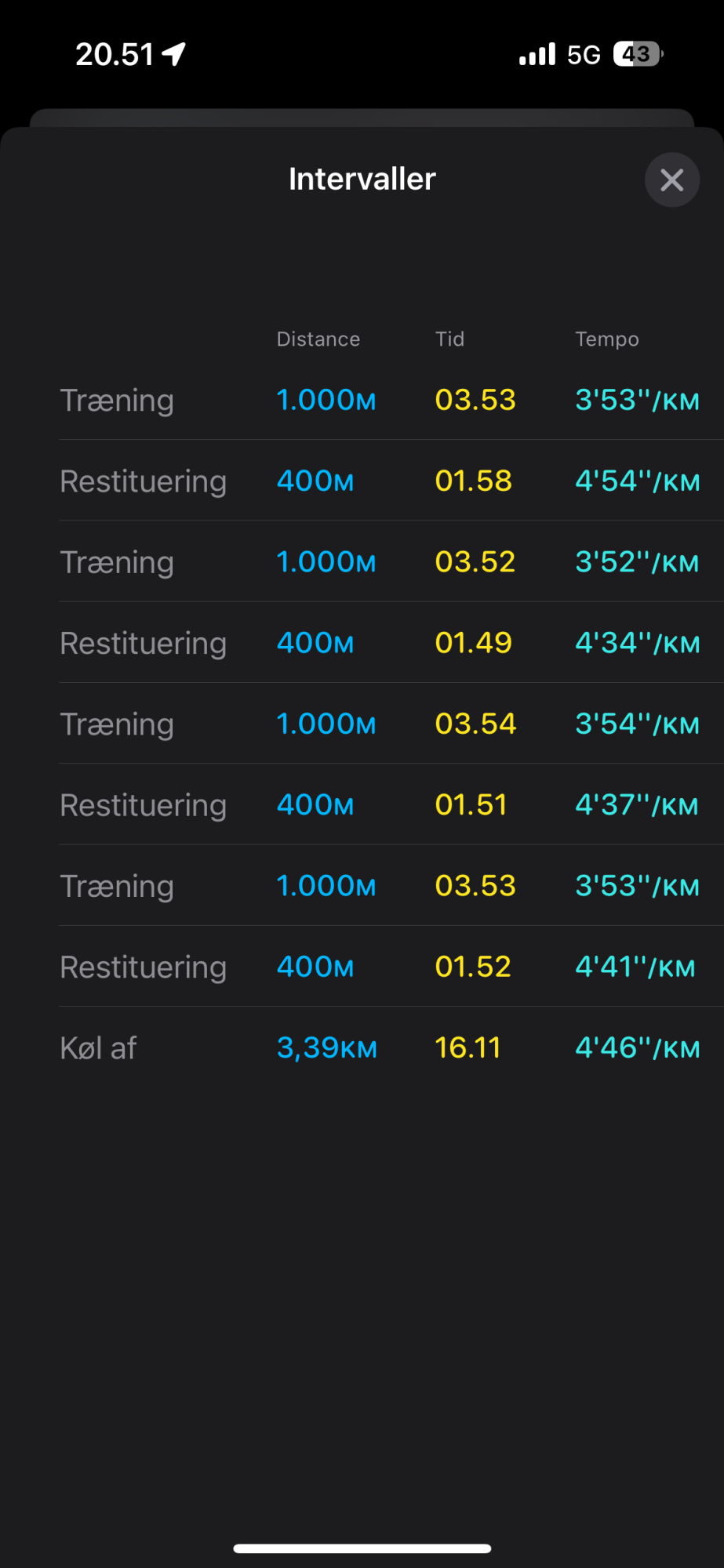

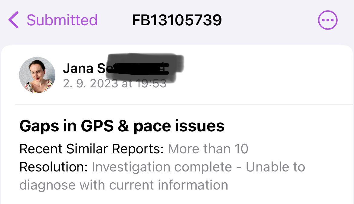

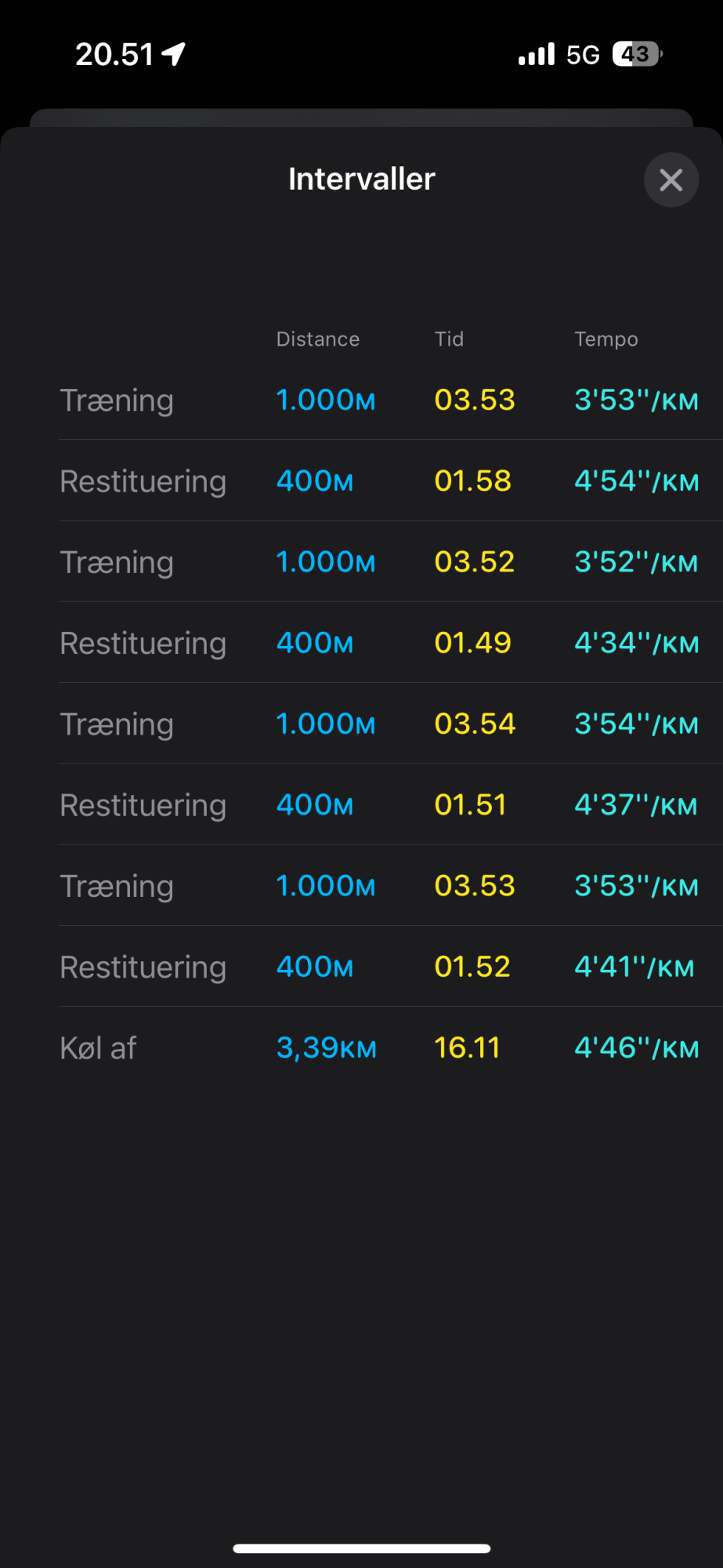

So I did custom intervals this morning (10 x 1 km tempo / 3’ recovery), one recovery interval dropped out again. I’ll be adding new diagnostic data to the previously submitted feedback, let’s hope there will be a fix sometime soon…
(Series 7, clear skies, with iPhone in my pocket - can try without the phone at some point, but these days I mostly do solo runs in areas where I feel safer with a phone… though the next intervals training on the track could be suitable for testing that!)
Edit: Whoever is experiencing the issue, please do submit data via the Feedback app! The current status is “Unable to diagnose with current information” 🥴
Reactions: xDKP
I have reported it as well - Called it "GPS signal loss on custom run".
Resolution: Open
Recent Similar Reports: None 😕
