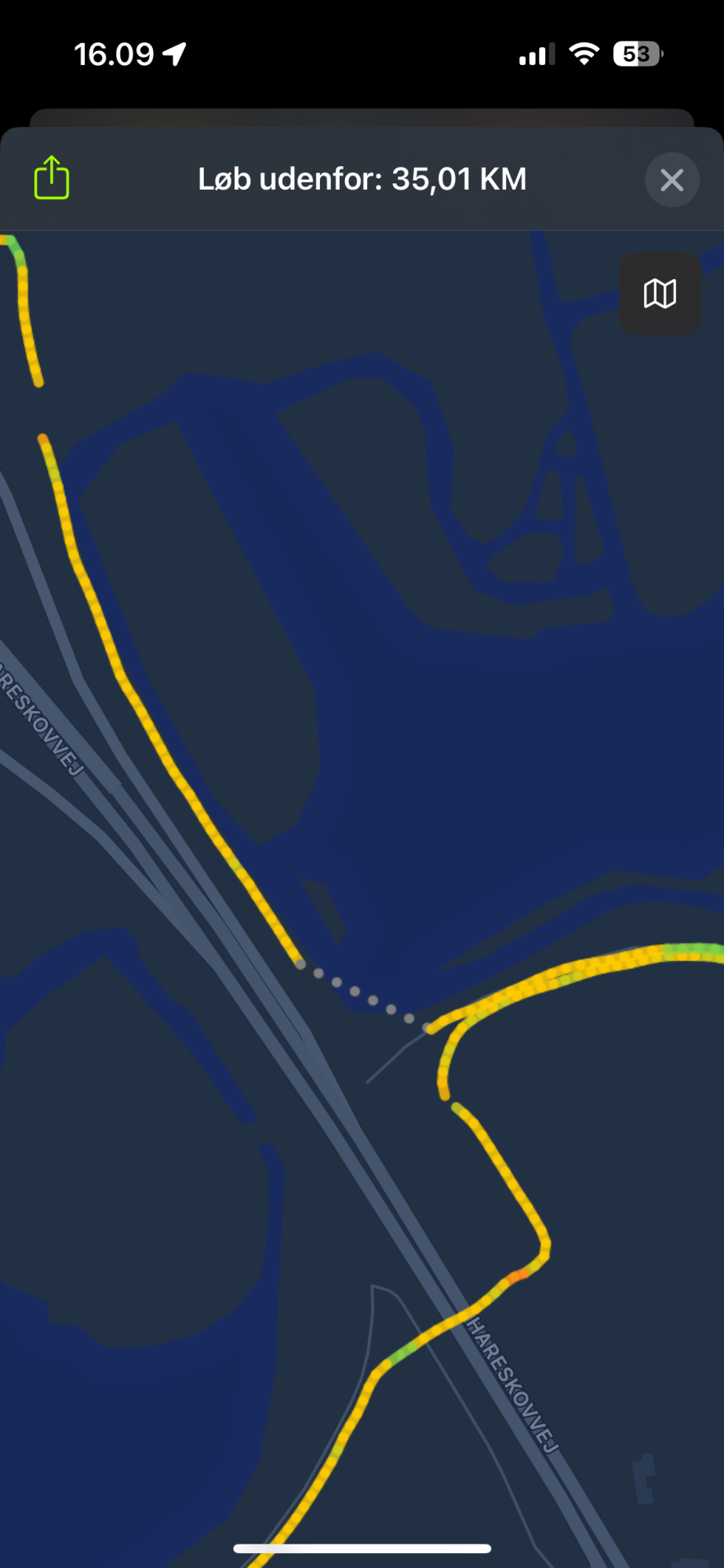

Well I told you to run another HM so couldn’t let you do it alone - did a 25K custom run and on my last interval it had exactly the same pattern as your run. We had a 2K speed interval so to suddenly look down and see pace go down and distance stalled pretty annoying

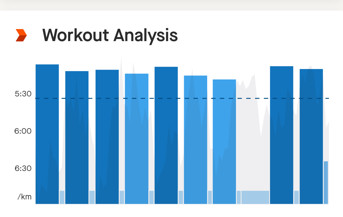

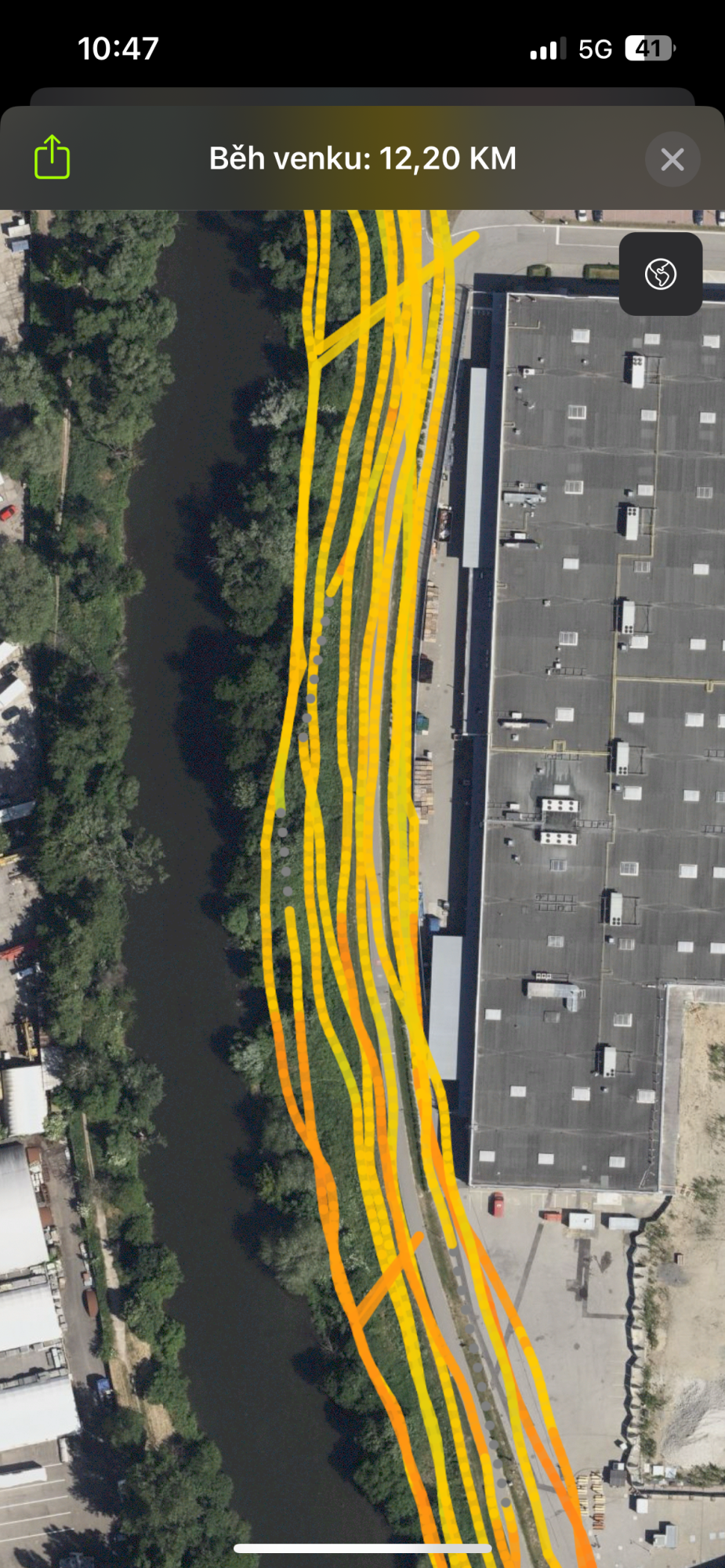

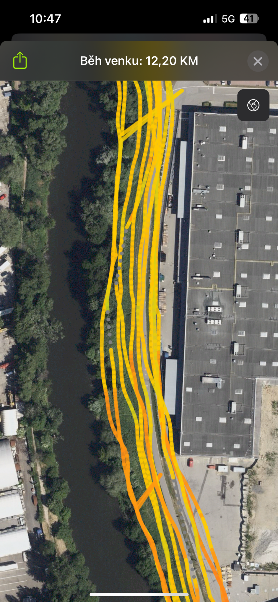

I’m beyond pi**ed. Pardon my French… 😐
Series 7, absolutely clear skies, Custom run 10 x 1 km / 3’ recovery. Total mess both during and after the run / in the run record.
  • Custom Run created as 1 km work & 3 minutes recovery, repeat 10 times
  • Intended pace range 5:15-5:20/km; okay, we know that it’s too much to ask to really set the pace we need, so I’ve set the range to 5:10-5:20/km
  • Already during the run, I was getting completely weird pace information: when realistically running around 5:00-5:15/km, the Watch was showing something like 6:30
  • Also when checking the interval pace somewhere in the last third of one of the intervals, in which I was safely within or above the range all the time, it was showing the interval average below the range, like 5:25
  • The route is pretty much a straight line with minimal curves; at one point you run under a bridge (highway) but that’s NOT where the glitches were happening
  • And after checking the outcome record, I’ve realized that one of the laps wasn’t even marked as such… 🙄
  • The pace data in the recording is yet funnier than what I’ve noticed already during the run, such as a small segment where I supposedly ran at 1:57/km 😂
I’m attaching a particularly funny part of the run map, enjoy.

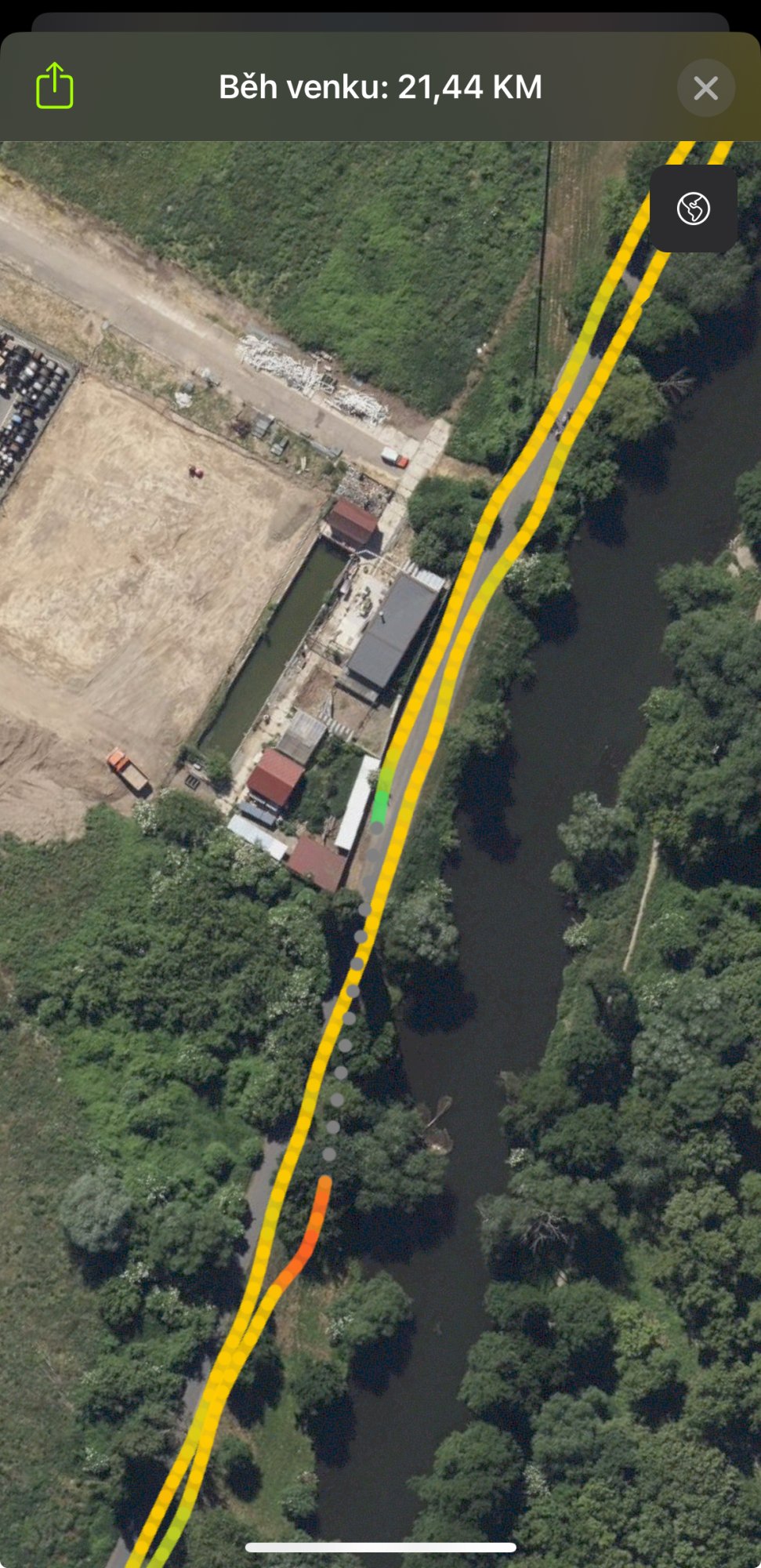

Argh the same again today on the longest run of the build - list signal briefly and caught up again.
Also it went okay with the intervals on the watch during the run but shows them weirdly on the iPhone after
