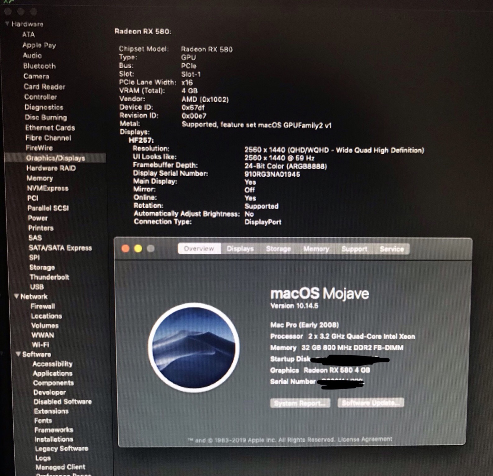

Older thread I know but it came up in related section at bottom of a thread. @OP you can now use the RX 580 in 10.14.5 via a patch from netkas.

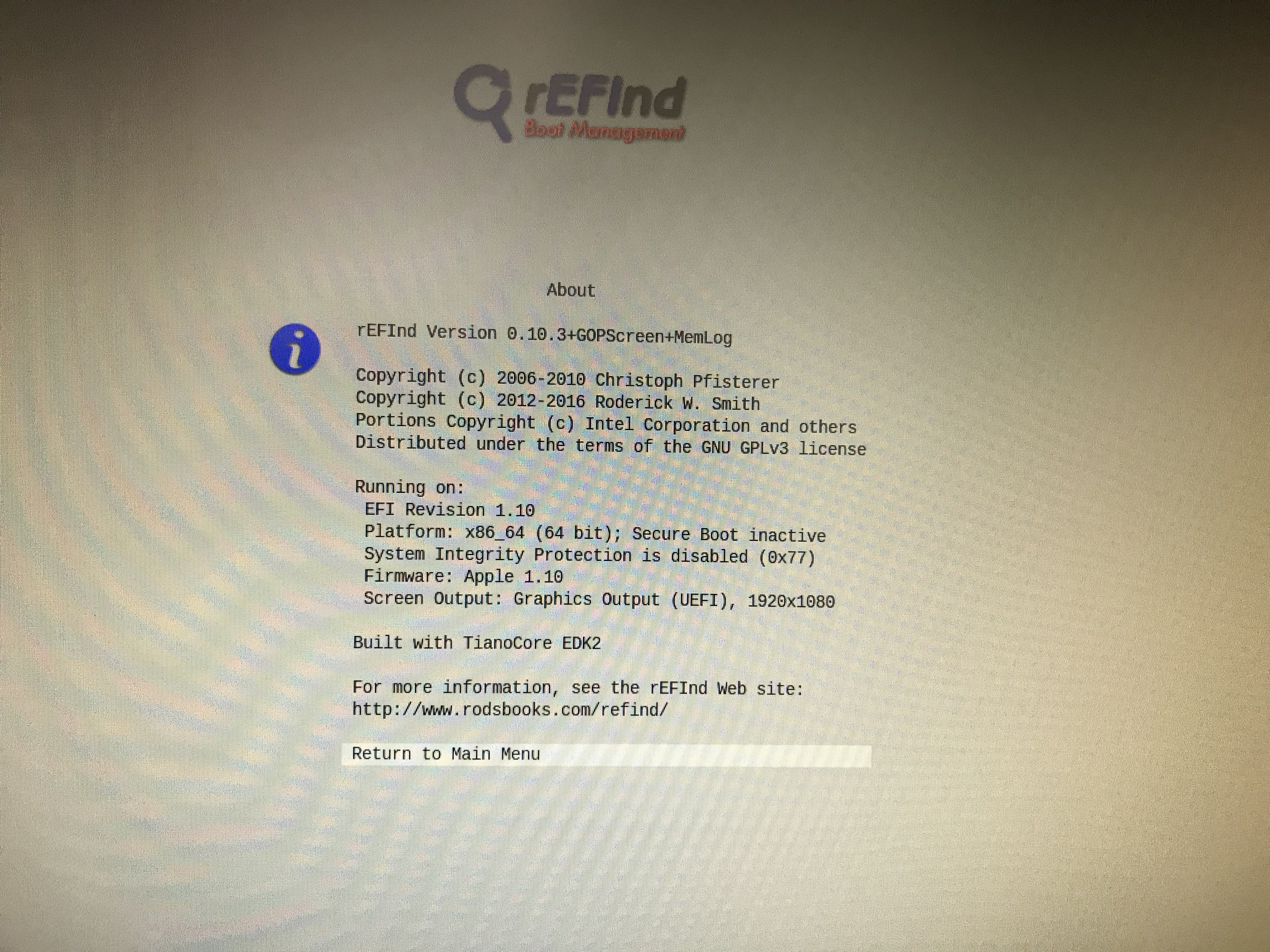

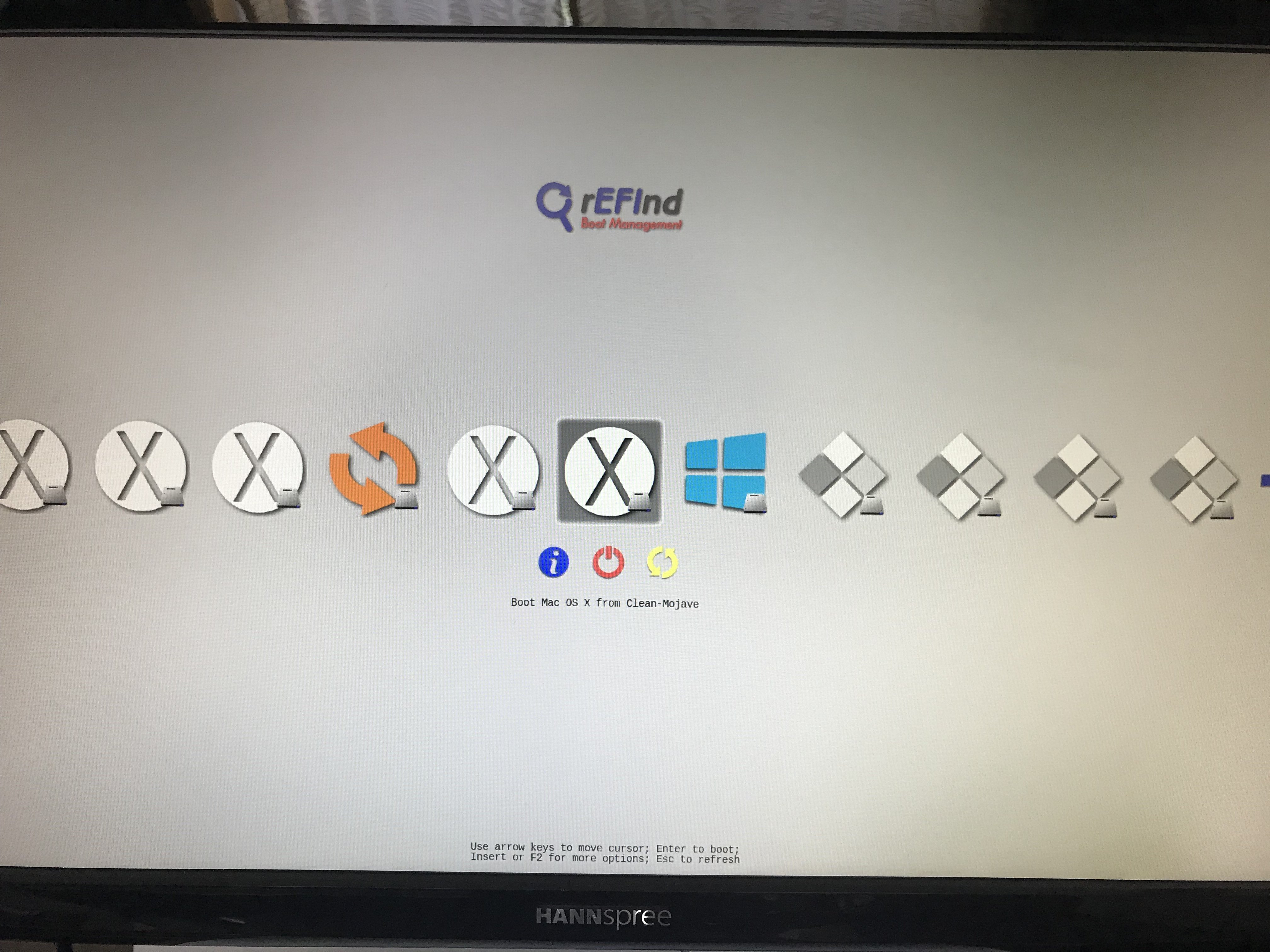

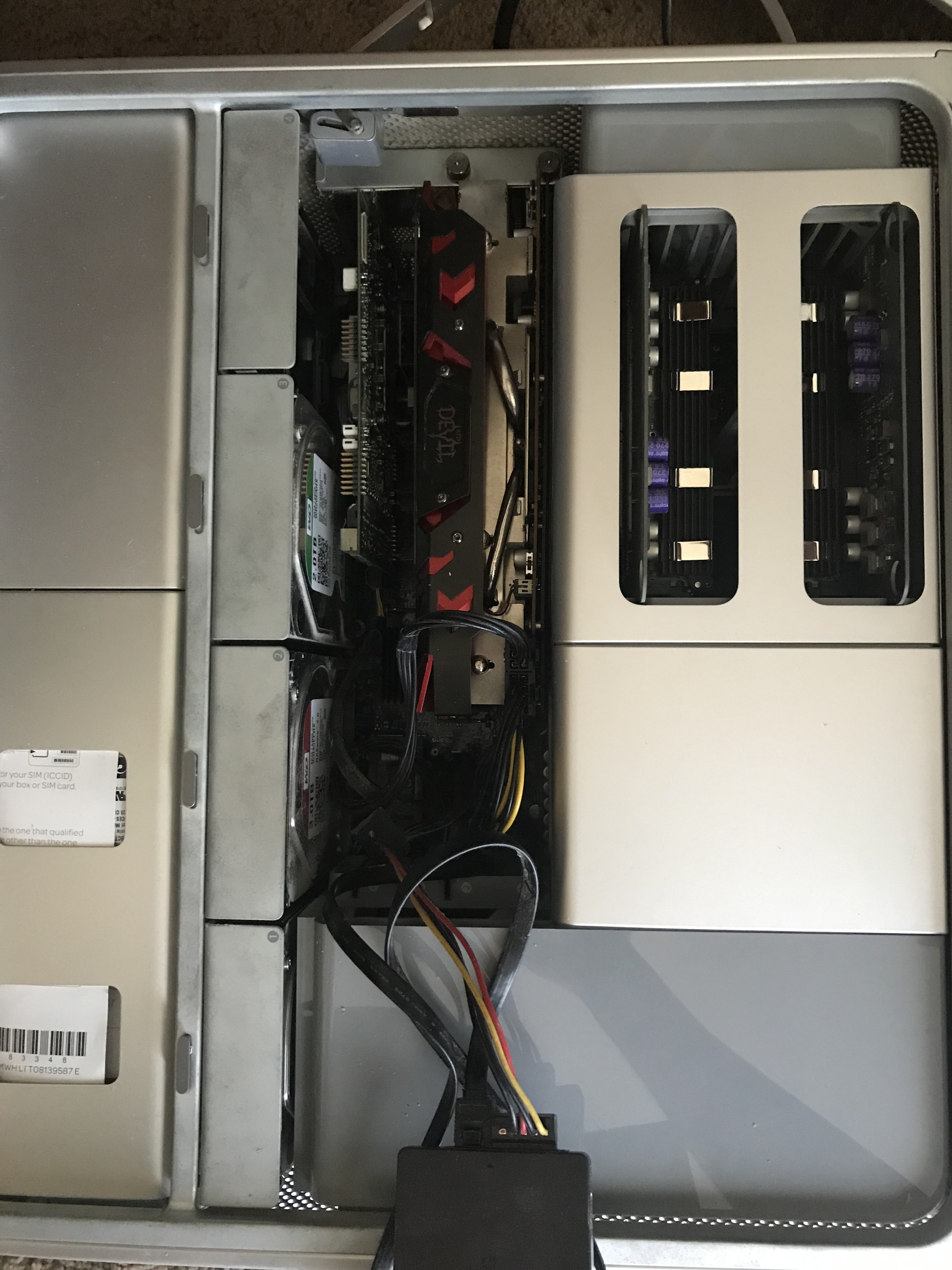

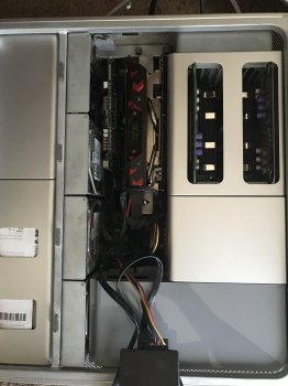

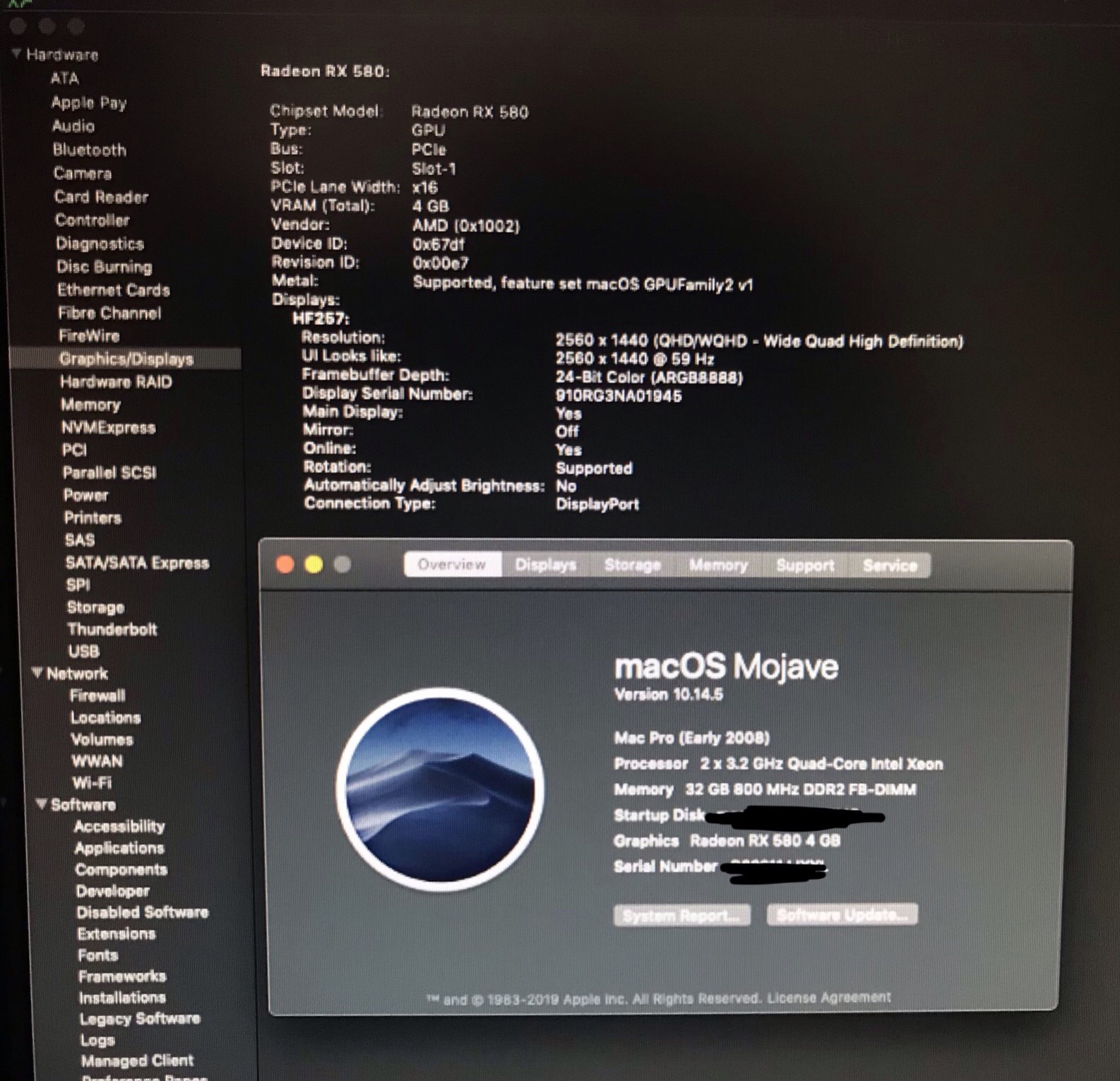

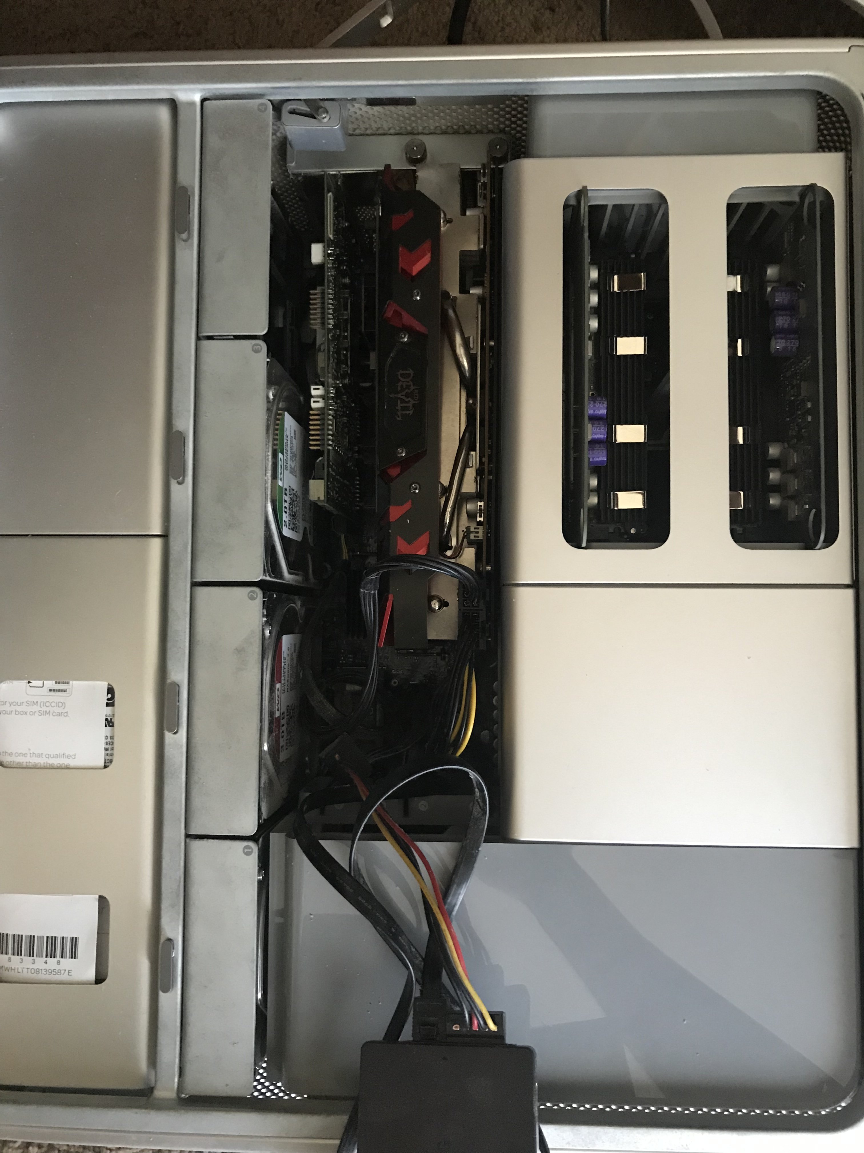

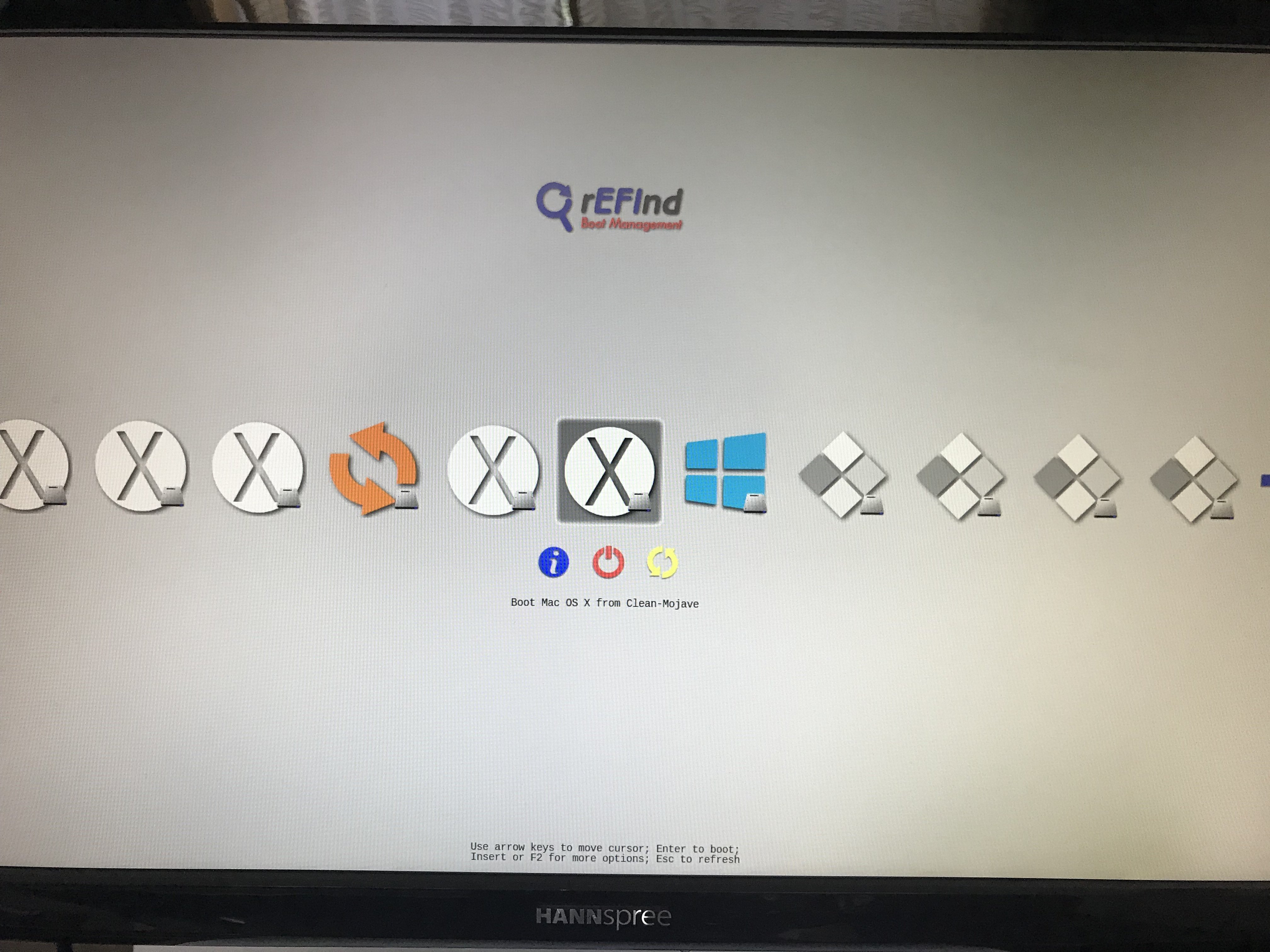

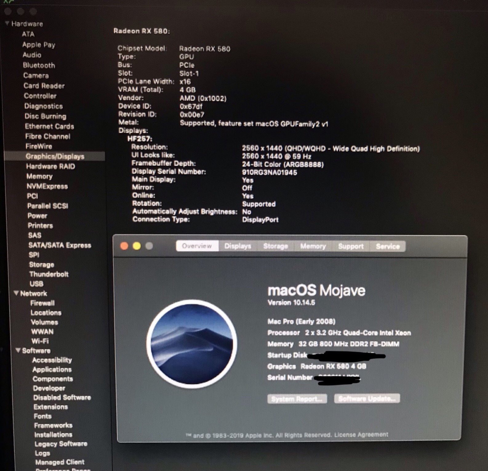

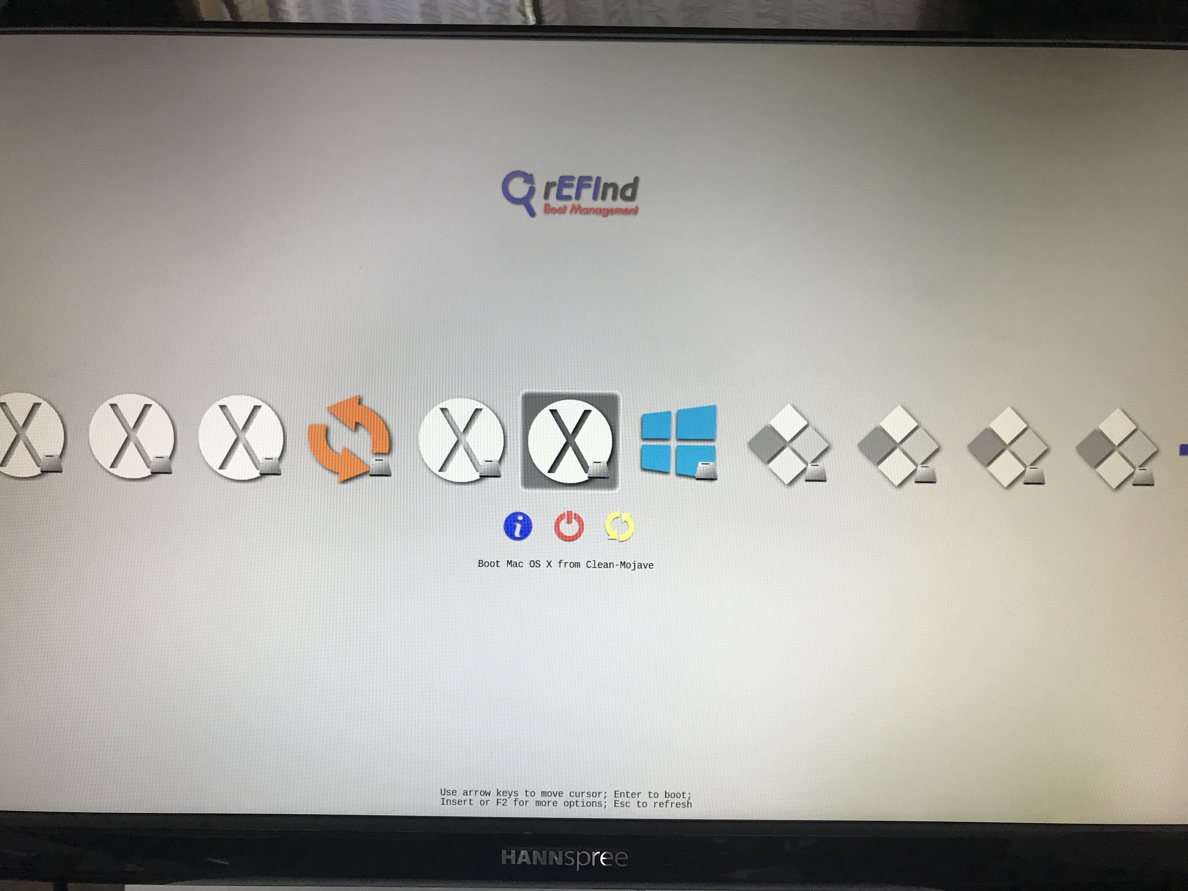

But...
C5B3FBCB-DC7F-4C06-ADF4-8F14D2DCF1B8.jpeg 00A14F8F-E043-4508-842B-D45879BC9FFC.jpeg 56123CEE-E886-4989-A58E-AF7D8EE87C67.jpeg
[doublepost=1567540396][/doublepost]Here was when I briefly had the red devil installed. Took up too much space so put in the sapphire pulse instead and moved this to another machine.
