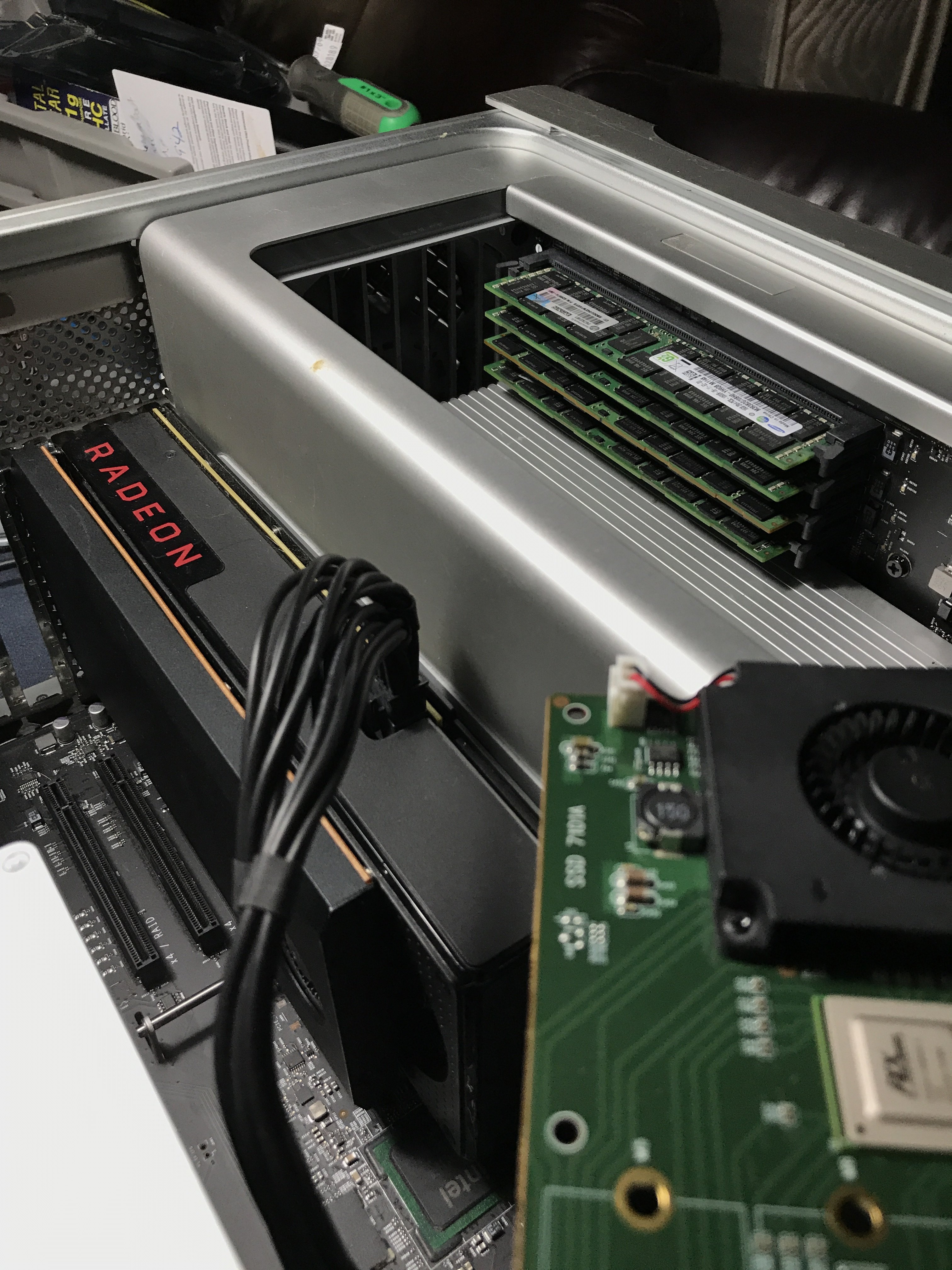

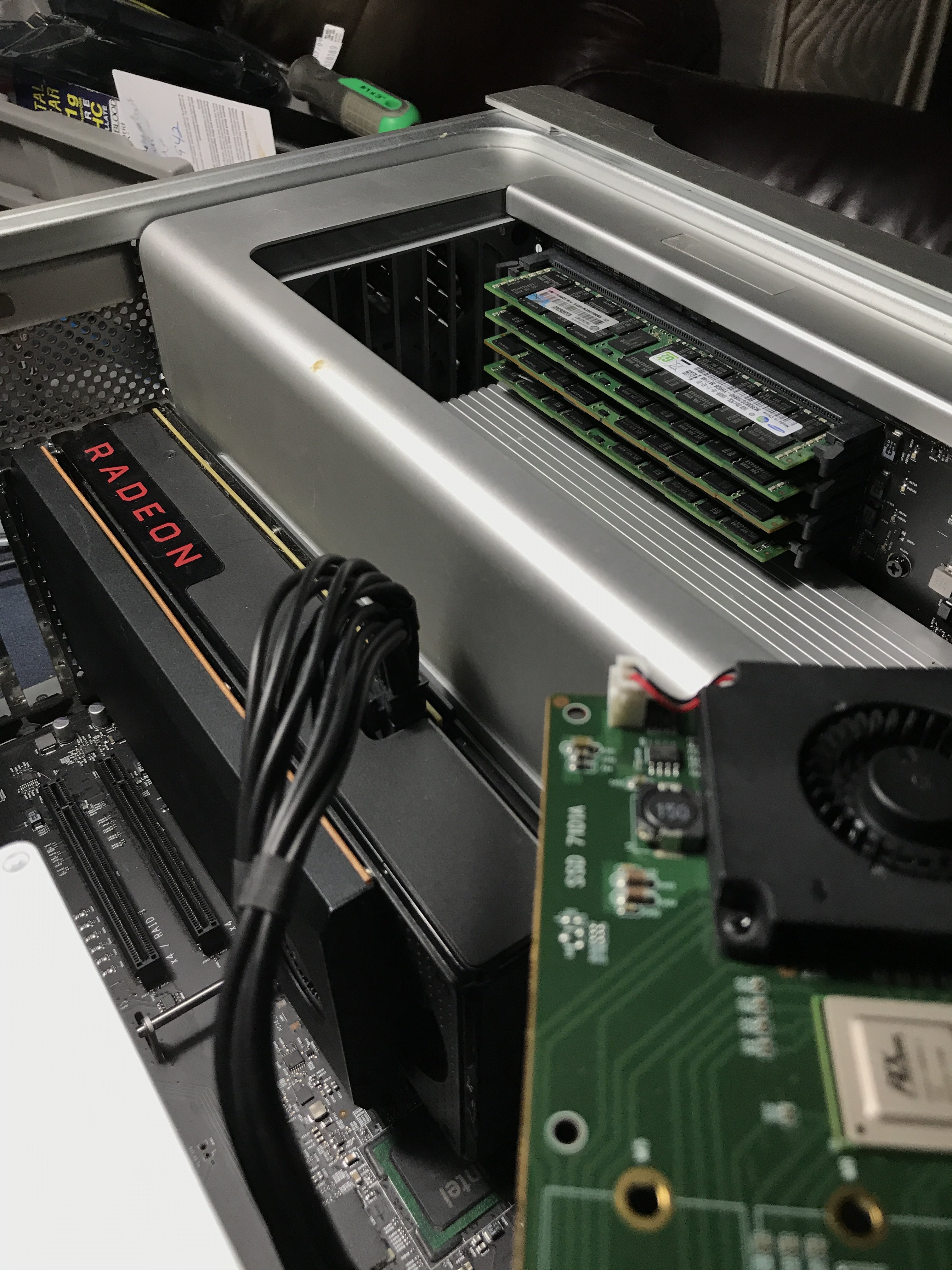

Yeah, looks too tight with that Fat^$$ GPU. I guess I’ll just have to forget about Slot 3.
Of course, it's your own decision. But in my experience, that "half open" fan for this kind of blower cooler is enough to let the whole cooling system to function properly. At least it's true on my 7950 Mac Edition card.
As long as the card in slot 2 won't touch the graphic card's fan, then it is OK.
Especially we can still lower the voltage / clock speed etc to make it run cooler. If we ever consider the WX7100 because of cooling. I will definitely pick this reference RX480 / 580 and run it with the WX7100 setting. From my RX580 VBIOS study thread, it shows a ~50W reduction by using the WX7100 figure to run the Sapphire PULSE RX580 8GB card. Even only half fan is opened, the double slot wide reference cooler will be way more than enough with this low power setting.
But of course, again, that's your decision, if you are not happy with that, no point to go for it. And not everyone happy to mod the VBIOS as well.

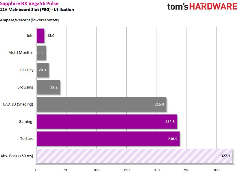

TBH, the numbers from Sapphire looks very strange to me.
The reference RX580:
185W (Max 1340MHz), suggested 500W PSU, single 8pin, dual slot reference cooler
The PULSE RX580:
<225W (Max 1366MHz), suggested 500W PSU, single 8pin, dual slot double 95mm open fan cooler
The Nitro+ RX580
<250W (Max 1430MHz), suggested 500W PSU. 6+8pin, 2.2 slot double 95mm open fan cooler
The reference Vega 56:
210W (Max 1471MHz), suggseted 650W PSU, 8+8pin, dual slot reference cooler
The PULSE Vega 56:
180W (Max 1512MHz), suggested 750W PSU, 8+8pin, 2.5 slots double 95mm open fan cooler
How come the lowest TDP card need biggest PSU?
Why a 180W PULSE Vega card need 8+8pin, but a 225W PULSE Polaris card only has single 8pin?
Why the lowest TDP card has the biggest cooler?
Why the PULSE Vega 56 can draw ~15% less power than the reference card, but can run faster?
For me, the numbers doesn't match. And a quick search got me these. This card is nowhere near 180W TDP but way higher. But still good to see that its cooler can perform well.

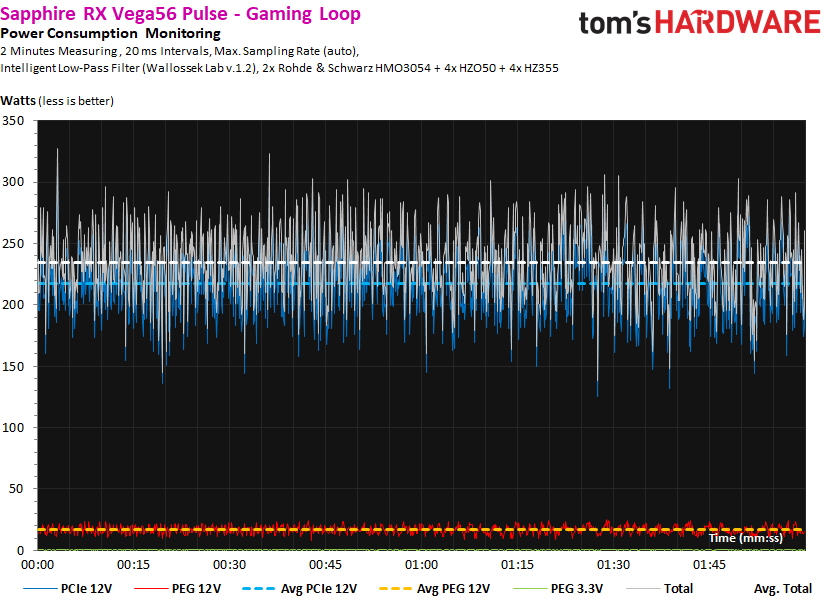

When I run Luxmark in Windows GPU-Z shows the Pulse 56 maxing out at 180W. I don’t know how Tom’s Hardware got the card to consume more (unless they changed stock settings). It’s true the Pulse is faster than reference while consuming less power. Perhaps due to better cooling and higher binned chip. I think Pulse 56 has two 8-pins because it takes so little power from the slot. Dual 6 or single 8 is 150W and it doesn’t pull as much as 30W from the slot so that’s why it needs two 8-pins or at least 8+6 like Red Dragon 56. Sapphire probably also gave it a second 8-pin rather than 6-pin because they know their users like to overclock their cards. The Power Color card is more restrictive in that regard and doesn’t like bios flashes. Pulse is more friendly to mod.
Reactions: h9826790
AMD cards only give readings from the core power use, they do not give any power reading's for any other part of the PCB that uses power ie ram
not the best sorce but i watch overclocking videos by AHCO
https://www.youtube.com/channel/UCrwObTfqv8u1KO7Fgk-FXHQ/videos
nvidia gpu's give power readings for all power going in to the card.
(he explains it as for volt/shunt modding it matters)

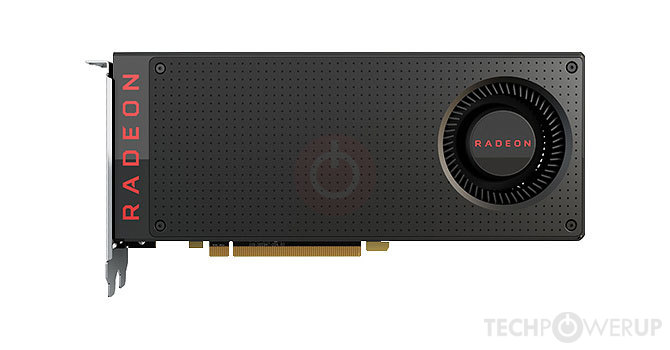

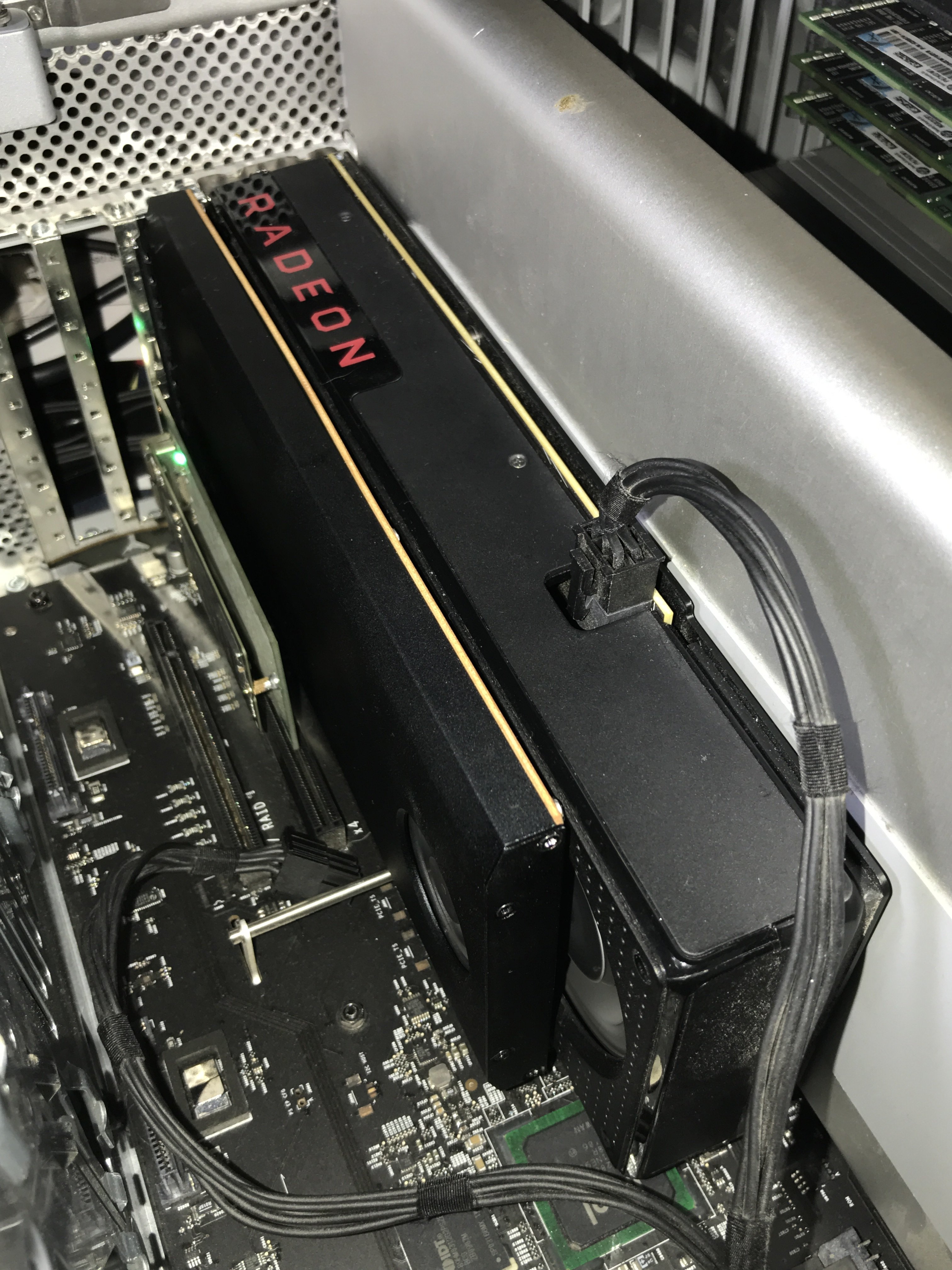

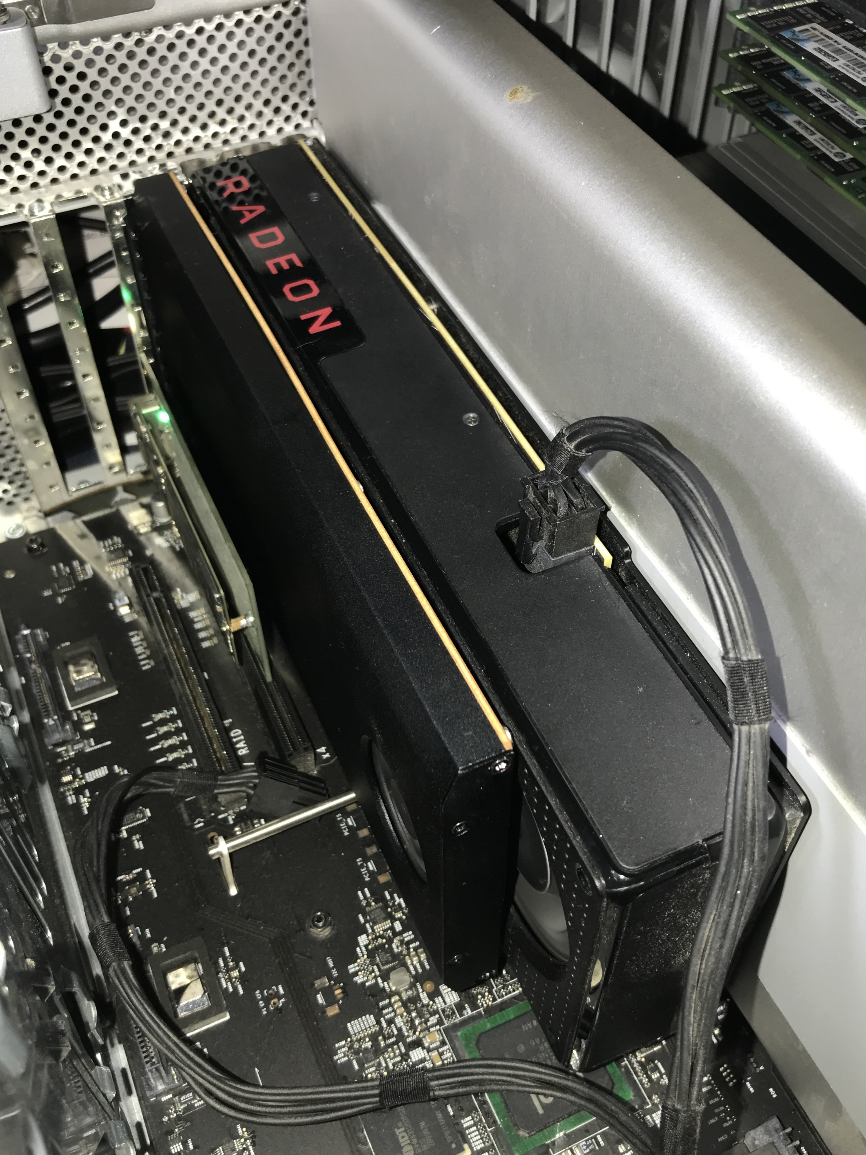

I have this card:
https://www.dell.com/en-us/shop/del...t/apd/490-beet/graphic-video-cards#polaris-pd
In my system it is recognized as RX480:
Radeon RX 480:
Chipset Model: Radeon RX 480
Type: GPU
Bus: PCIe
Slot: Slot-1
PCIe Lane Width: x16
VRAM (Dynamic, Max): 8192 MB
Vendor: AMD (0x1002)
Device ID: 0x67df
Revision ID: 0x00c7
Metal: Supported, feature set macOS GPUFamily1 v3
Displays:
SyncMaster:
Resolution: 1280 x 1024 (SXGA - Super eXtended Graphics Array)
UI Looks like: 1280 x 1024 @ 60 Hz
Framebuffer Depth: 24-Bit Color (ARGB8888)
Display Serial Number: HMEY510402
Main Display: Yes
Mirror: Off
Online: Yes
Rotation: Supported
Automatically Adjust Brightness: No
I did not upgrade the firmware yet so it is shown as 2.5 GT/s :
Radeon RX 480:
Type: Display Controller
Driver Installed: Yes
MSI: Yes
Bus: PCI
Slot: Slot-1
Vendor ID: 0x1002
Device ID: 0x67df
Subsystem Vendor ID: 0x1028
Subsystem ID: 0x1701
Revision ID: 0x00c7
Link Width: x16
Link Speed: 2.5 GT/s
The reason I selected this card is because it only occupies 1 slot and has a 6 pin connector only. it is really a Pollaris 10 card running with clock speeds of 1266 which makes it an overclocked RX480:
https://www.techpowerup.com/vgabios/184327/amd-rx480-8192-160603
Known issues:
There is no temperature recognition in the apple firmware (at least in high sierra) so I have to use MACS FAN CONTROL to bump the fans up so the system does not overheat. My next step is to update to BootROM 138.0.0.0.0 to enable the 5 GT/s speeds and HDMI audio.

The card that you linked to isn’t a single slot card, it’s a double. Electrically it connects to 1 PCIe Slot, but physically it occupies a 2 Slot space.
Perhaps you linked a different card than what you intended.

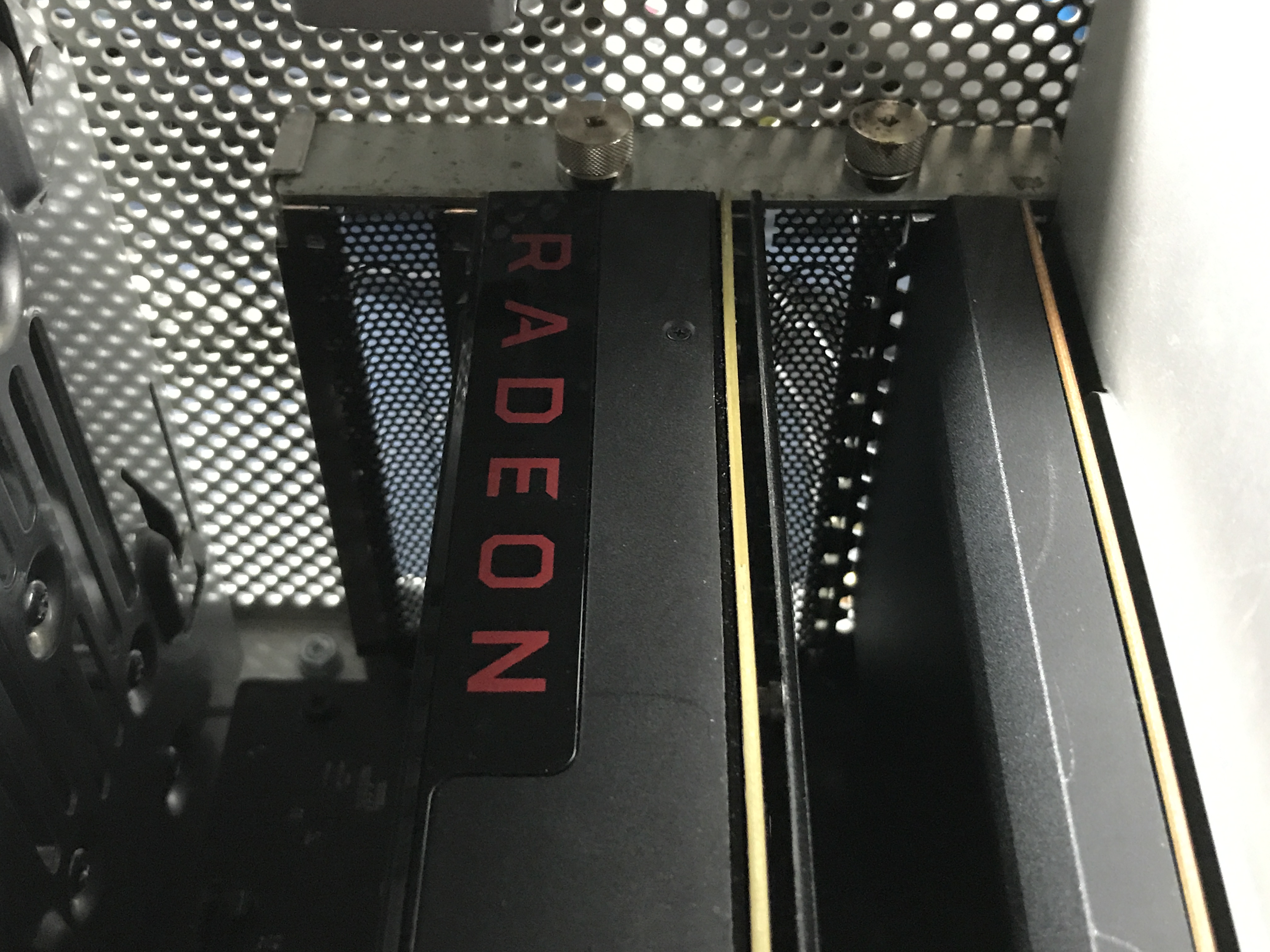

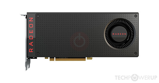

My mistake. it is a 2 slot. Long story short I had RX580 Sapphire, but it occupied 2.5 slots (effectively 3) and it had 6 and 6+2 power connectors so I returned it and replaced it with this DELL AMD 480RX on steroids (branded by DELL as RX580 because it "falls within the OEM specifications for an RX580 card" as per dell own words. Funny how they can go away with such a low level marketing scam. It only cost me 250 bucks on craigslist.
Many current RX 580 cards (including the Sapphire PULSE RX 580 8GB) are above the "standard" 2 slot height and easily encroach on the slot above.
See this thread for my fix to continue using Slot #2 when using an RX 580. Removing two backplate screws and thermal pads "fixed" the issue. Hoping NVIDIA releases Mojave compatible Web Drivers and can stick with GTX 1080 FE.
https://forums.macrumors.com/thread...580-8gb-spacer-wedge-for-pcie-slot-2.2134562/

A card which is using Ellesmere (Polaris 10) and has only 6 pins is definitely not an RX580 with Polaris 20 with 6+8 pin.
RX 580 ref = 185W.
RX 580 factory OC = 225+
PCI-I = 75W
8pin = 150W
6pin = 75W

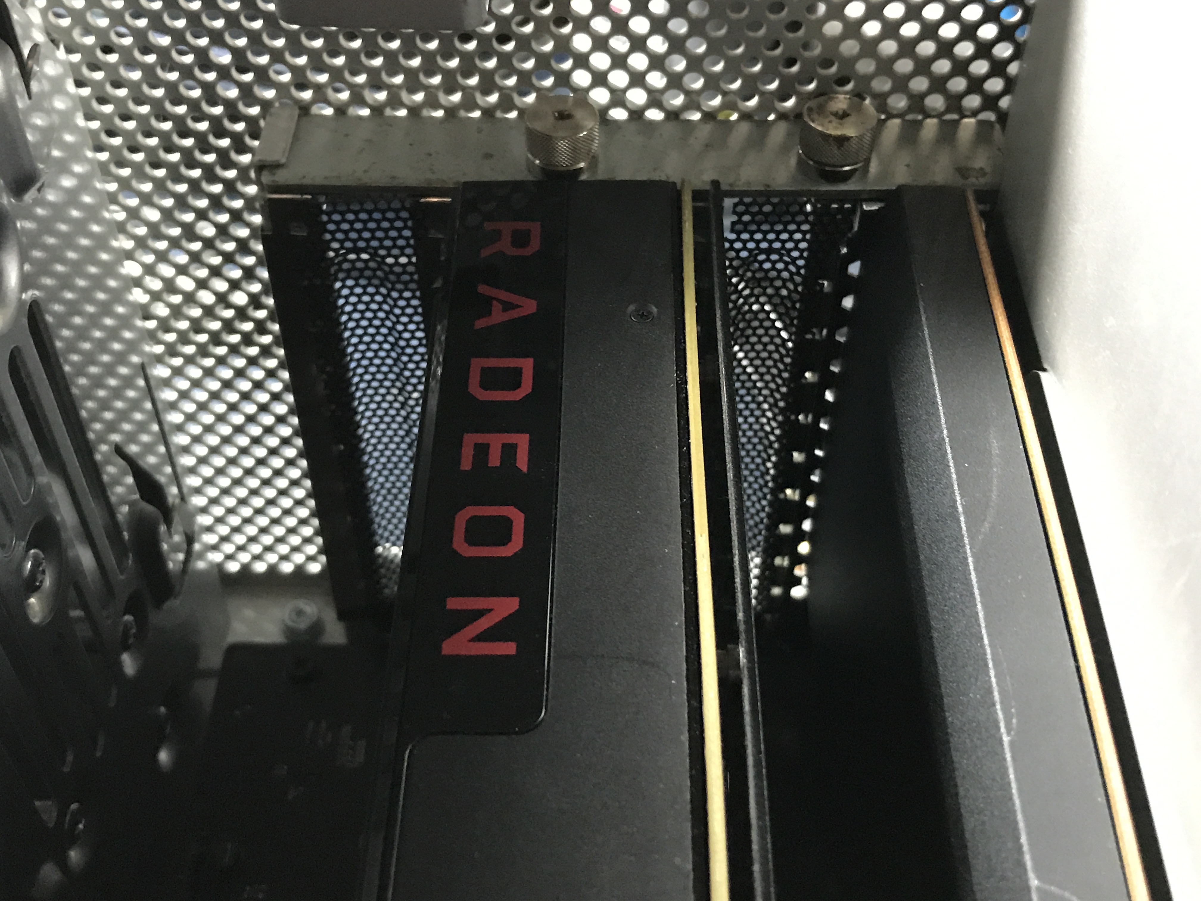

I prefer the 2 slot card, because anything I put on the top of a 2,5 slot card will block the fan/s and airflow plus the exhaust heat will go straight to the next card on the PCIE slot. That is why I don't need a real RX580, which occupies 2,5 slots. To properly power lets say a card with an 8+6 pin connector you have to draw equal power from both 6 pin connectors on your mac and distribute it properly. I actually bougth a cable splitter from 2 mini 6 pins joined to a single 6 mini pin. You will need another splitter from a single 6 mini pin to the 8+6 pin connector. The 2- 6 mini pin connectors can supply 150W each, but you should not draw unbalanced power from the pins to avoid system shutdowns at peak loads. Of course you can tap straight into the power supply cables, but it requires some rewiring and cable damage.
Reactions: skeptech
Just to clarify for anyone who follows this thread later, the Sapphire Pulse RX 580 8GB is powered via single 8-pin, easily achieved via dual mini 6-pin to standard 8-pin cable.
The Sapphire Pulse RX 580 is Apple’s recommended card and please do not confuse newcomers about the power requirements. No 8+6 is required with this card. Your RX 580 variation may be different but that version was not recommended by Apple.
Have posted links several times in the past to the cable I’m using, as have others.
Also posted links about the FIX being used to easily let the 2.25/2.5 slot height work within the Mac Pro tower and still use slot 2 without major issues. It is not ideal and not as great as GTX 1080 FE, but it works and (again) it's Apple’s recommended card. For under $250, officially recommended, easily powered, and works with Mojave, it’s very difficult to recommend anything else.
